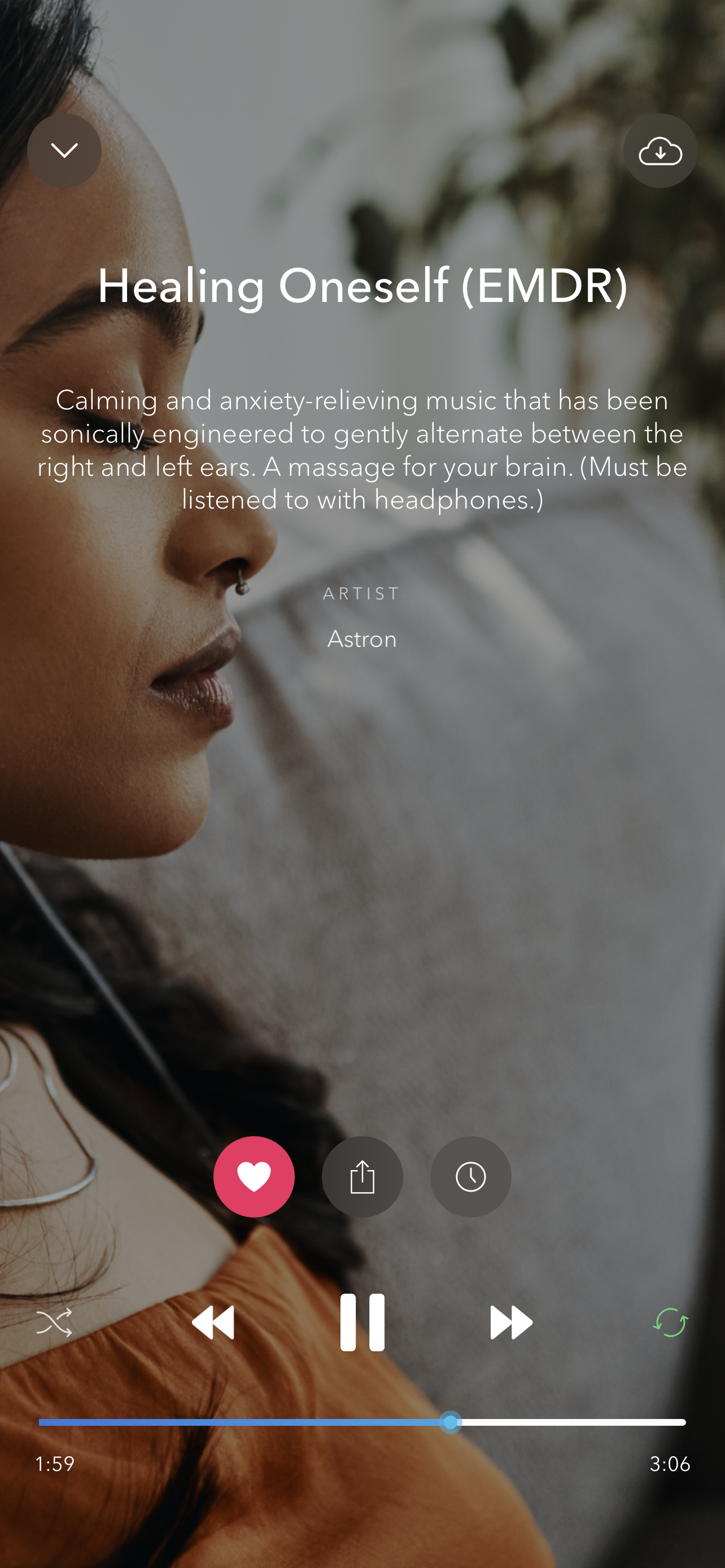

Just listening to the Calm app unwinding at the end of the day, usually use the H95’s but battery was low so resorted to using the E8 3.0’s instead… can’t beat the clarity of B&O headphones
