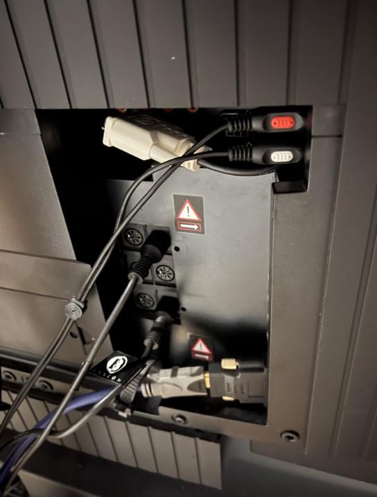

    in reply to: Beovision 7-32 HD connections #61193
    ethuijs
    I have connected the audio to the chinch connections at the top right.
    BV-7-32 audio in 2024-11-27 221237
