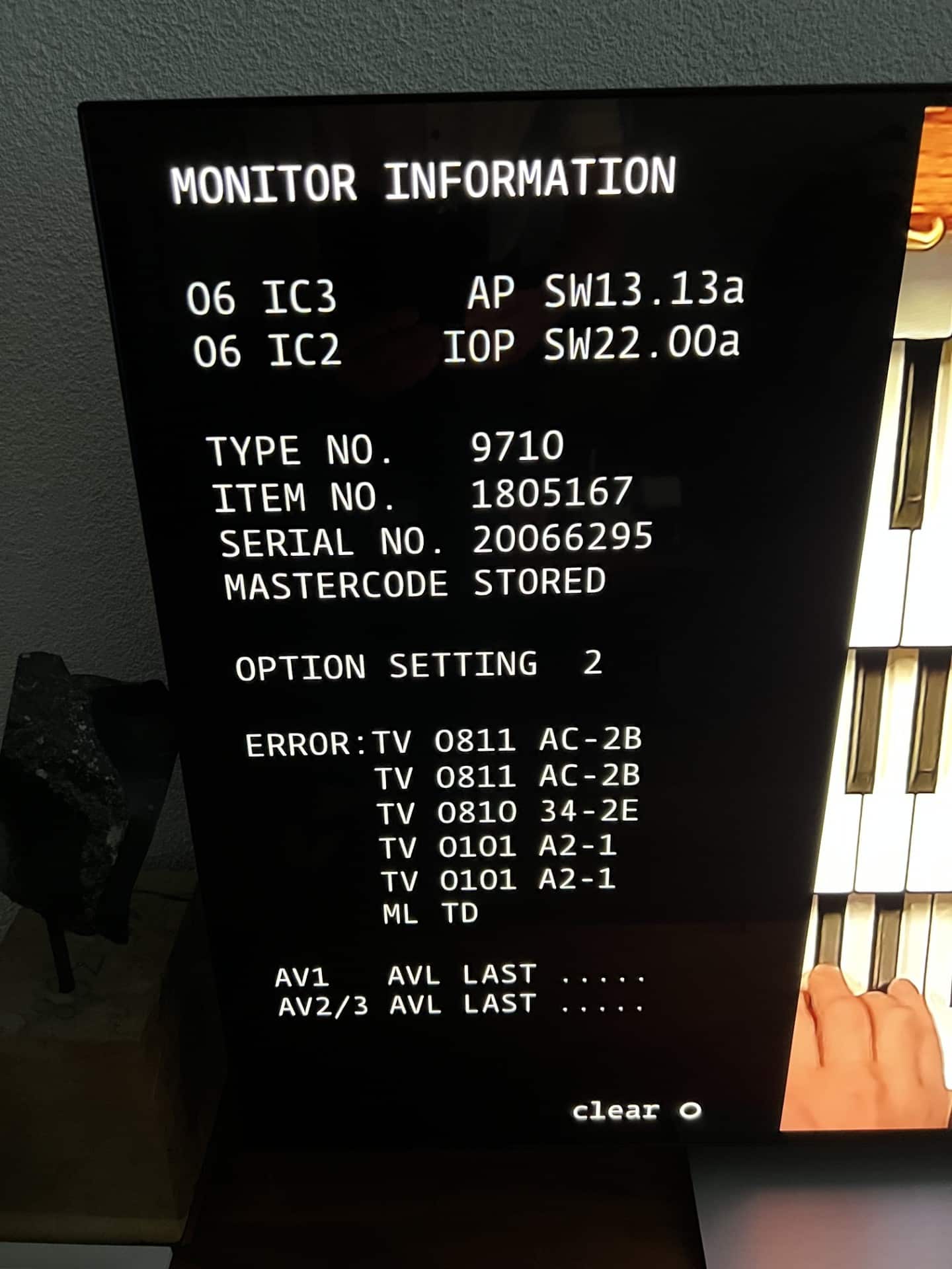

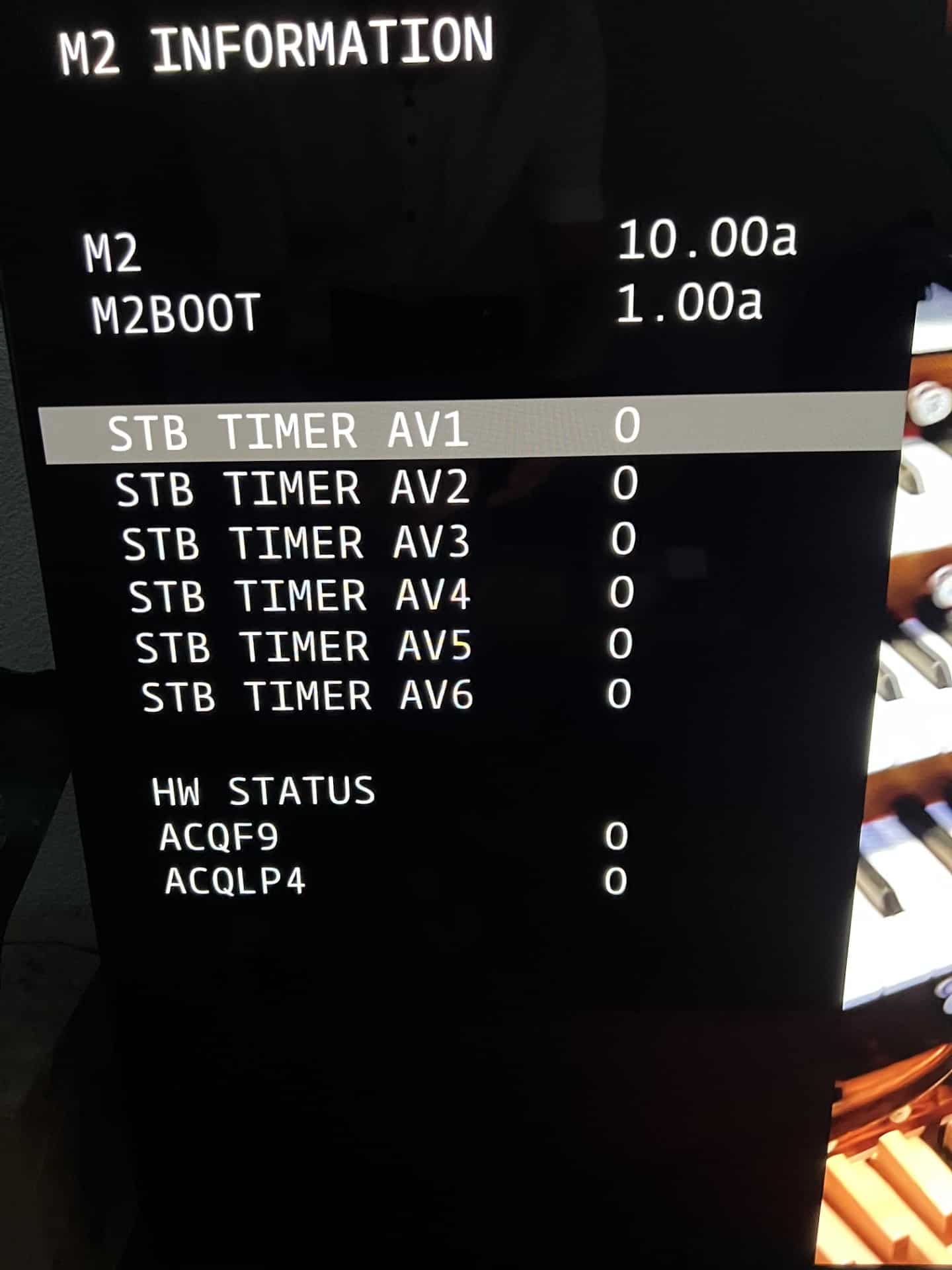

    I have a Beosystem 3 from a Beovision 9 type 9600 item 8150010. I got it partly working with my new LG G9 only the digital sound is still a problem.
    Is there a way to reset the BS3 to clear the monitor information from the BV9. Under display connection 1 (DVI 1) it sees that an LG monitor is connected.
    The Reset when going to the system menu with Menu 0 0 Go dit not clear monitor information. Selecting Configuration stays empty.

    Thanks Johan, I checked that the Customer Service Menu but very little can be changed there. Monitor is on auto detect and sees there is an LG monitor. Not the type of course because its far to new. Project states BV9 but that is just a name I guees. This evening I will try the right Dolby settings on the LG and BS3 to see if I can get the digital audio working so that I can see 4K also and not only full HD. All video sources ar now conneceted to the BS3.
    Kind regards, Edwin
