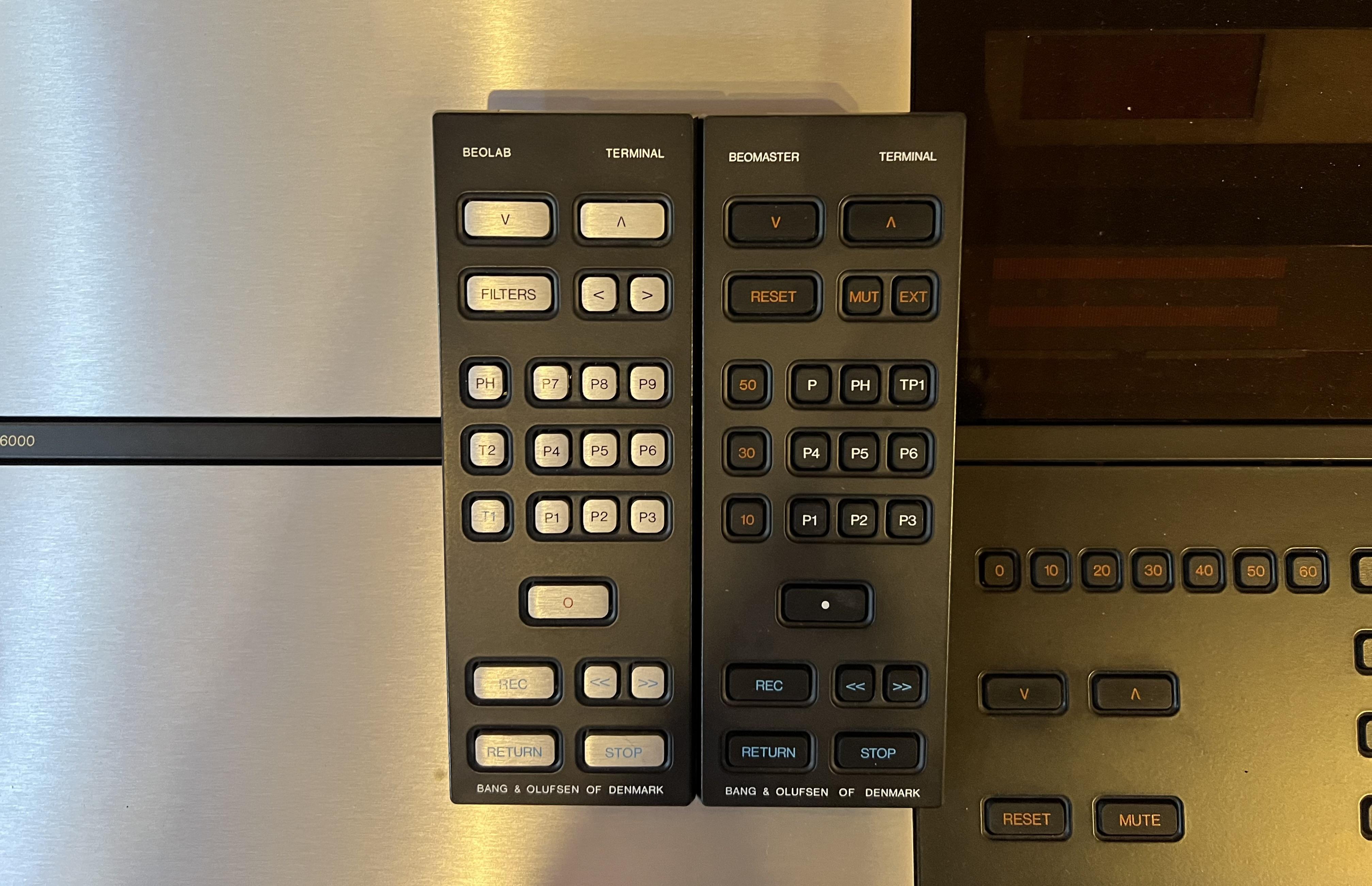

BRONZE MemberHi,
Or the Terminal 8000, of course. But no stepped volume drops or reset! But it does work fine.

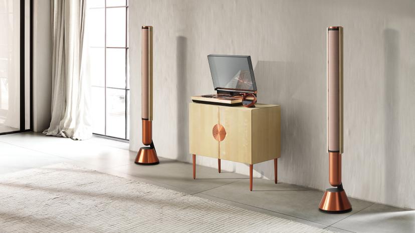

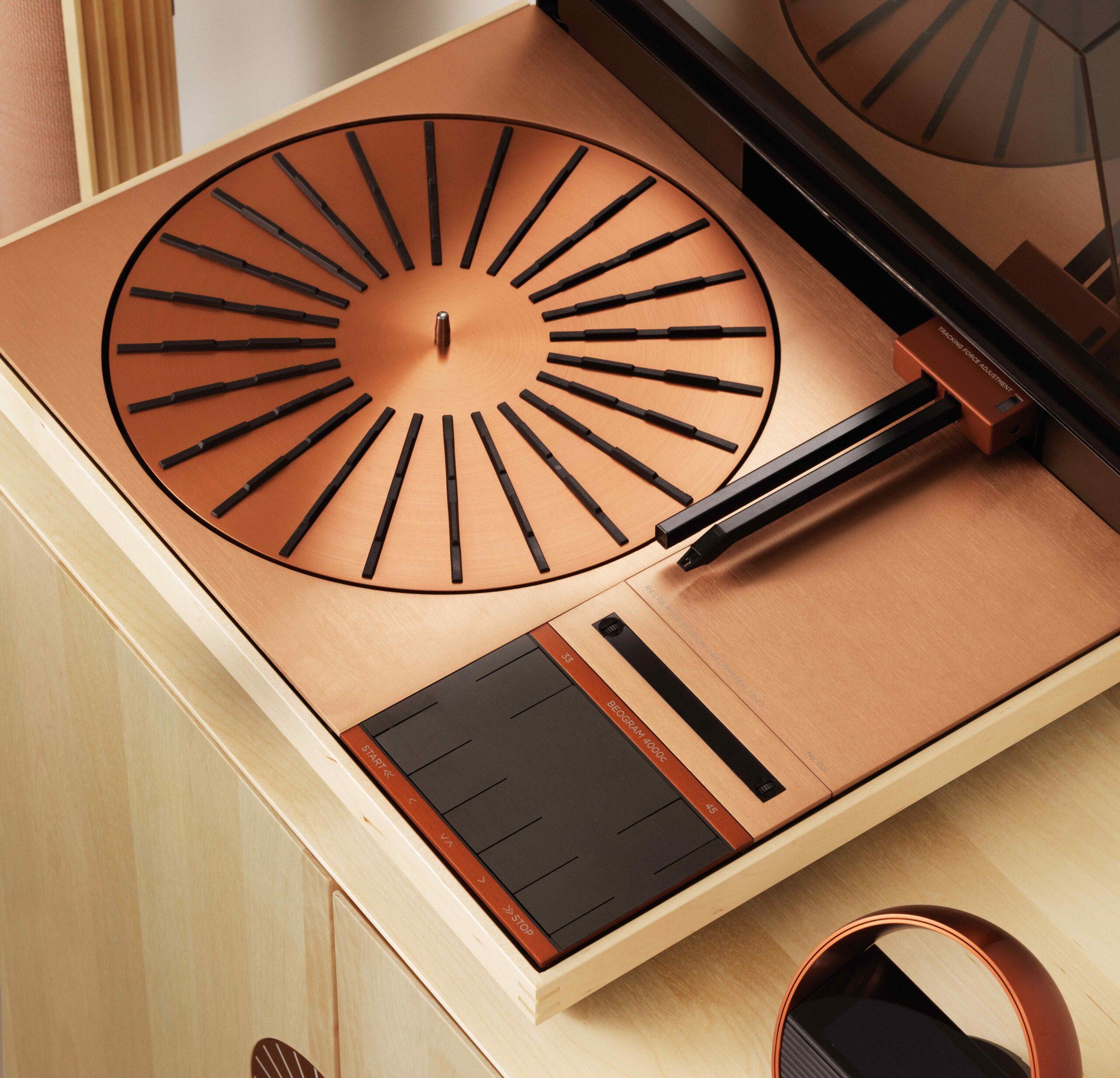

BRONZE MemberSo I ‘guessed’ right Steve.
A little disappointed they didn’t do a real Beogram 4000 this time though. I’ll forever stick to mine.
