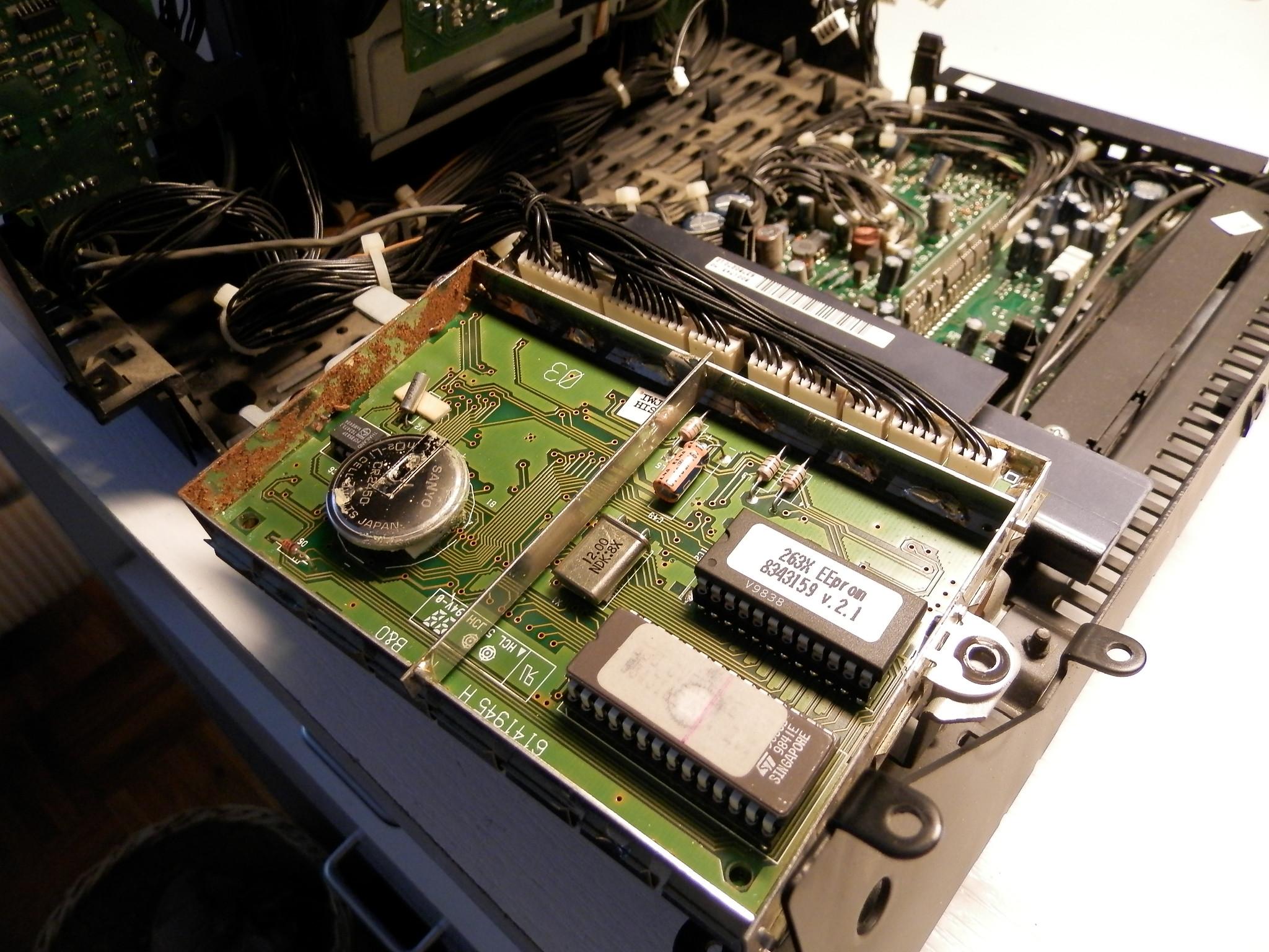

    in reply to: Ouverture fm tuning problem #52262
    Die_Bogener
    This mismatch can happen when the lithium backup cell is almost dead.
    The lifetime is around 20-25 years… the more in use the longer and betterP5100023.
    Replace it, it’s a quite normal 3,3V CR2450 cell. Open the cpu and measure. Less than 3,0V means problems in the next time…
    And when you find corrosion… too long waiting, this is lost acid with lithium. Clean it, but beware… lithium is really dangerous with water and very explosive during soldering. This is NO FUN!

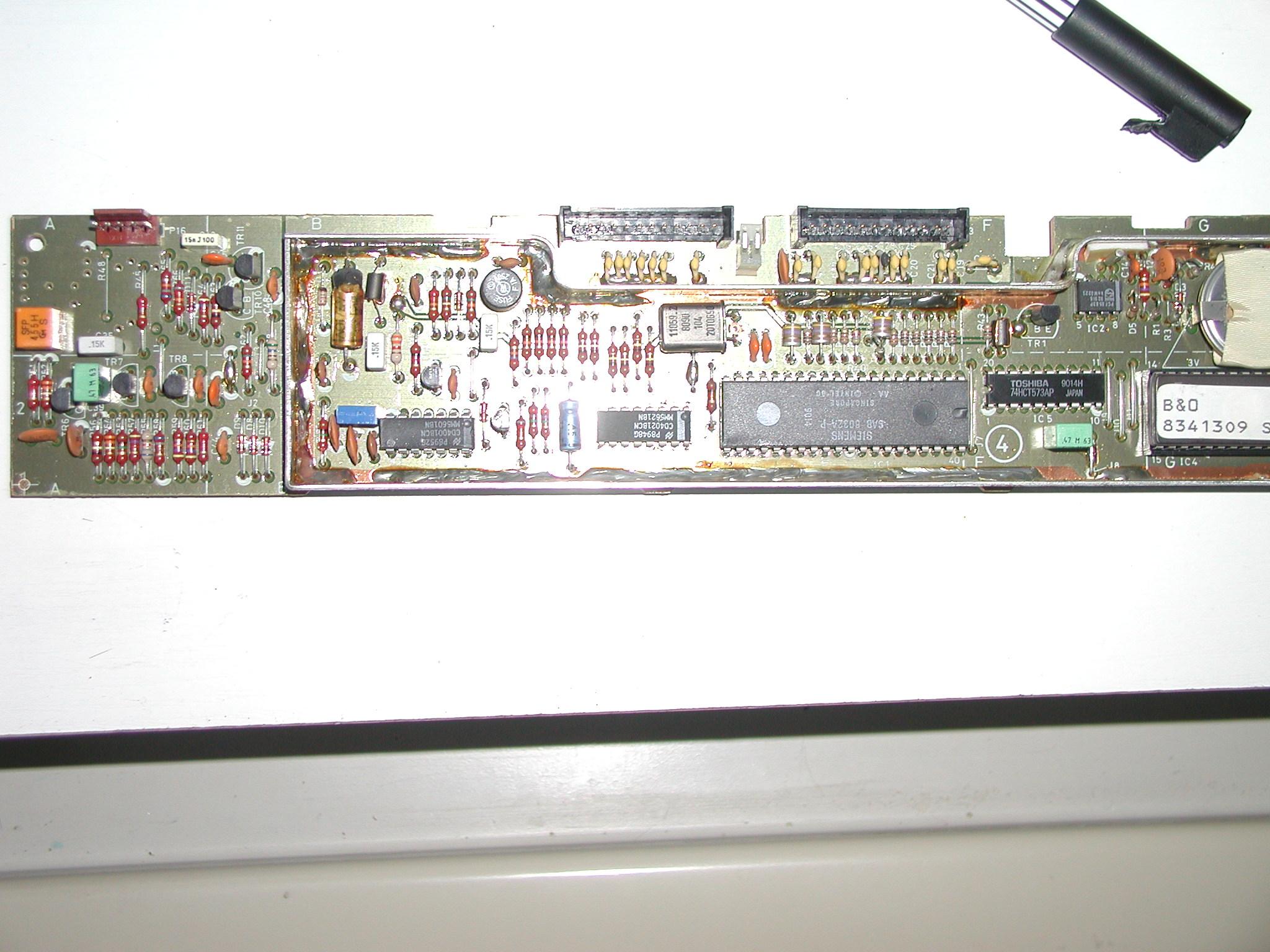

    in reply to: Beovision MX4000 – stuck in standby #40934
    Die_Bogener
    In total? The complete TV is around 200…
    This here is just the mainboard of a MX4000/6000. All of them is a job… just for switching it from red to green.
    P2210011
    Die_Bogener
    The copper traces of the BL8000 pcb are very thin. Acid of the foam does it’s job.
    And when there are already a lot of “by-pass” repairs… ok, you will need some more.
    There is not only the amplifier. There is also a round board in the foot with the LED. This board gets all the acid and debris of the foam…  and is always forgotten…
