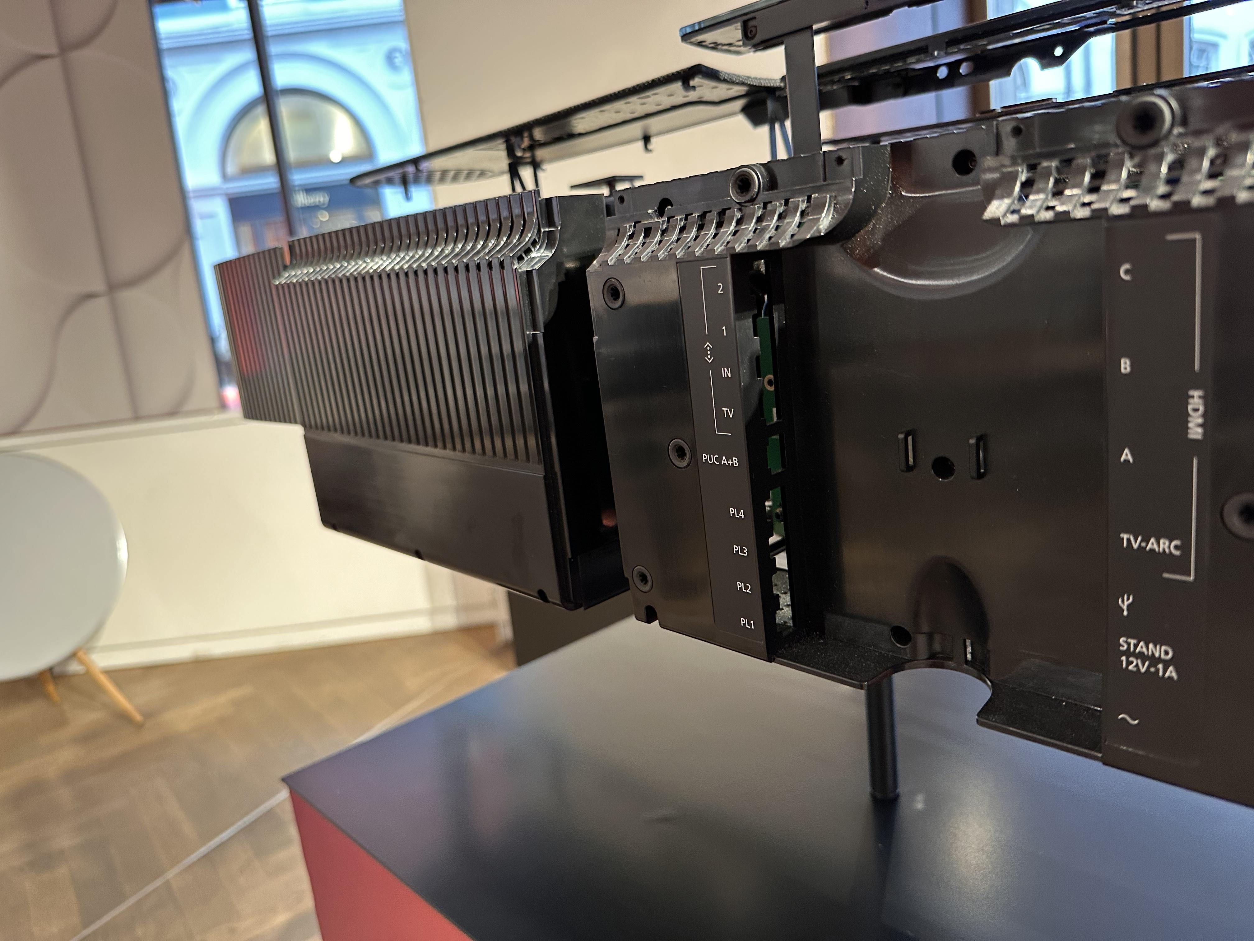

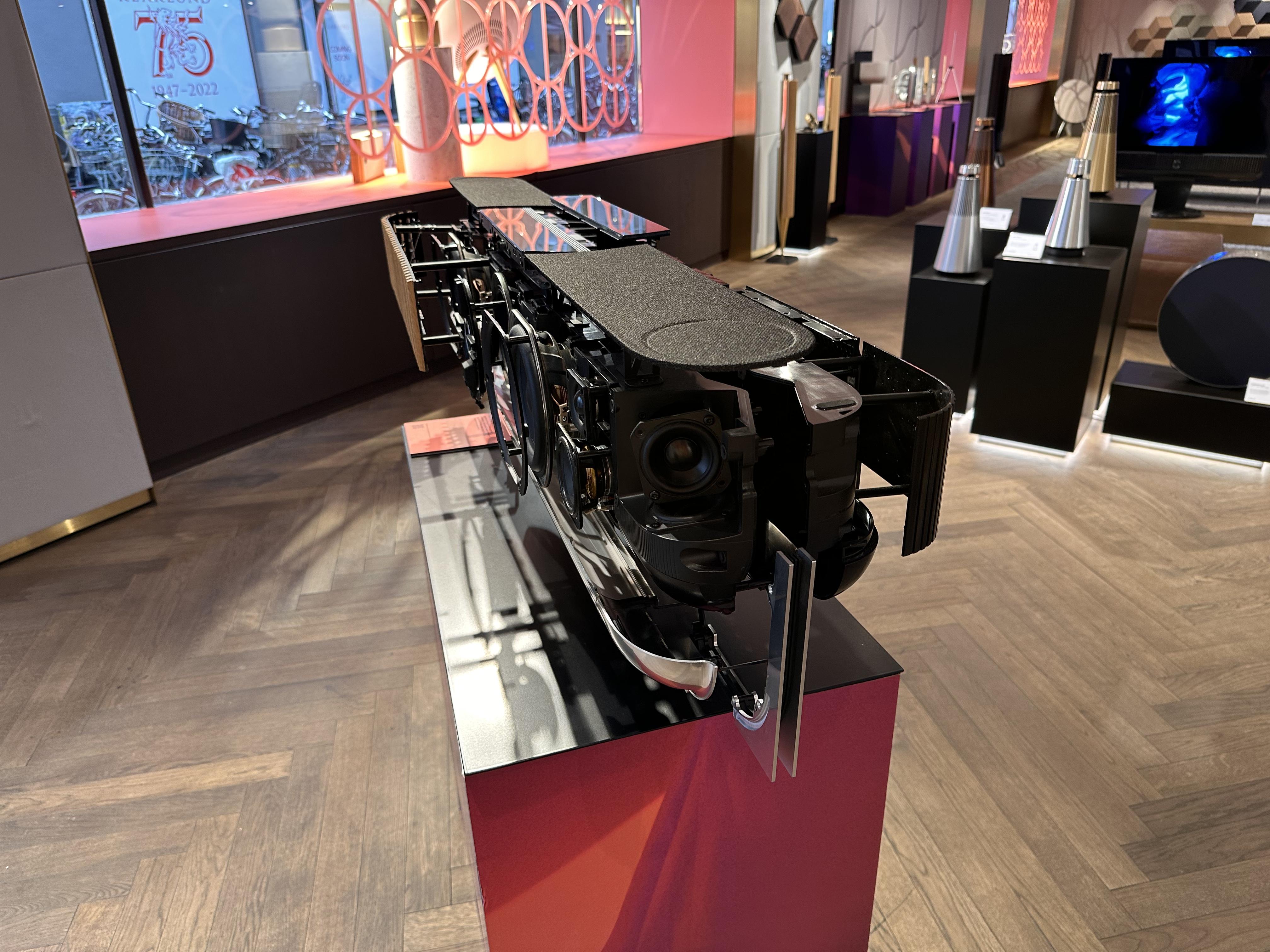

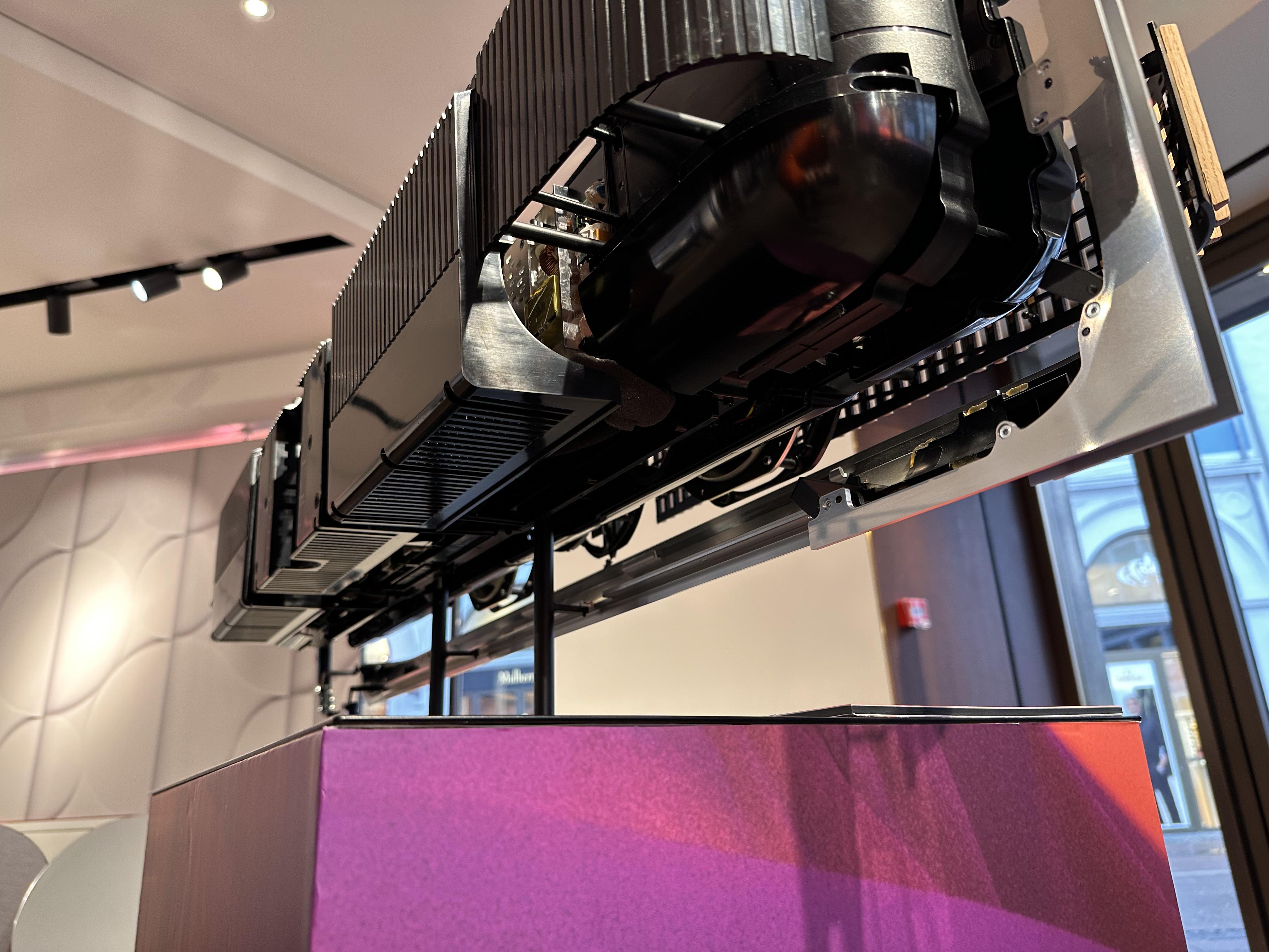

    The flagship store in Copenhagen has a lot of BSTH bits on display.
    44019229-47F8-4A6D-B138-4B9B91C505D619C3E81D-752A-4ECE-B240-D127EDC43D96DEEB0EA6-A405-496C-9B73-B3D1881EC86F31C689FB-437D-4988-BF9E-0EA006DE1A8D0DFDA271-3157-44F3-98A5-44AD0D4CCA7A009FDCAD-395C-434E-A4D4-DB63C5B3014792333CA0-1AC0-4CC2-B00A-18547BE52AE013E4790D-51AE-41B4-9173-539C5565014C
