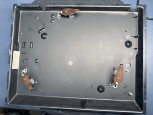

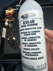

    Another day, another upgrade.  This time I’m taking a Beogram 3000 and upgrading it to Beogram 4500 specification.  I got this unit because I thought it would fit in stylistically better with the black 7000 series that I have. My first thought was to simply replace the 5500 shell with the 3000 shell, but I decided to leave well enough alone – the 5500 had the latest motherboard with the discrete standby function, which the 3000/4500 could not  make use of, because it lacks a front face.
    I started with the chassis.  Some new feet and touch-up paint to cover up the deep scratches.
    I’m using graphite-infused black paint, in order to keep all areas of the base conductive.  It’s not a perfect match, but IMHO better than exposed bare metal. My hope was to eventually use this conductive paint as a new semi-black coating for the platter, but that will be a bit later when I’ve experimented a bit with it.
