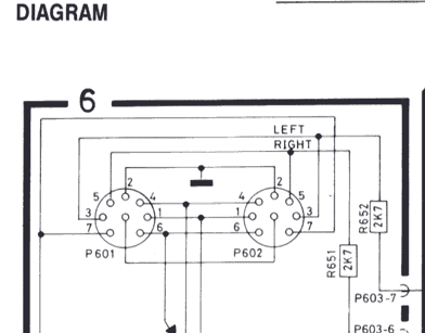

    TP2/AUX pins 1 & 3 are line-level, from what I know.  Those pins are directly connected to the 5500 line-out L&R pre-volume control, so the RCA outputs would be another place to hookup if need be.  I’d probably prefer to just use the Din-7 plug for minimal # of connections (2, at this point: TP2/AUX, and SENSOR), unless there’s a stumbling block I hadn’t considered.
    A cursory look at the schematic indicates that SENSOR also carries a DL86 bus, so that’s another connection option.  It also might make sense to have a SENSOR pass-thru on the dongle, so all function is retained.  I wonder if I can just power off of this plug? There’s no dedicated ground pin – only the casing – so that’s something to consider.

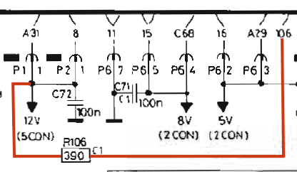

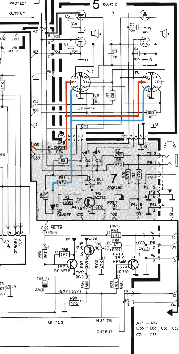

    Just for kicks, I spent an hour today tracing some of the signals for Pin 1 (PL On/Off) and Pin 4 (Speaker Relay).  Pin 1 piggybacks off a pre-existing +12v power-on and a 390 ohm resistor. Pin 4 connects to the SP On/Off logic via a 470 ohm resistor.  I’m still thinking that I could use the 5500 Sensor Pin 1 (which has a 470 ohm resistor) as the input for Powerlink pin 1, as the voltage drop difference between the two resistor values is probably negligible. I don’t think there is an externally accessible speaker on/off relay available via an external pin, so that is still a work in progress.
    [EDIT] Just thinking this morning that the sensor 12V output may not be switched with power up, as it also needs to power sensor circuitry. I should do a bit of testing.
