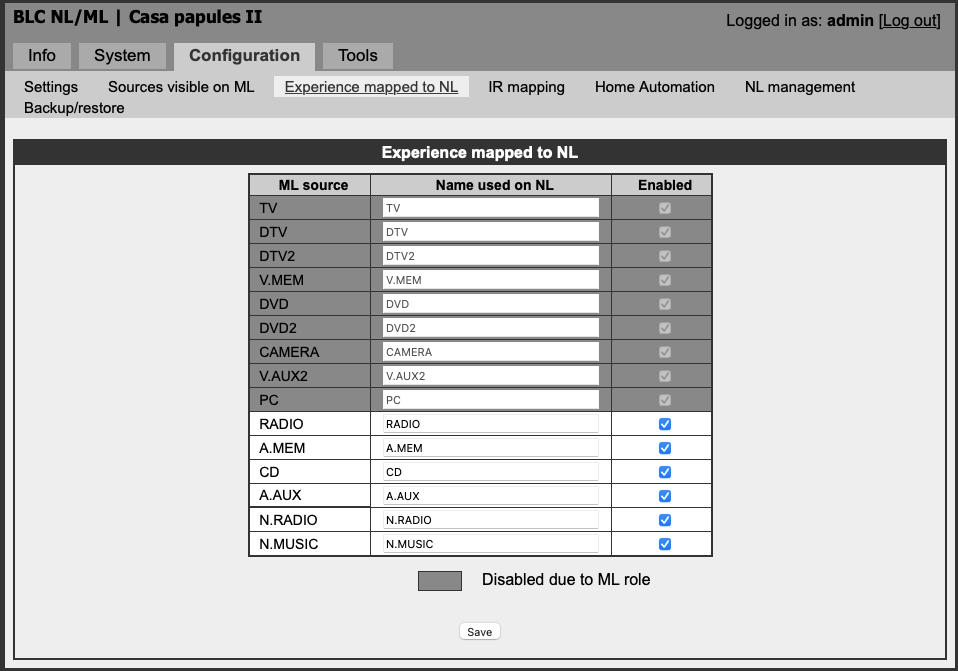

    in reply to: Beolink Converter NL/ML #40534
    Frog
    GOLD Member
    Yes, that was it. I unchecked all the experience mapped to NL items in the second BLC – as there aren’t any – and it found the correct devices!
    thanks again.

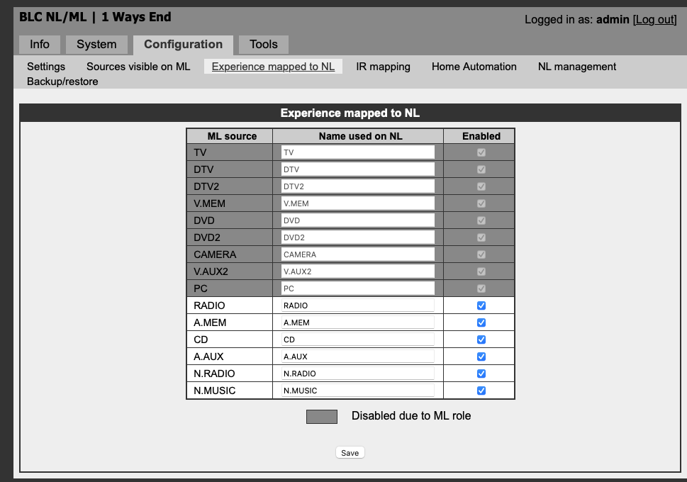

    in reply to: Beolink Converter NL/ML #40532
    Frog
    GOLD Member
    And here are my ..experiences mapped to NL pages
    By the way, Thanks! I appreciate the help – and have connected an IR Eye up to the second BLC as you suggested.
    in reply to: Beolink Converter NL/ML #40531
    Frog
    GOLD Member
    That was it! The bonus is that an old MCL2P that I bought 28 years ago also works in this setup – so I’ll be using that as the amplifier.
    With regard to the sources, here is my setup; the original BLC is called 1 Ways End and the new one is called Casa papules II.
