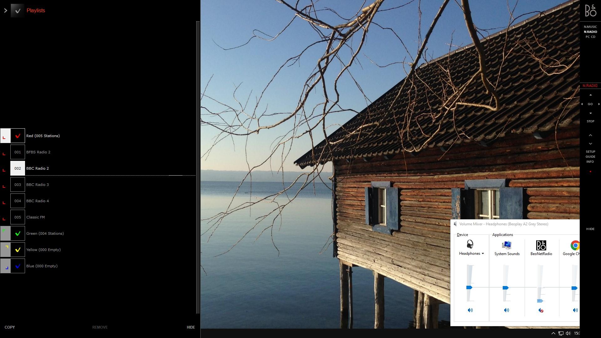

Have you checked that windows/beoport muting problem mentioned in the other Beoport thread? Basically every time you change station the BeoNetRadio level is Muted in the volume mixer – I have to go to the volume mixer and unmute each time I change radio station. See below (you can just see the red mute symbol – click the photo to enlarge):
