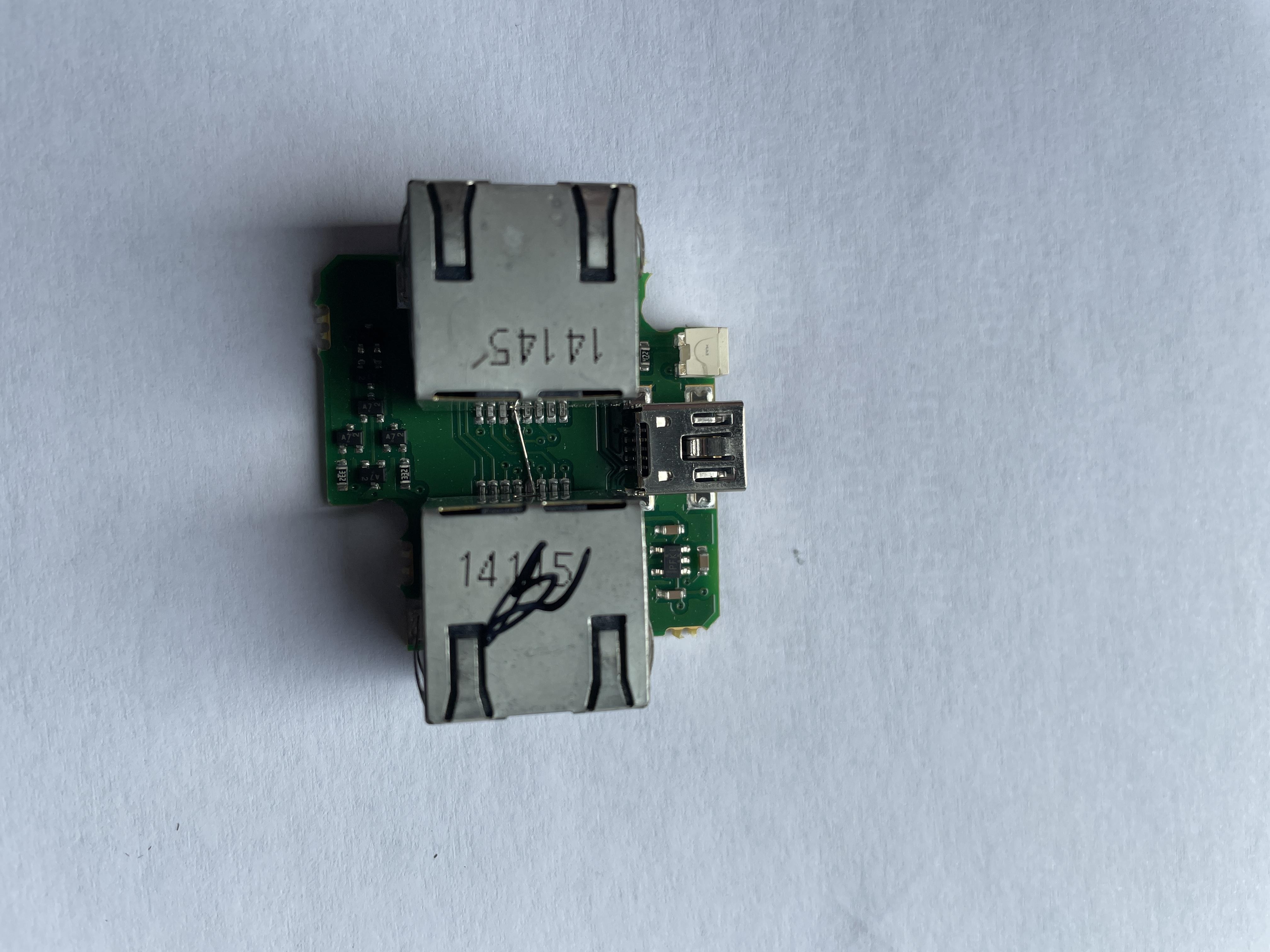

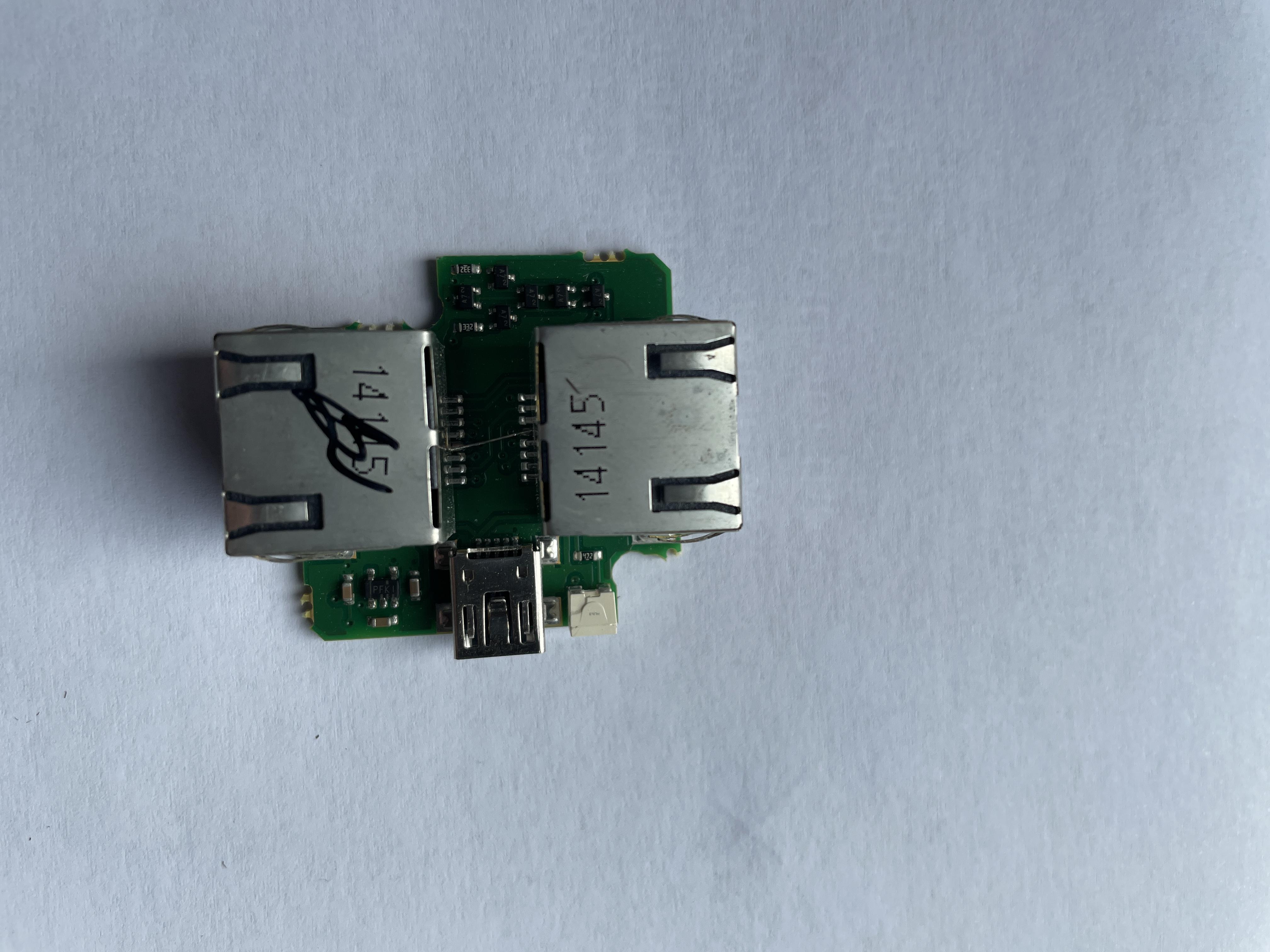

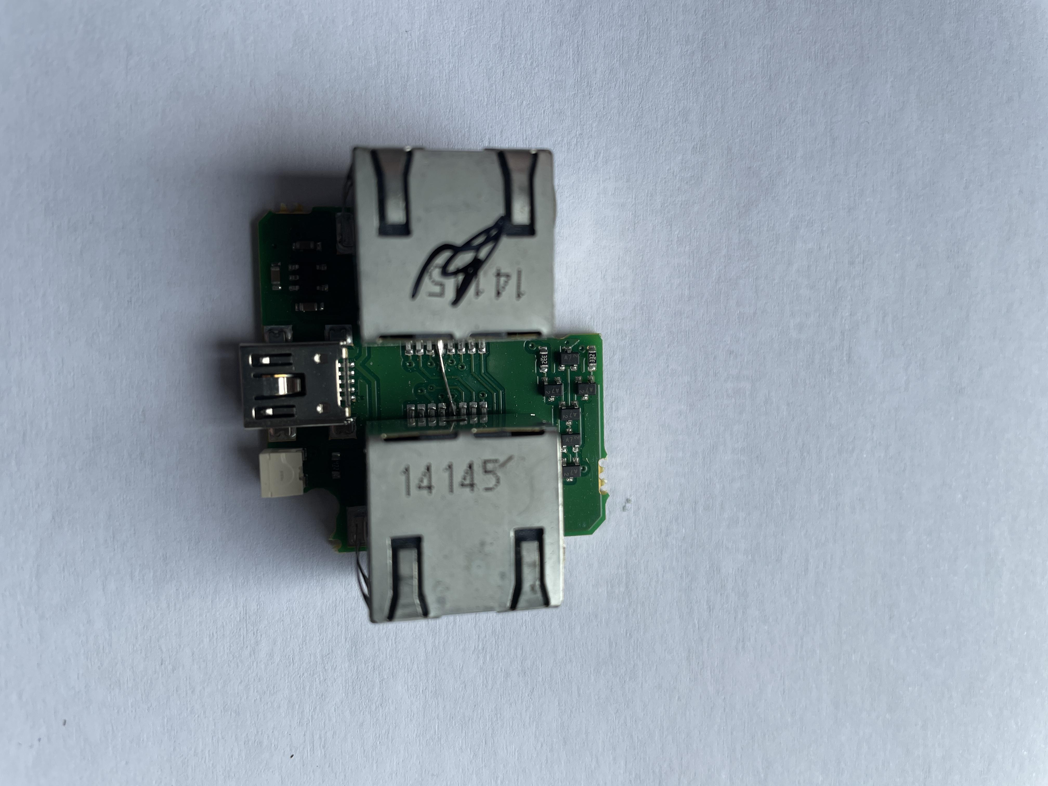

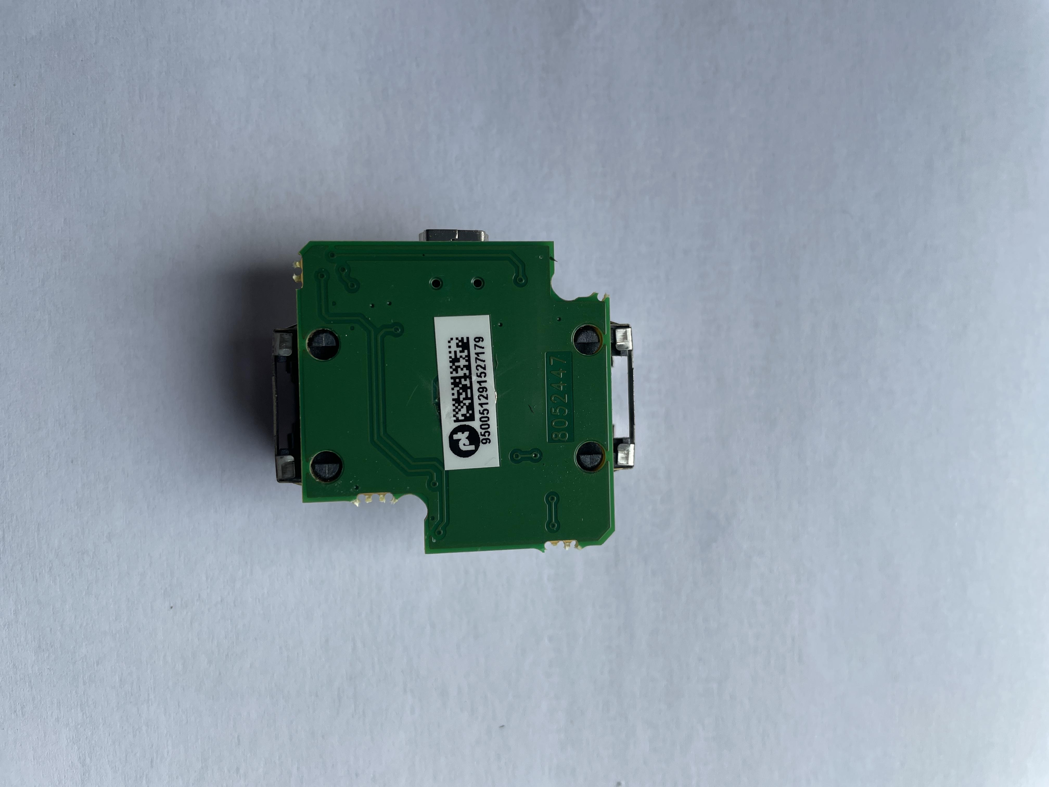

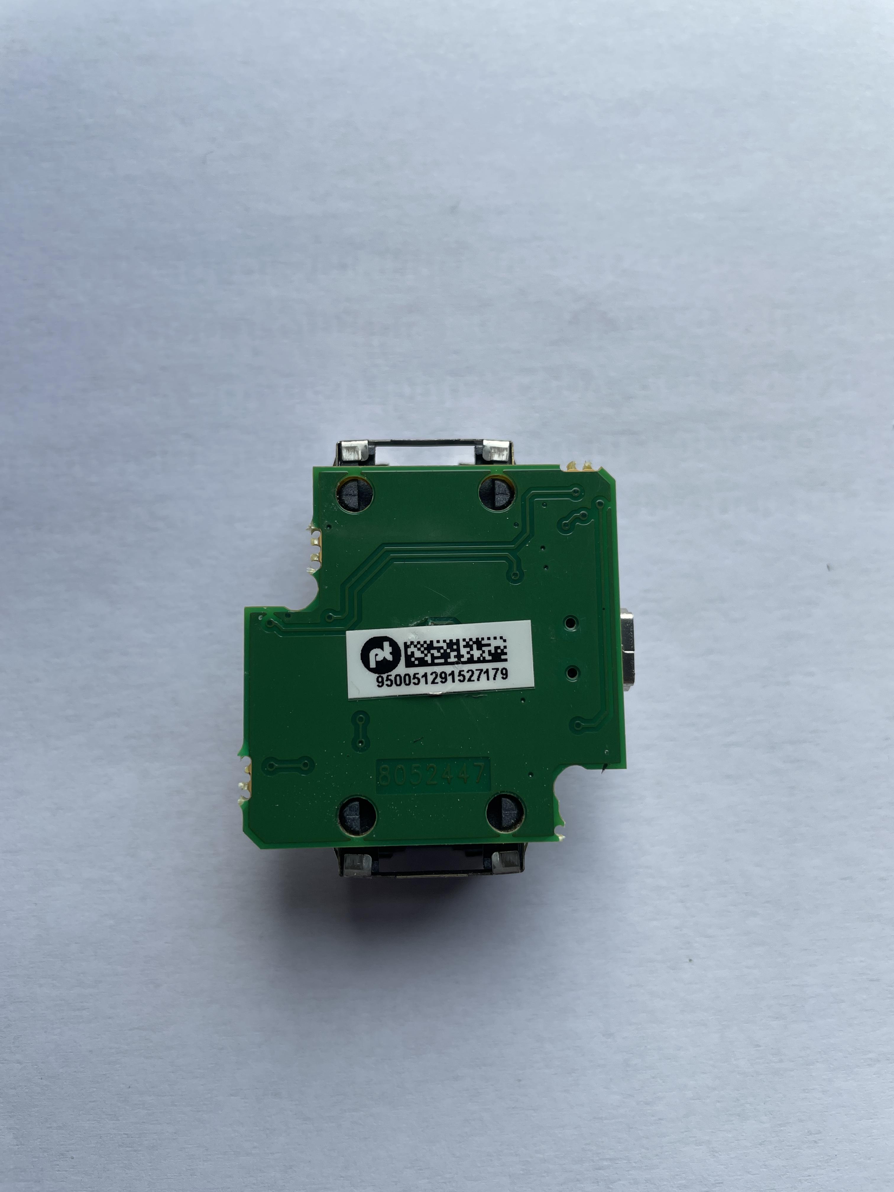

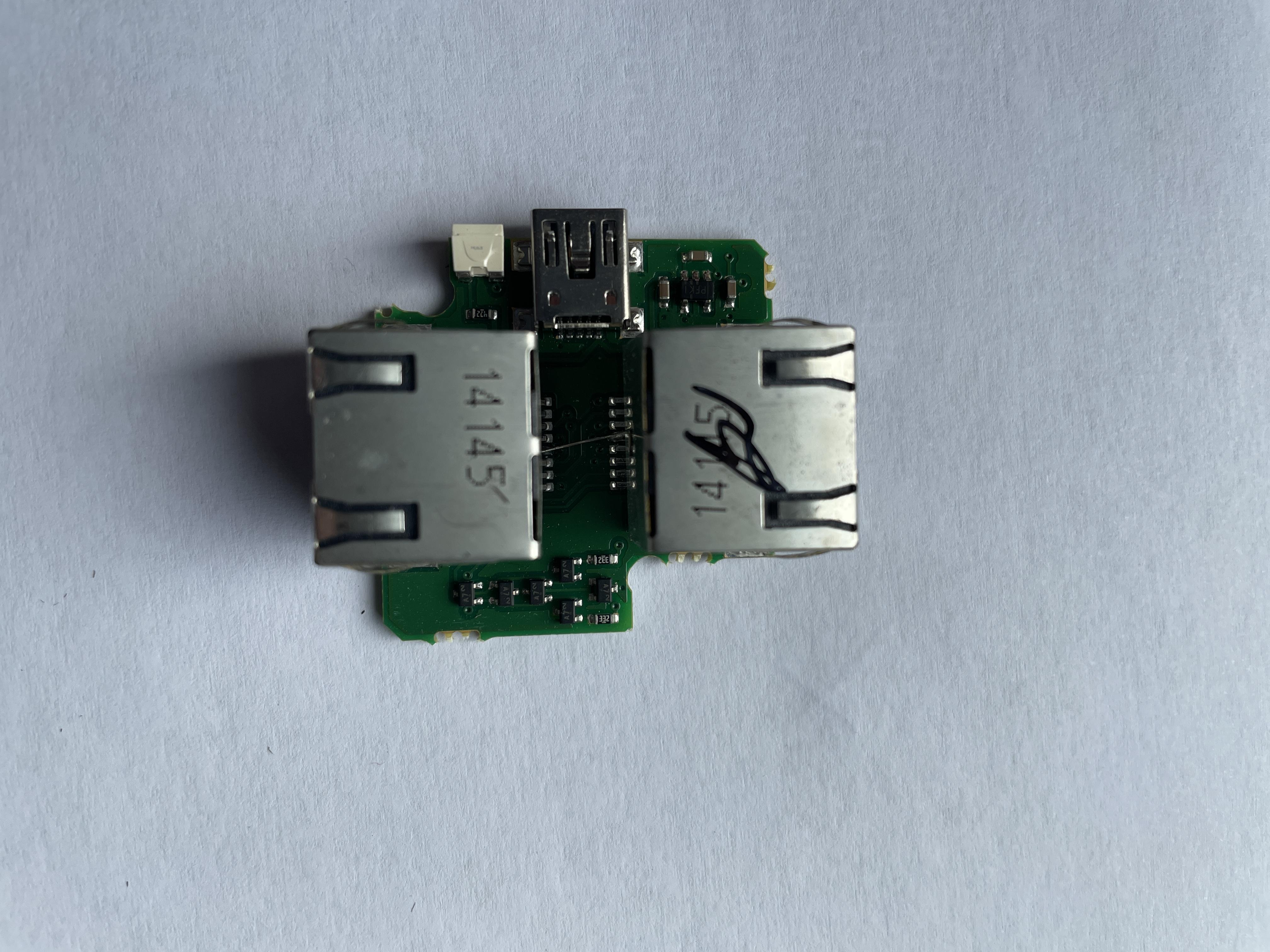

    Hi Michael, hi Yann, I happen to have the V2 too. Maybe useful?
    I cannot tell what the red wire is.
    Good luck!

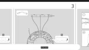

    Hello Beostoked, the servicemanual is issued for both 40&46 and there is only one ‘interface bracket’ that I called spider:
    No worries there!
