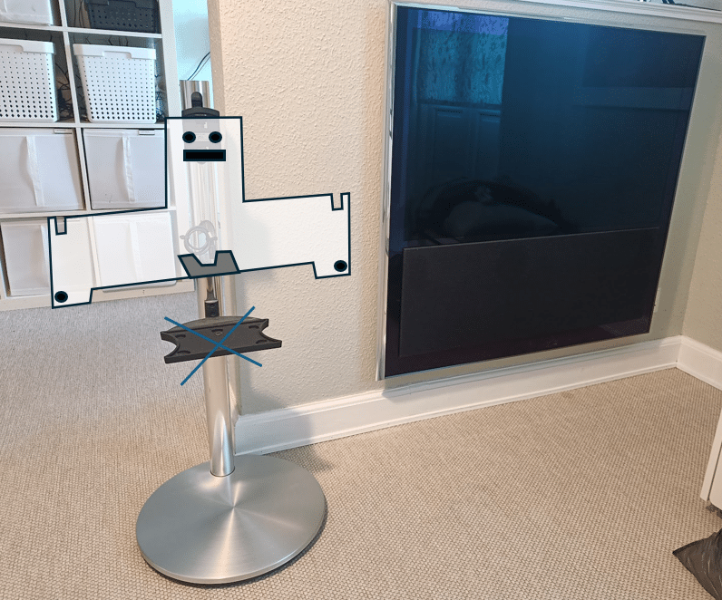

29 October 2025 at 15:58 #70759 RavstedBRONZE MemberJust an alternative option.
If you are a ‘handyman’ … it should be possible to convert a BV7-32 stand for the BV10-40.
Where I live there are many BV7 stands available and you get them more or less for free (<40£)
You can buy a DIN<>8 PIN micro-fit molex cable or solder one and make a plywood adapter plate yourself.

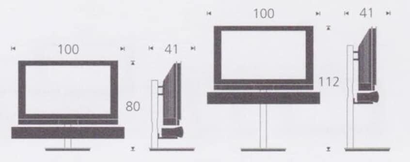

29 October 2025 at 20:01 #70763 TignumGOLD MemberHi, +1 with Ravsted: check this thread too: https://archivedforum2.beoworld.org/forums/t/36445.aspx,
I have a 7-32 stand spare (the 4091 floorstand), but it is in the Netherlands…
I own both stands actually and was curious for the heights.
My BV7-32 stand measures about 87cm (top of the footplate to top of the interface).
My BV10-40 stand measures about 62cm there, with an 8cm gap between footplate and TV.
So using this stand for a 10-40 would actually result in (87-62)+8=33 cm gap! Too much and ugly. Maybe the lower 4092 fits? Or shorten the pole handyman style?

I got a 10-40 hanging on the wall and a BV7-32 stand. I just placed them next to each other to illustrate how I would make the adapter plate.
I looks a bit like a ghost 🙂 – – but it is Halloween tomorrow – – so…. 🙂
At the top you have 2 holes to bolt it to the original bracket. There is a small cut-out for the hinge.
Put 2 bolts into the TV and slide it into the two cuts/slots at top.
Fasten the bolts and add the additional 2 at the button.
The cut-out at the button ensures the ventilation isn’t blocked.
A small bracket (drawn in grey) determines the tilt as the TV will lean forward by default due to the modified ‘balance point’.
This will put the TV at the original heigh above the stand-base i.e. approx. 8-10 cm.
