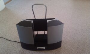

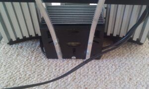

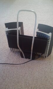

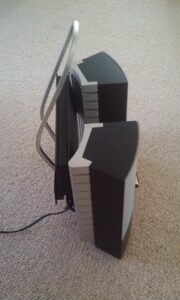

    It definitely does work if you have the correct software versions. I had my 5 Wireless 1’s Updated to the most recent software a few years ago. Are you aware that all software versions on the Wireless 1’s have to be the same for them to connect.
    I made two of these “portable” Beolab 2000s. We use them outside in the summer so we don’t have to have the HiFi blaring to hear the music. Just need to plug them into a power socket and turn on.
    I made the aluminium handle and bolted it to an original wall bracket which the speaker “hangs” from. There was a space for a small screw to hold it all safely on the bracket. Steve at Sounds Heavenly made very short Masterlink cables so I could connect it all up neatly and just have the power cable showing.

    I can confirm with a correctly set-up BLW1 that a Beolab 2000 works (Both with a Beo4 remote using the built in IR eye and local buttons). I have added a handle and permanently connected the BLW1 to the speaker, with a very short ML cable, to make it a bit more portable. I’m listening to it in my study at the moment. It is fairly stable until we use a microwave or the wireless printer which is hardly ever!
    I have 1 set to transmitter and 3 receivers. One for the BL2000 (Masterlink – portable), 1 for a set of BL3’s (Kitchen) and one for a set of BL12-3’s (Sun Room) both PowerLink. They all work really well.
    I bought my first pair of BLW1’s new, then bought 2 separate used ones later and they did not work with each other or my original two, so I asked my dealer to update them all to the latest software. That was probably about 2015.
