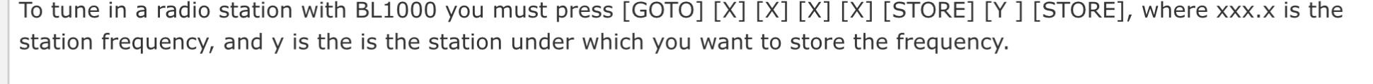

    From memory…….back in the days I used a Beolink 1000 – which has a native GoTo button – and did the following:
    IMG_0903
