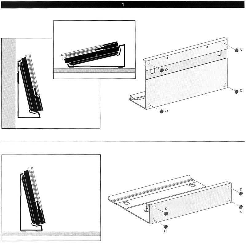

    Then this how it ends so far…
    I specify I’m using a Beolink 5000.
    BS9000 in A.Opt1 (IR control enabled).
    Playmaker in A.Opt4 (needs “Link” button prefix).
    Pros:
    Full IR control on the 9000 allowing to control CD and select sources like radio (I’ve discover the very fancy RDS display with song names, etc…), but also and most important, “Phono” that allows me to open the path to the BG4002 and enjoying the “Phono” display…
    Allows me to get rid of the external source selector I used to use to switch the line in from the Playmaker between BG and BS.
    The “+link” gymnastic to control the PM needs a little training but doesn’t seems like intolerable: I don’t change volume every second, and when you add “+link”, the device seems to remenber it for a few time so volume control often do not even require that sequence.
    Full standby works with a long press, whatever the whatever.
    Cons:
    Sometimes I need to read again this post to understand how all this really works.
    (Edit to add cons) Sometimes the Beolink 5000 loose the one way setting and, messing with the limits, its annoying.
    (Cable management in progress)
    IMG_3294
