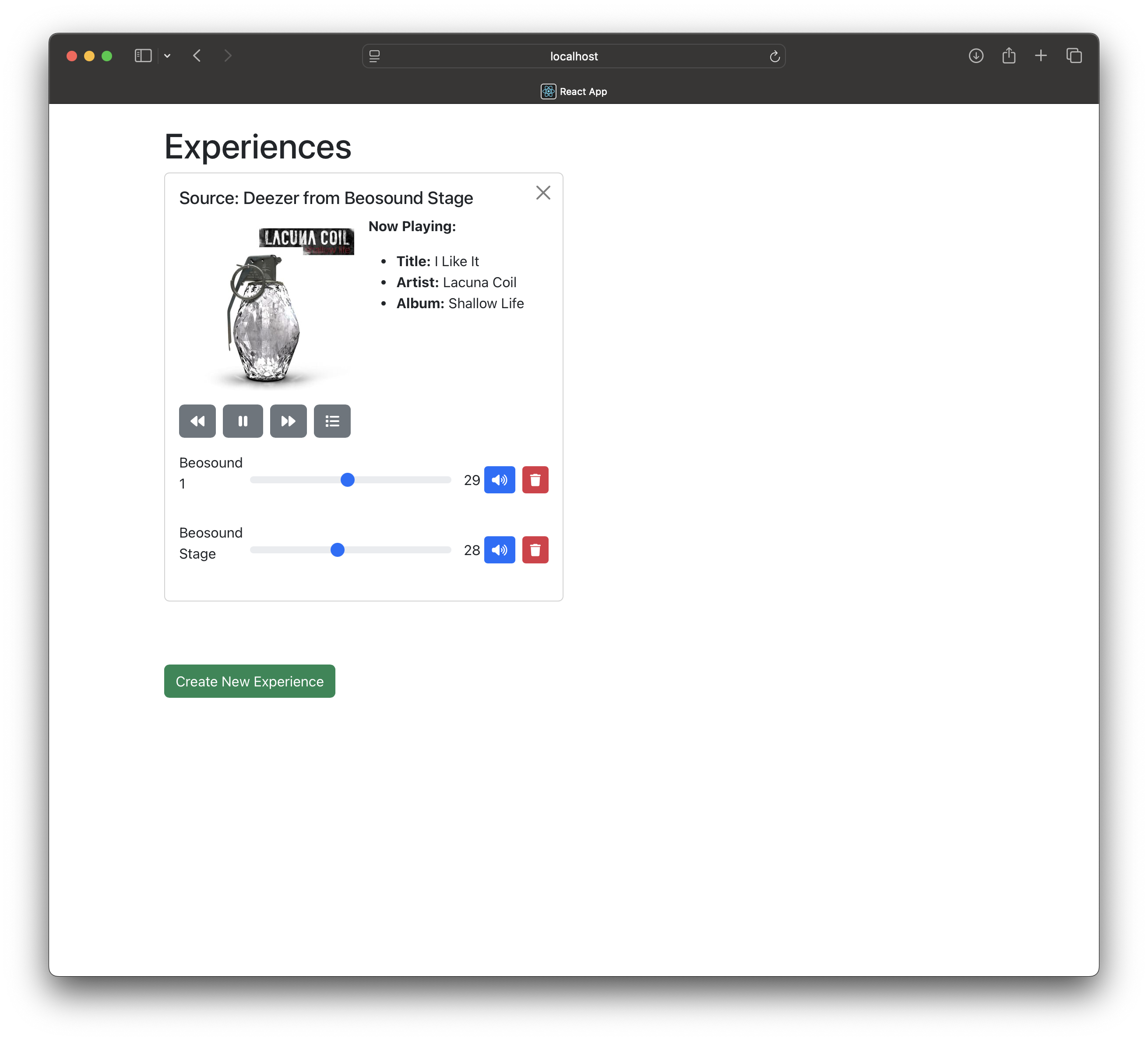

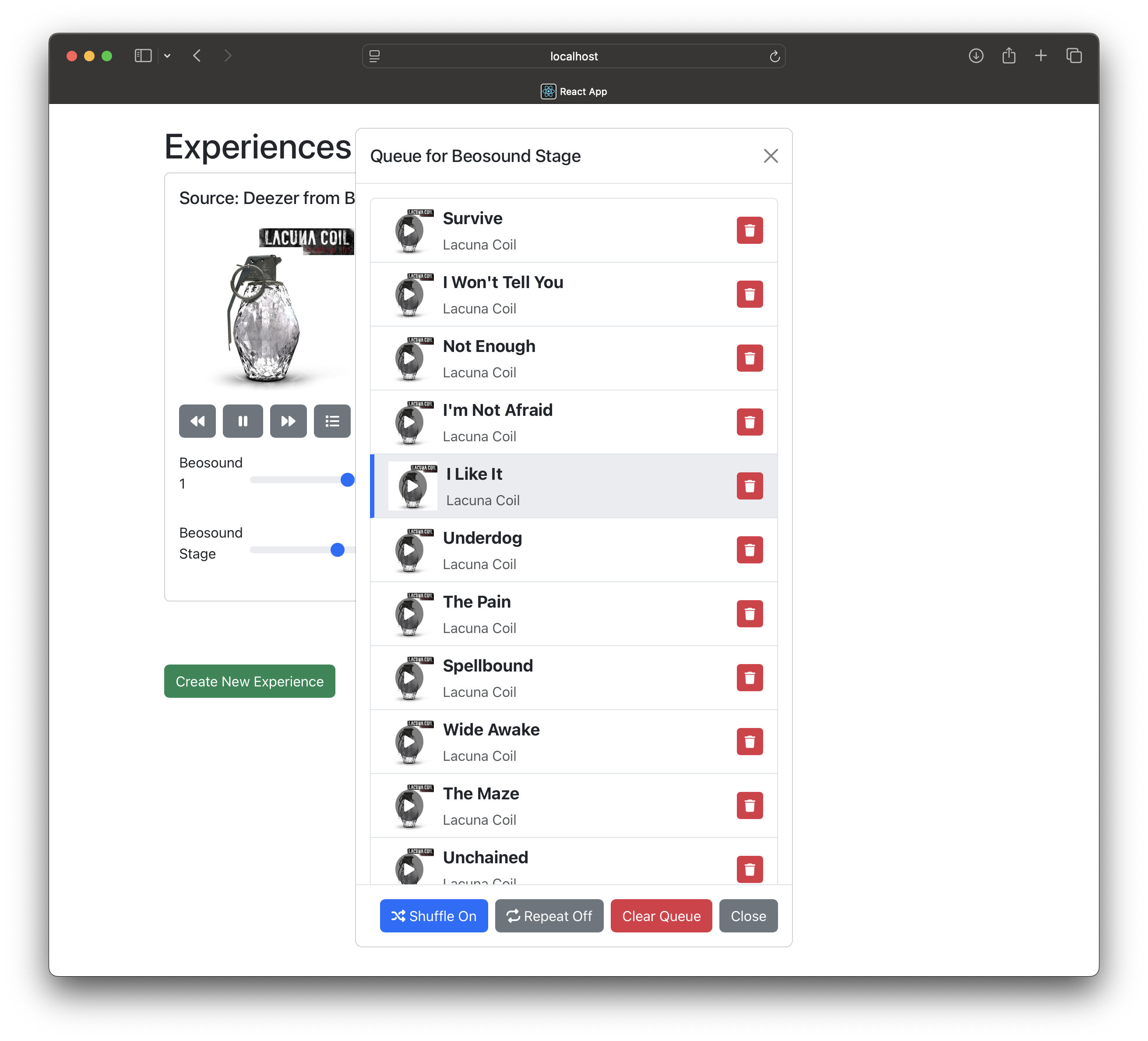

7 October 2024 at 11:49 #59948andy_js
BRONZE MemberHere are some screenshots showing a multiroom “experience”:
