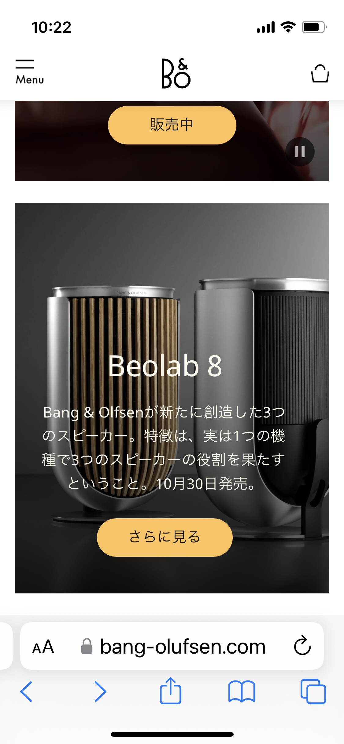

    etype76
    I wonder if dark oak will be available from October 30? As a match with silver. I see the anthracite is coming Feb 2024 so substantially later.
