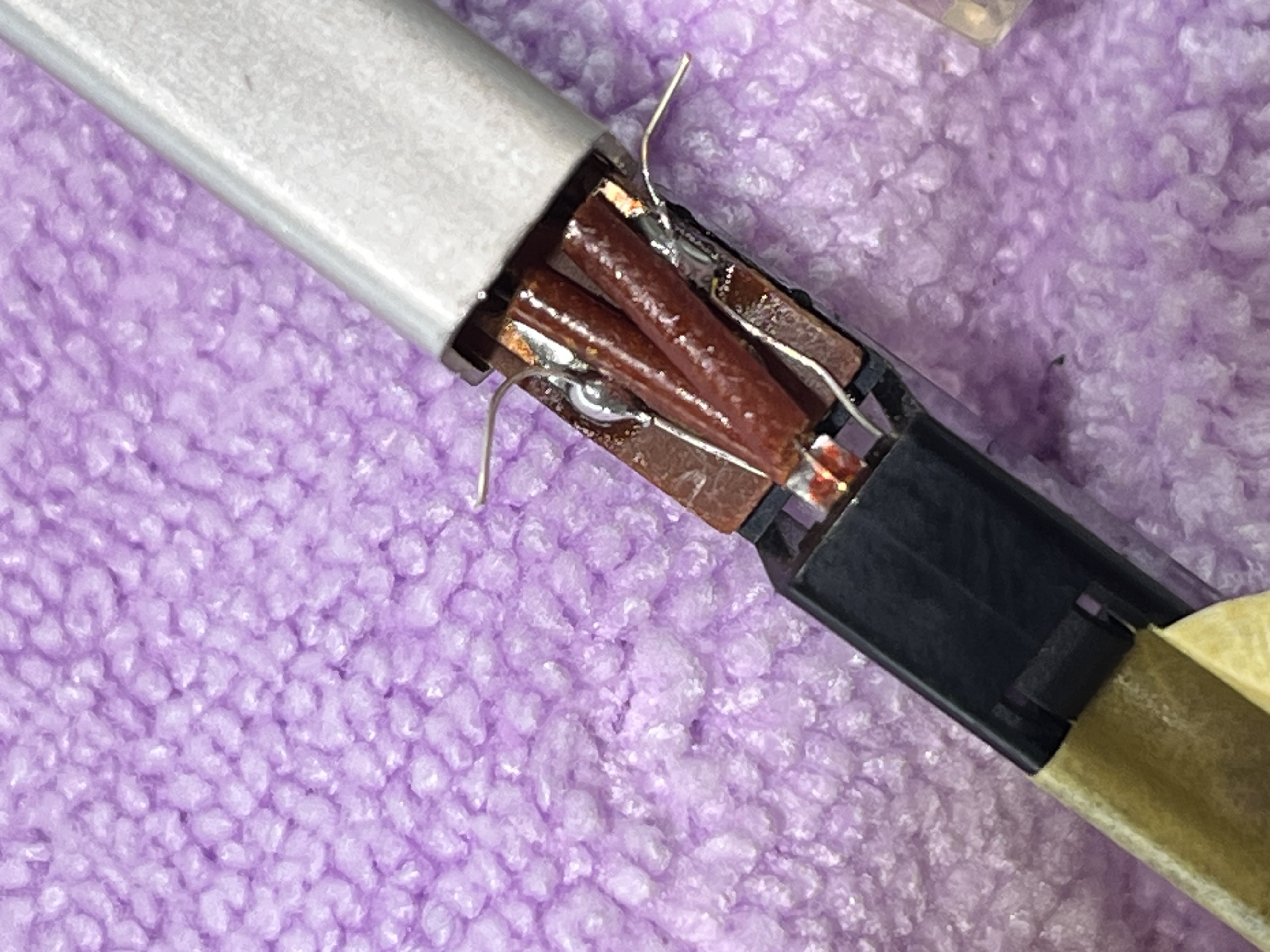

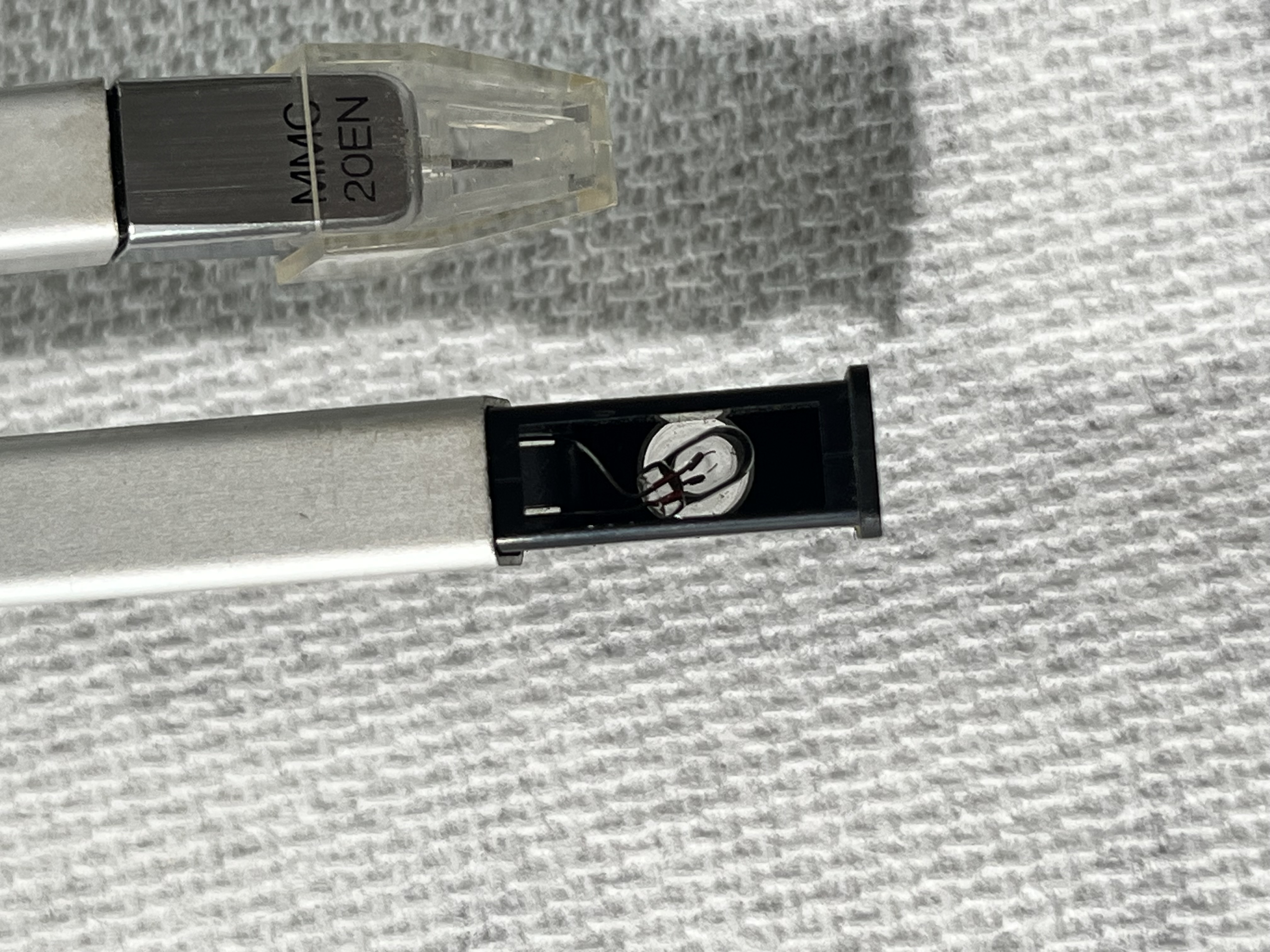

    I managed to install a new incandescent lamp. The BG4000 is working great again now. The bulb was trying to ride high so I placed a piece of masking tape to hold it down while I did the soldering. I also slackened and fed the green wire at the back of the arm a mm or 2 so I could get access.
    the first pic shows the blown lamp and the second the solder points.
