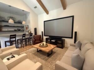

    beotex

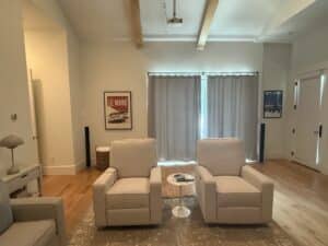

    I have a media room / bar / lounge set up with BL8000’s in front, BL7-2 as a center, BL6000’s in the rear, with a BL2 sub. It’s all powered by an older Beosystem 3 and connected to a BS9000. As I’m all in the B&O ecosystem, I can’t comment on using a third party receiver. I really enjoy the sound – full with deep bass thanks to the sub, and clear vocals with 7-2 center. Just wish the BS3 could handle 4k…
    The BL6000’s sort of disappear in the room, as the footprint is small and the aluminum helps it blend in from the side. If I change the fabric covers to something lighter, it would make a huge difference, but I prefer the traditional black fronts. My BL2 is hidden at the end of the sofa.
