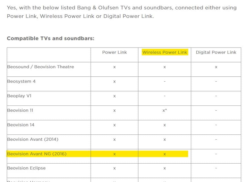

    #65552
    beotex
    Hi
    Beolab 8 doesnt support VE 1.0 and 3.0 with Wisa (avant/avant ng/horizon etc
    but with powerlink cable it should work
    So, still not giving up on this, and saw this posted on B&O support page (https://support.bang-olufsen.com/hc/en-us/articles/19039779370001-Can-Beolab-8-be-used-in-a-surround-sound-setup-with-a-Beovision-TV). It states that the BL8 should work wirelessly with the Avant NG. Anyone have any luck?
