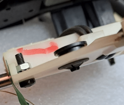

    in reply to: Beogram 9500 – adjusting the set-down position #79767
    adyan
    Hello,
    here are 2 pictures from the intenet how peaple have done it:
    adyan
