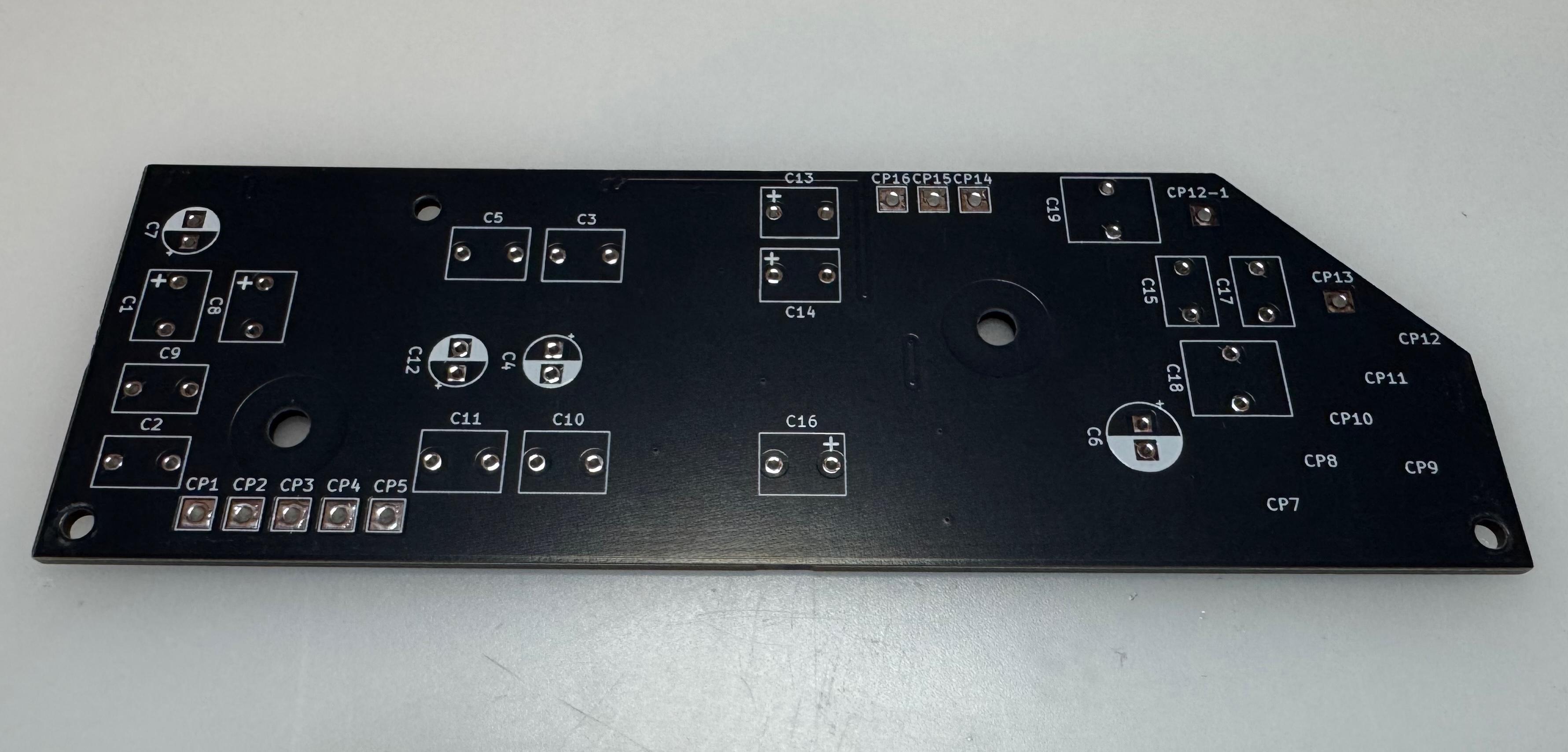

    Hello all,
    hope this will be ok…
    long time tried to get a BG59xx type turntable with integrated RIAA for a good price, but that seems to be impossible.

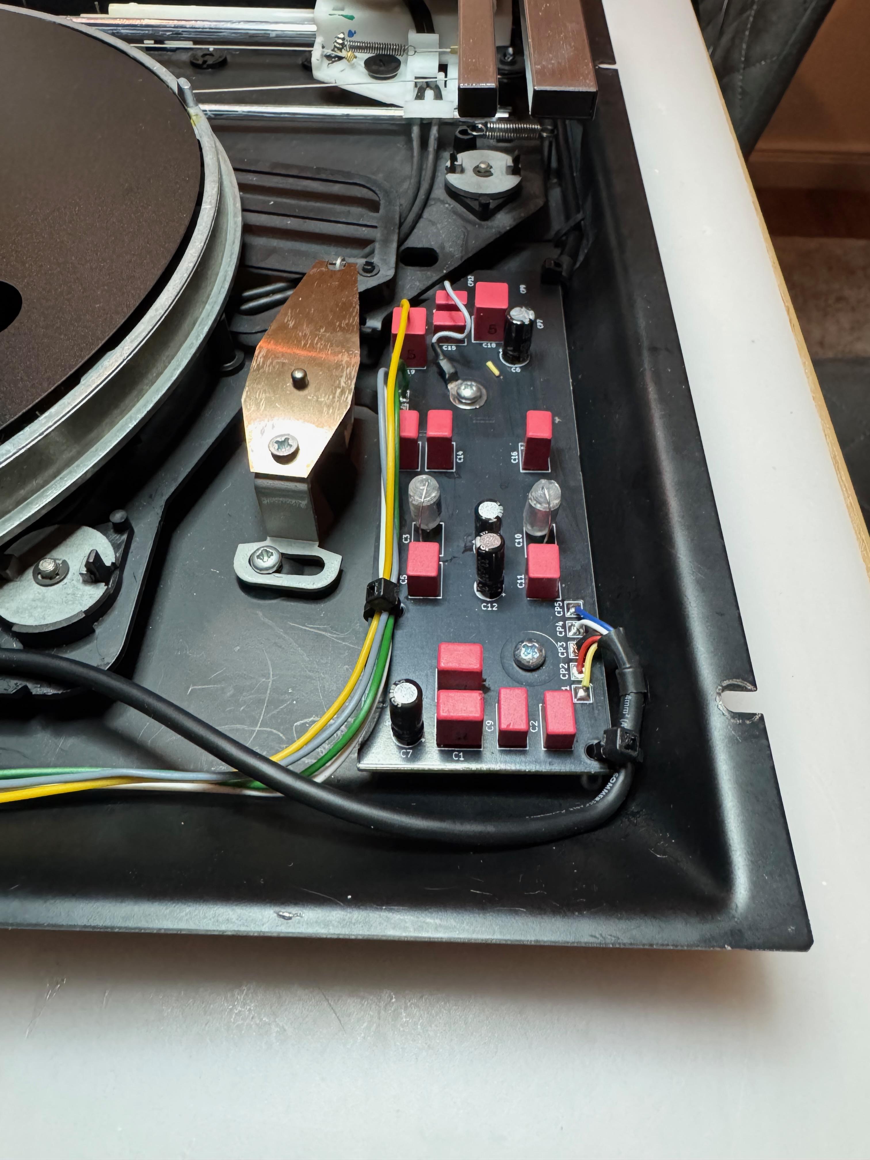

    As I like to get it as original as possible I made a PCB of the original schematics and used it in my TX2.
    I had to order more PCB´s than needed, so there are a few left. Probably someone may be interested. PCB  or populated PCB possible. If so please contact me via pm.
    IMG_7224
    IMG_7249
    Regards
    Christian

    Dillen
    Very nice – but please keep in mind, that the muting system needs to be changed accordingly,
    as the models with RIAA mutes before the RIAA rather than after.
    And not all type 59xx decks has the output from the power supply to the RIAA module.
    Martin

    adyan
    Thank you Martin.
    Yes I know this, its documented in the service manual.
