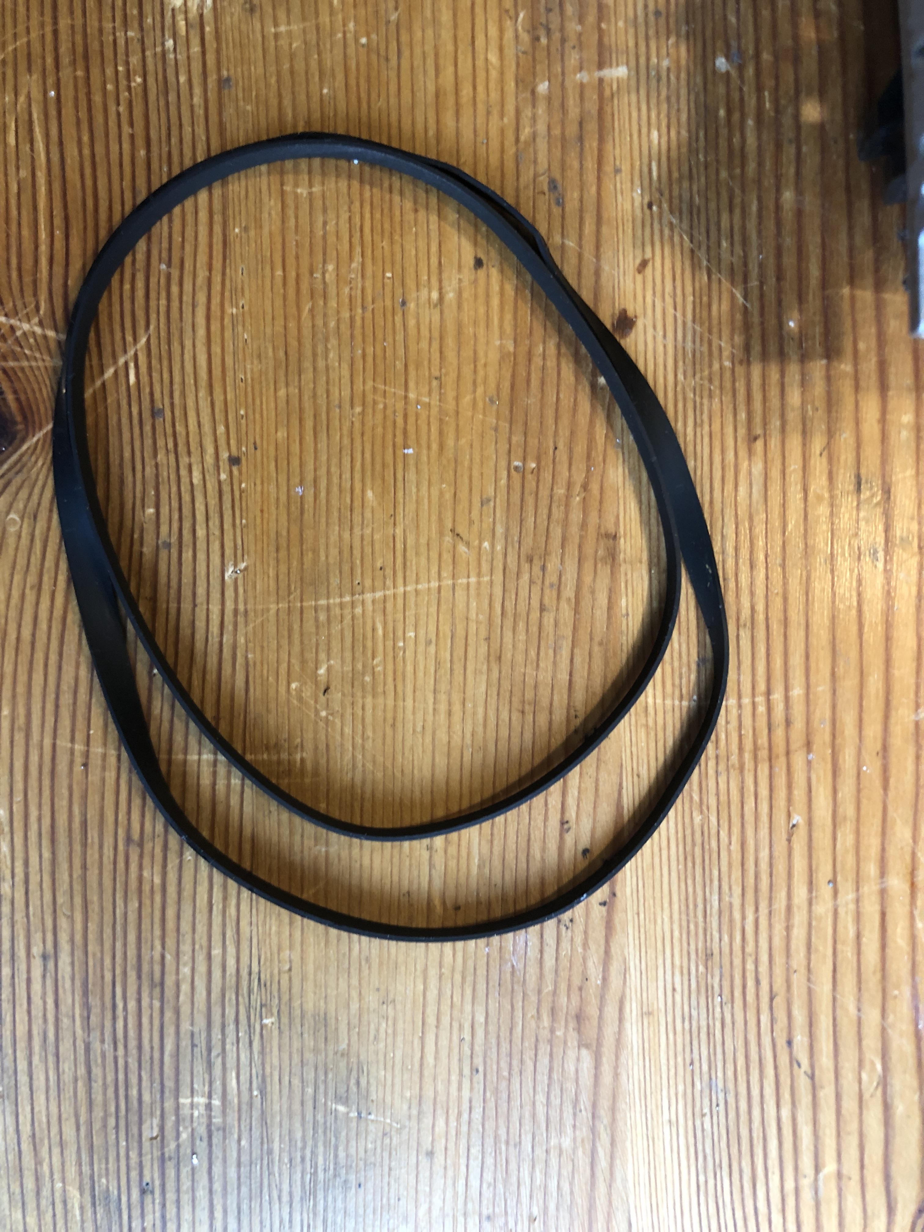

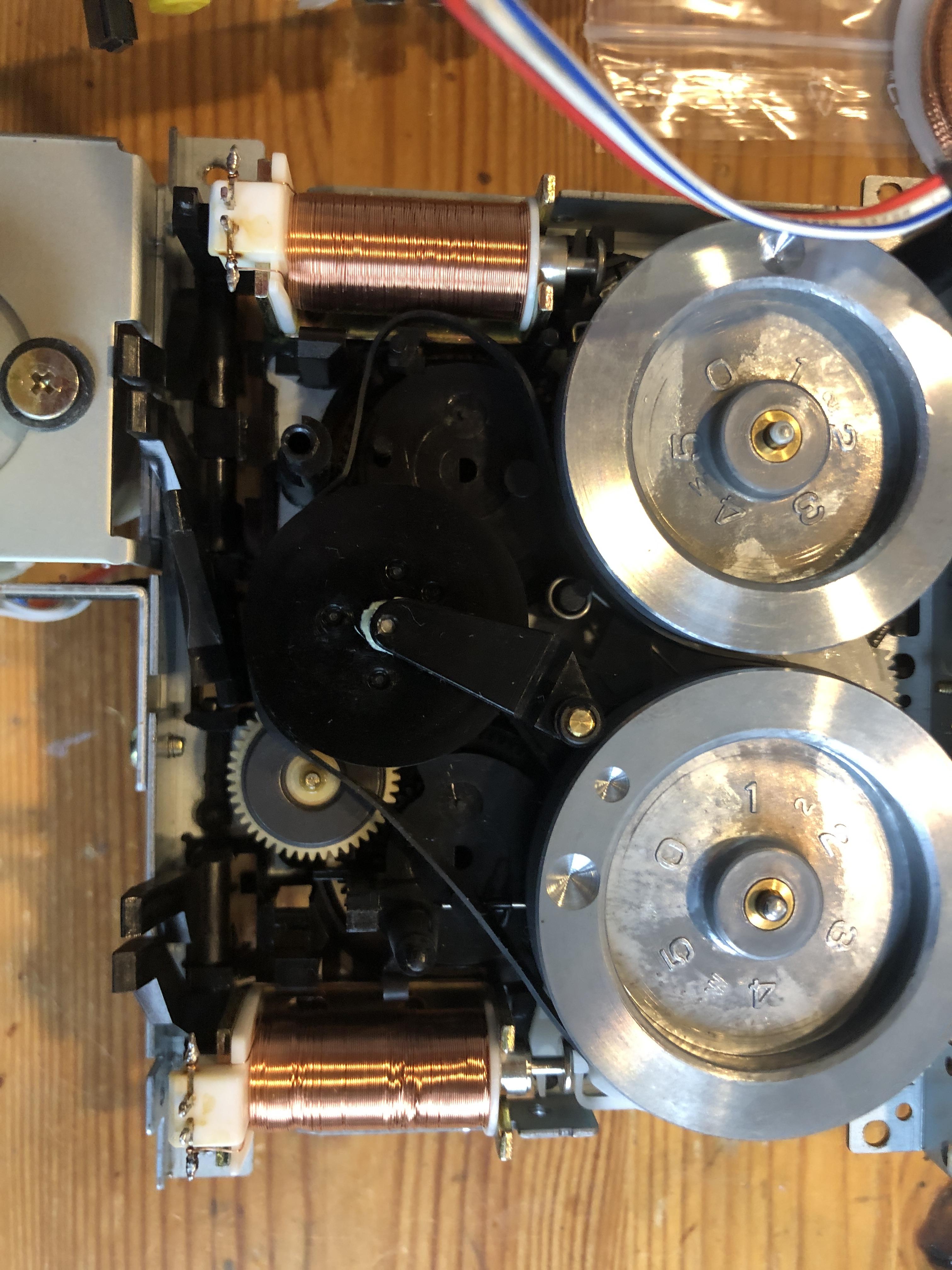

    I have been working on a non working CD and tape player in a Beocenter 9300 and have now finished it  with both sources working again. It has been a dream for  me for many years to get one of these Beocenter systems, and here it is all lighted up and ready to play all of it’s sources 🙂
    IMG_9206
    The CD player go a new laser as described in this thread
    https://forum.beoworld.org/forums/topic/beocenter-9300-laser-replacement/#post-24961
    The casette section needed 3 new belts.
    This picture shows one of the old belts in the mechanism, and you can almost see that it has to much lenght and bends away from the straight line it should have.
    IMG_9199 Also for comparison here the old belt and the new put on top of each other
    IMG_9202
    It’s not without reason that new belts make a difference. One of the smaller ones was also cracked and perished.

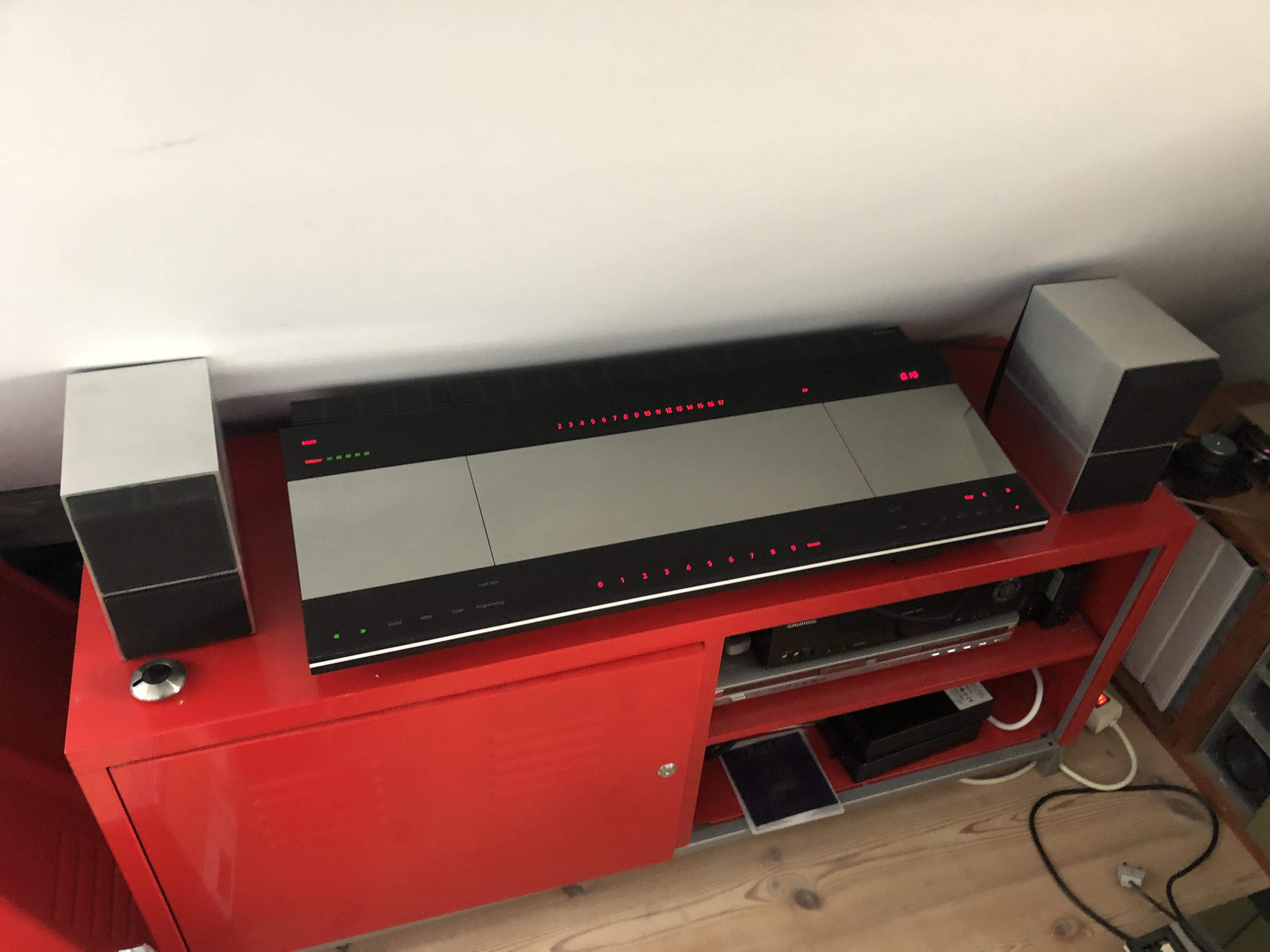

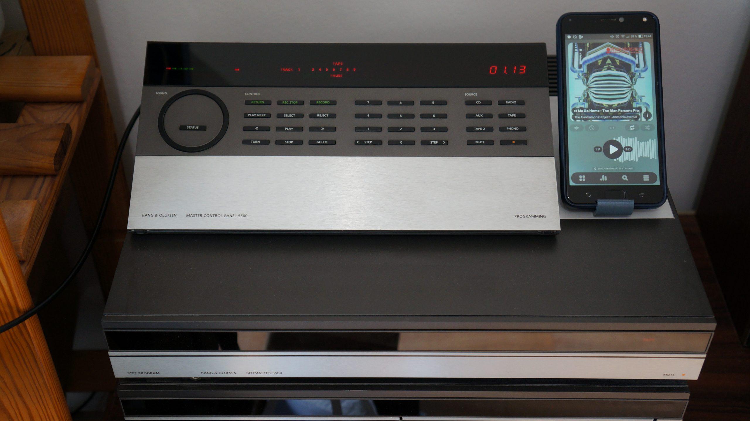

    Sneak peek at my ongoing project !
    DSC09147-scaled
    Location: France
    #33411
    Guy
    Intriguing! Looking forward to hearing more as it develops.
    (Is the MCP showing the elapsed time of the playing source? – they are only one second apart)
    Well observed ! The slight difference is due to the playing app on the phone, and unrelated to my project.
    I’ll open a new thread soon with all the details 😉

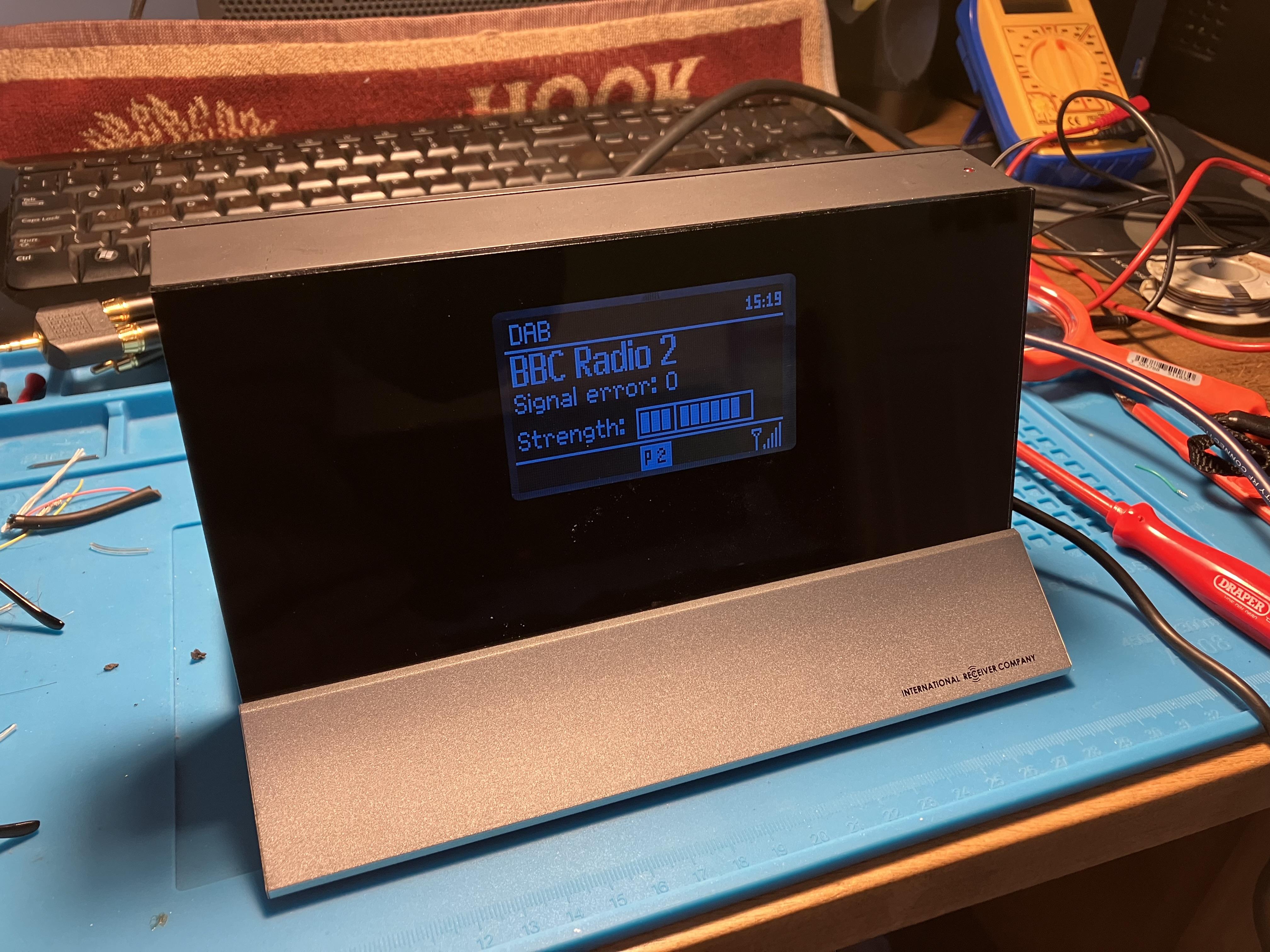

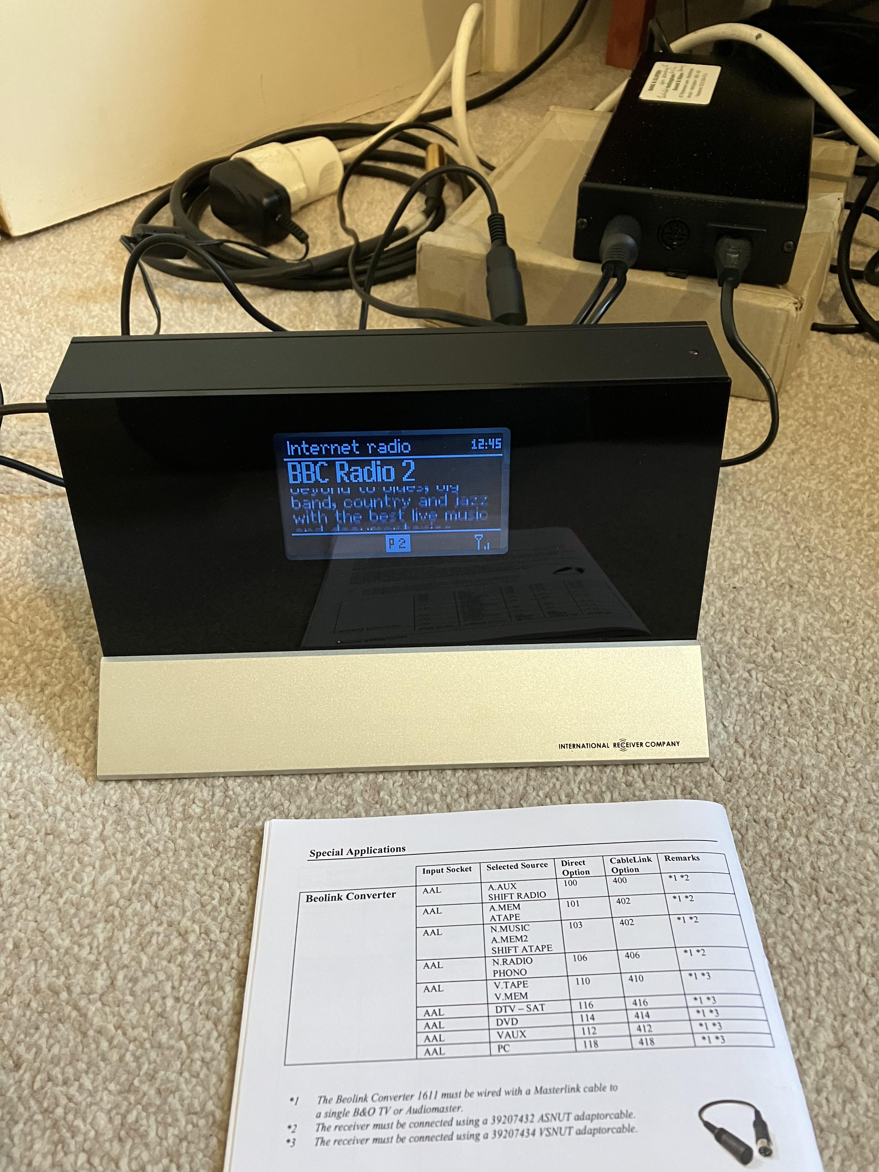

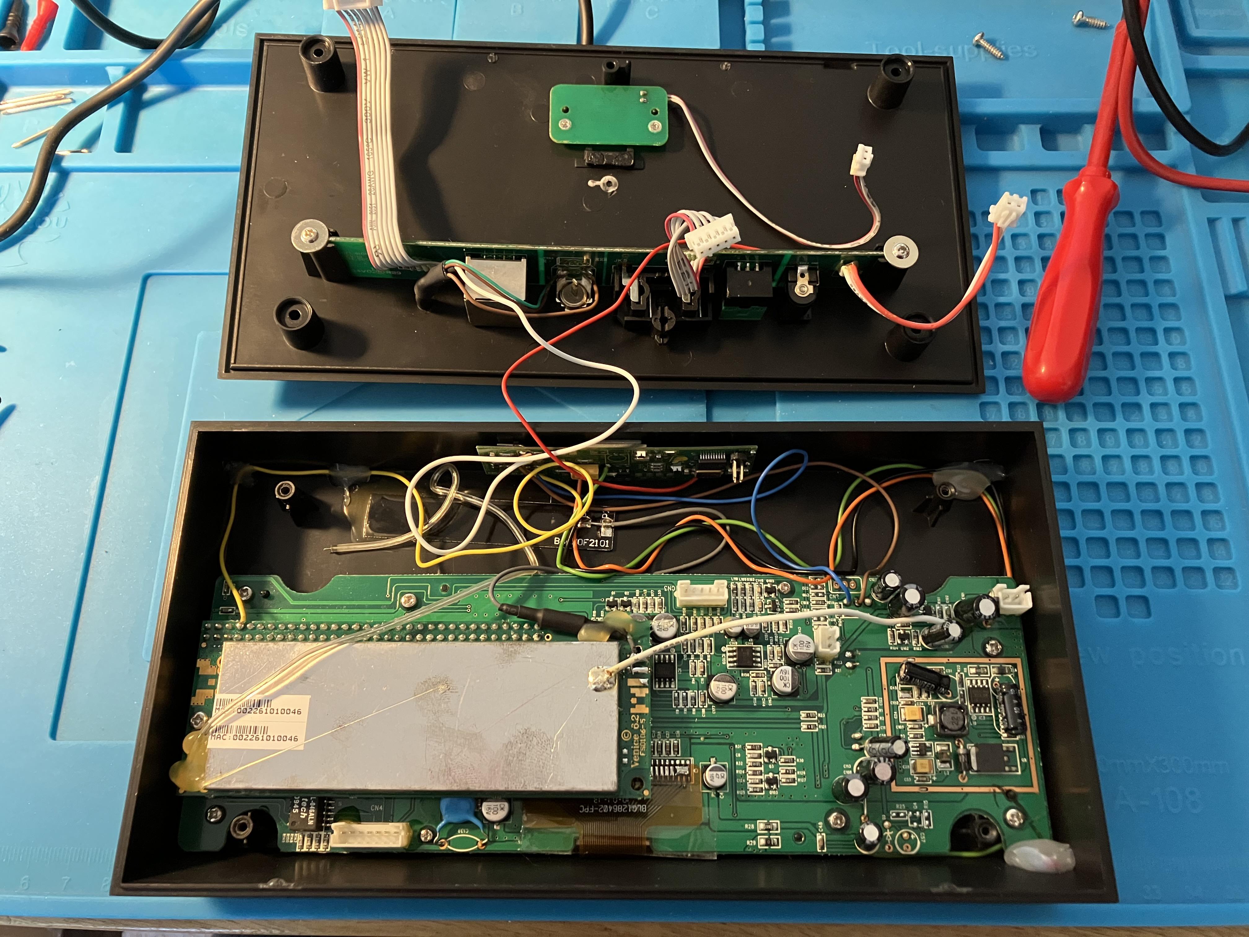

    After discussing the UK’s transition to DAB (and possibly DAB+) on another thread, I thought that I would dig out my OneRemote receiver and check the DAB/DAB+ reception in my area.  I had previously mainly used it for internet radio. I took advantage of our knowledge from the Beolink Converter 1611 Innovative Configurations thread, where I posted about the OneRemote/1611 combination here: https://forum.beoworld.org/forums/topic/beolab-3500-and-1611-converter-settings/page/9/#post-14354
    Here’s a photo from that post (the BL1611 is further connected via ML to BL3500):
    IMG_6501
    Anyway, I set up the OneRemote as before and had a bit of a play.  The first thing that I worked out is that there are additional OneRemote ‘cablelink’ codes not shown in the table above that can be used to turn on and control the OneRemote via Datalink.  I found that code 404 allows it to be selected by input ‘CD’, and code 408 by ‘RADIO’.  The latter code is very useful because in a stand alone setup with BL1611 and BL3500 you can use the Beo4’s RADIO button to turn on, and RADIO obviously shows in the BL3500 display.
    I searched for DAB stations and performance was poor – I thought due to my temporary antenna stretched over the wardrobe.
    I also noticed that the OneRemote’s line-out volume was imbalanced – far stronger on the right than left.  I checked the OneRemote’s headphone output and that was balanced nicely and at a similar level to the line out.

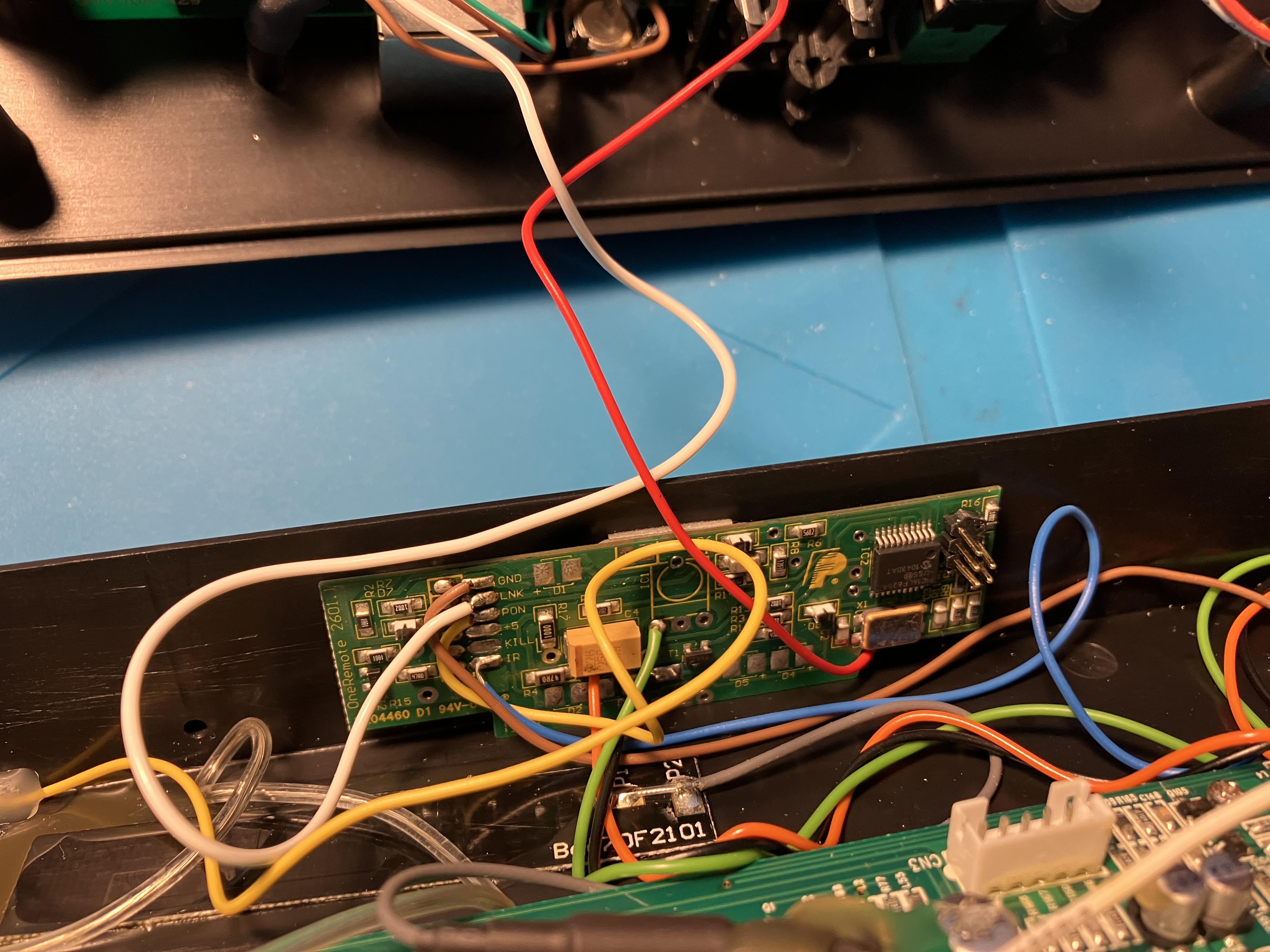

    I decided to open up the OneRemote receiver to see if the balance issue was anything obvious (click to enlarge).
    IMG_7718
    The first thing I noticed is that the antenna wire (silver from PCB lower left) had not been soldered to the back of the F-Type connector.  Perhaps this was an oversight when OneRemote modified the receiver for B&O datalink/remote compatibility, so I have now connected it.
    Out of interest, here’s a close up of the extra PCB that must give the datalink capability – the white (LNK) wire is connected to pin 7 on the DIN output plug:
    IMG_7720
    I couldn’t see anything obvious causing the balance imbalance (?) so I cheated and moved the audio output cables internally from the line-out to the headphone-out.  Headphone volume is effectively fixed anyway, so no issues.
    I reassembled and all is now working fine including a strong DAB signal.
