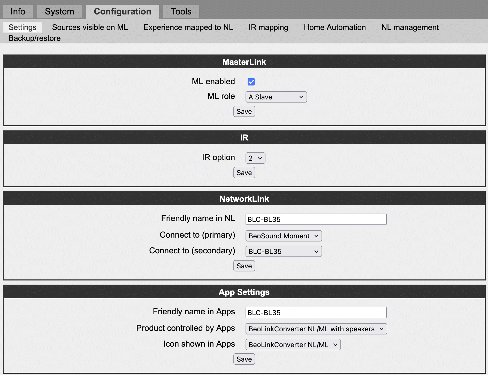

    I’ve for a few years now enjoyed having my BL3500 connected to the default ML-network to audio from my Moment including my Beosystem 6500 (via MCL->BLC NL/ML) would now toying around with the thought of connecting the BL3500 via a BLC  NL/MLto make it multi-room capable to be able to play whatever I like regardless what else is being played on the ML-network. But, when connecting the BL3500 to a BLC NL/ML the BL3500 won’t react in any way. Reconnecting directly to the ML-network; it works fine.
    What is it that I’m missing out here with regards to the BLC NL/ML configuration?

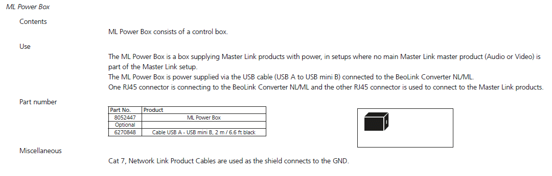

    I think the problem could be that there is no audio or video master on the ML side, hence no power being supplied to ML.
    In this sort of situation you need an ML Power Box – see attached from the BeoLink Handbook: (click to enlarge)
    EDIT:  See also this thread about the Powerbox used with BL3500: https://archivedforum2.beoworld.org/forums/p/16217/141383.aspx

    Hello Guy! Well, I do have both Audio/Video master on the ML side. As a refresh, you might remember this thread in the old forum which helped me out to get the Beosystem 6500 linked to my ML-network. While the BS6500 system isn’t on the below diagram, it’s the BL3500 in my office that I want to re-connect via a BLC to be able to play audio sources regardless what is being played on the ML-network.
    Next what wanted to try out if it’s then possible to join the BL3500-BLC to an existing multi-room device such as Beosound Level. This is seconday, so for now first problem to solve if it’s possible to get the BL-3500 to play. But, I hope that the above diagram and previous thread gives a bit of insight of how the system is setup.
    [Edit Update]
    [EDIT Update#1] I currently have the following BLC active in the network were BLC-BV10 acts as A-Master:
    1. BLC-BV10: 1st BLC (ML Role: A-Master) device used to connect the Beosound Moment with BV10.
    2. BLC-Bs6: 2nd BLC added to get the Beosystem 6500 connected to the ML-network via Beolink 1611.
    3. BLC-BS9: 3rd BLC (ML Role: A-Slave) to connect the Beosound 9000 to avoid having two A-Masters.
    4. BLC-BL3: 4th BLC (ML Role: A-Slave) to be used for the BL3500.
    Location: Malmo, Sweden

    Guy and Madskp are right.
    the essence is your misinterpretation of the “A.Master” and “A.Slave” setting of a BLC.
    On the NL-side there are NO differenses between devices, so all devices are equal, no masters no slaves.
    On ML side there, you must have or a V.Master, A.Master or both.
    That said, the master and slave settings for the BLC´s are for the ML connected devices of THAT BLC.
    So setting a BV10 as V.Master on one BLC doesn’t mean your complete system (NL & ML) has a V.Master. It means de ML string connected to that BLC sees the BLC acts as V.Master in that ML string.
    Thus to have the BL3500 working correctly you should follow up one of the proposed solutions.

    You might want to set theBLC as A.master, V.Master or AV.master
    On the tab: “sources visible to ML” you will have to define what ML source names your BV10and Moment sources should have when controlled from the BL3500
    Location: Denmark

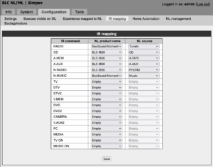

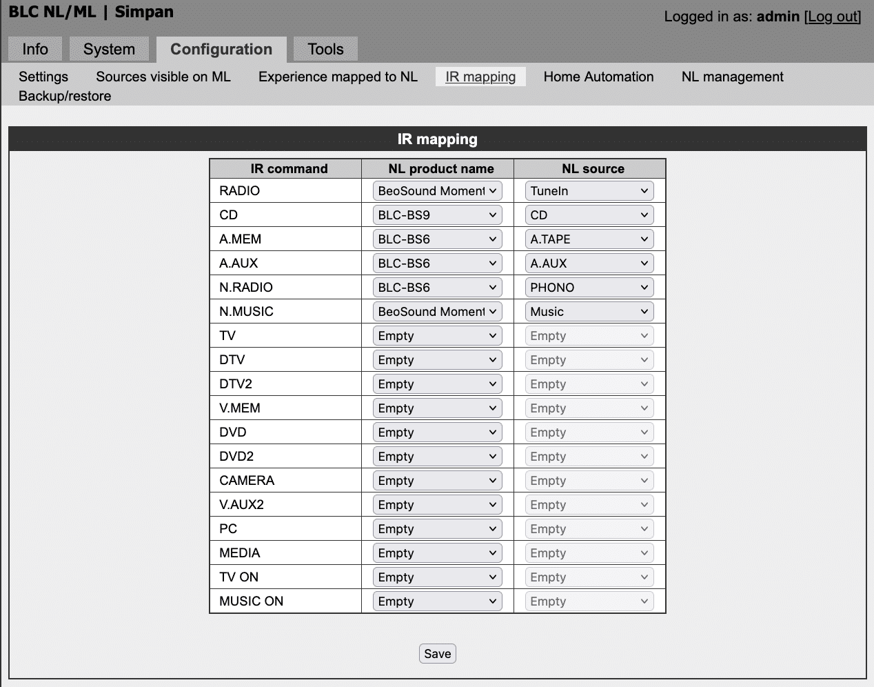

    @Carolpa Almost, but and I’ll use the same naming as previous used with a bit more description:
    1. BLC-BV10 (ML Role: A-Master) – My first BLC which was setup to allow Moment to use speakers connected to BV10.
    2. BLC-BS6 (ML Role: A-Slave) – 2nd BLC and 1611 which was used to together with 1611 for the Beosystem 6500.
    3. BLC-BS9 (ML Role: A-Slave) – 3rd BLC used together with BS9000 to be able to play CD (if connected directly to ML I could get it to work)
    4. BLC-BL35 (ML Role: A-Master) – 4th BLC for BL3500 and 1611 which is the unit that I’m able to play CD but not able to trigger either N.RADIO/N.MUSIC.
    To play Deezer via the Moment I use N.RADIO and for TuneIn I use RADIO since I’ve re-mapped N.RADIO to trigger the Beosystem 6500 turntable since B&O re-used the old PHONO for N.RADIO. If connect the BL3500 directly to MasterLink network it will play Deezer/TuneIn from the Moment inkluding A.TAPE/PHONO etc from Beosystem 6500 and CD from Beosystem 9000. But, once I connect the BL3500 via the BLC(-BL35) together with the 1611 I so far have only been able to play CD from the Beosystem 6500, but no other sources.
    And Yes all BLC units have the same IR mapping.

    With my questions I was searching for conflicts.
    Your response learned me that you should “re-think” your setup. Let NL be central and ML attached sources.
    How is your BL3500 BLC set? is the above setting s still in place?

    Skip the primary and secundairy connection altogether. All my BLC’s are set primary and secondary to themselve! This will make the operation unnessecary  complex.
    But is the BL3500 BLC still set as ASlave? If so, then this is incorrect! ASlave is used if a sole ML device without speakers connected, adds sources to NL. The BLC should be set as AVmaster.
    You should be able to play Deezer on the Moment and JOIN a BLC. But how to start Deezer on the BL3500 then? A question to be cracket.

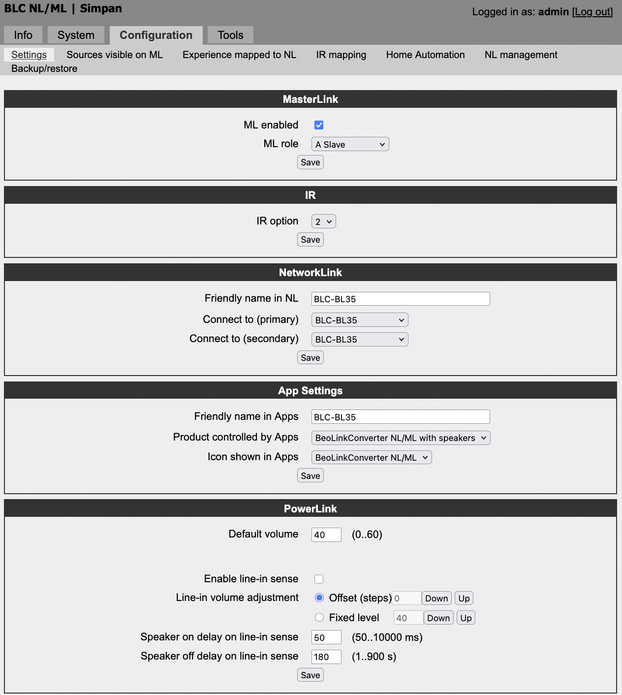

    I’ve changed the configuration so that the BLC-BL35 points to itself. This allows it to pull both InTune (via IR commands for RADIO and CD). If I leave the primary and secondary fields empty, it behaves the same way. However, there’s still an issue with getting N.MUSIC (Deezer) – Choosing N.MUSIC just makes a click noise from the speaker and indicates N.MUSIC but stills plays either RADIO (InTune) and if I play CD (from BS9000) and choosing N.MUSIC but no audio.
    If I understand correctly, adding a primary would make a specific BLC act as a “slave” to another BLC. How should the secondary connection be interpreted? Is it simply meant to allow a BLC to be linked to two specific units it should communicate with? I just want to understand the intended usage of the primary and secondary connections. I’ve browsed the NL Handbook but can’t say that I found anything specific talking about the roles and explaining; or I just missed it.
    No, for now I’ve set the BLC-BL35 as A.Master and what would the different be to set it AV.Master?
    For now, beside getting certain multi-room effect but not getting the B&O app to play along was a bummer. Just wondering if it ever worked?
    Just to clearify: with a remote you give the BL3500 the N.Music command? Maybe someone else can clearify is Deezer can be expanded to ML products?

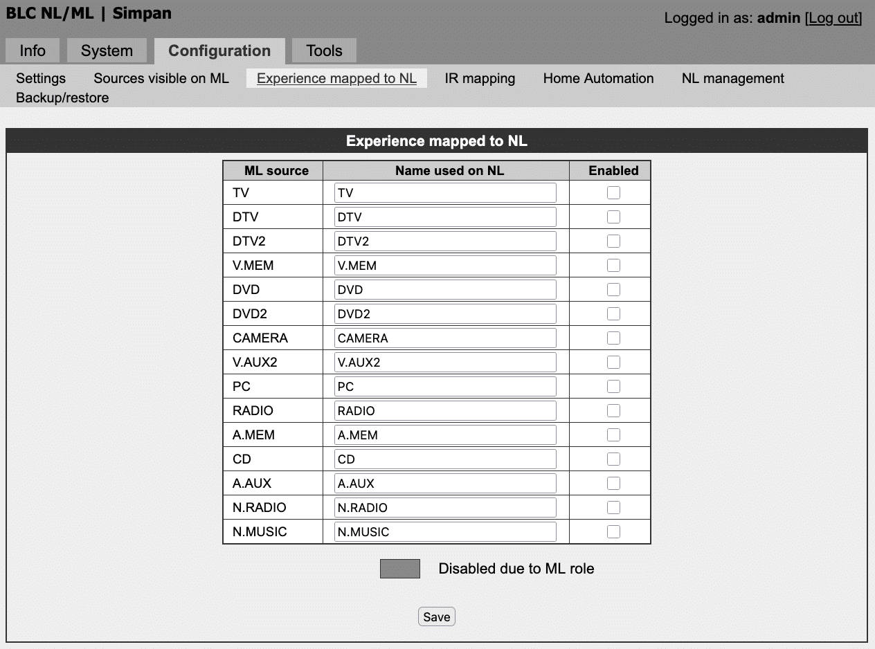

    Primary/secundary –   the sources of the, primary/secondary  linked, NL product are  shared with the linked to product. For example I set the BS7000 BLC as primary linked and the BS3000 BLC as secondaty to my BS Shape. Now the sources of the BS7000 and the BS3000 are local sources of my Shape; see picture.
    In principle your Moment should be able to do this also (but with all the sw issues in the past I’m not sure it still does).
    Technical speaking because the ML-string on this BLC doesn’t have a A.Master nor a V.Master you want to access ALL NL connected (and made available), thus as well audio as video sources. Then you have to set the BLC as AVMaster.
    It worked fine. But since the latest changes not everything is working as before, but still………..
