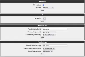

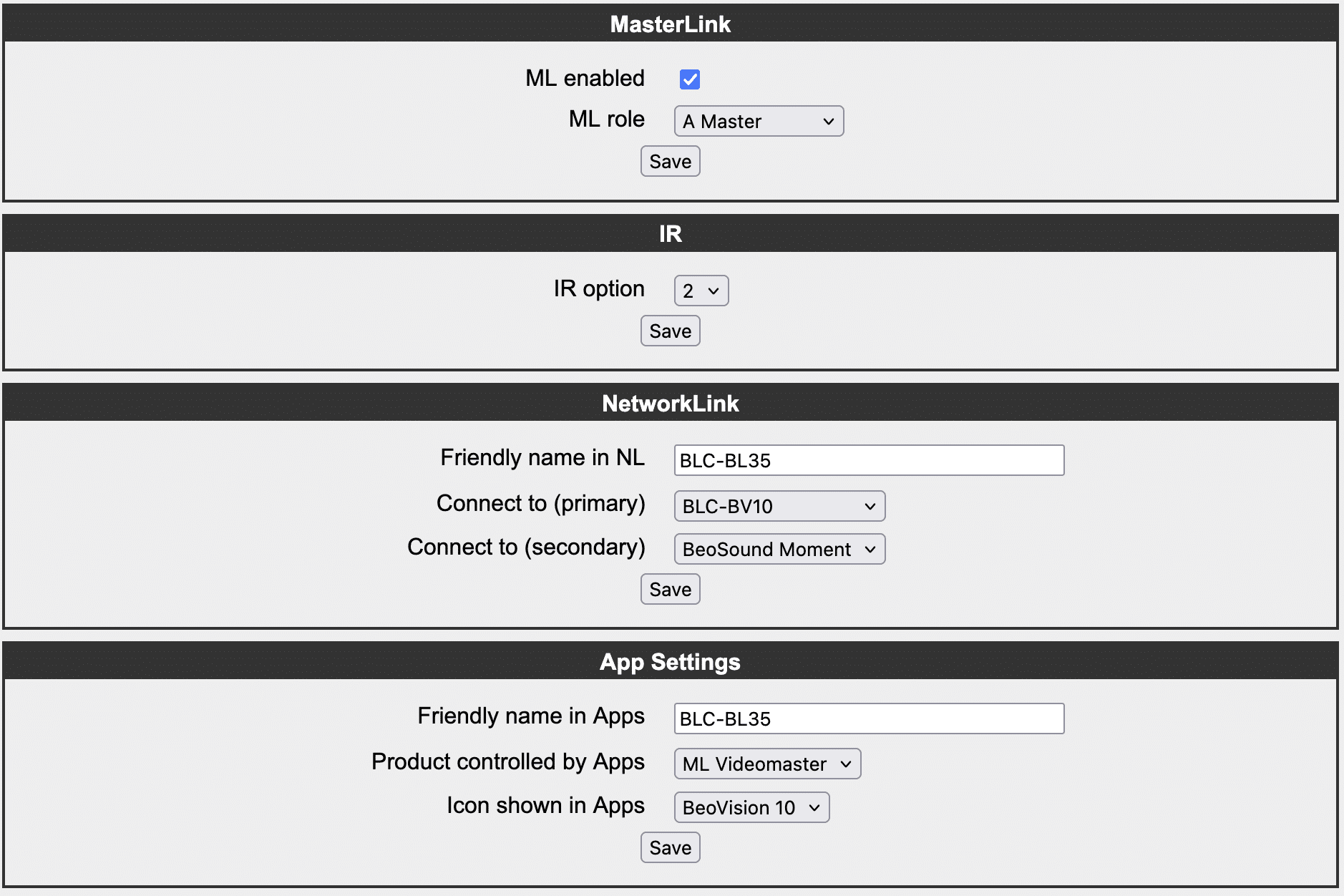

@carolpa: Yes, the BL3500 BLC set is still in place so nothing has changed. How would you deploy and setup the various BLC’s ti allow the NL be the central – not sure I understand how it would be possible to connect in a different way, or?
Should I understand that I make my BLC-BV10 the primary unit and then change so that the primary connection is set to the BLC-BV10 and the seconday BLC to whatever would be of interest for the specific BLC. Something like this then for the BLC-BL35:
Doing so I’m able then to play both CD (BS9000) and InTune (Moment) but neither able to get it to play N.MUSIC or pulling the normal audio from the TV-tuner. Unfortunate when I try to use the B&O App to play Deezer I get a brief error message saying – “This product does not support Deezer in the Bang & Olufsen App. To use this product with Deezer, use the Deezer app.”. What does work is that I can start N.MUSIC to the BL3500 via a for example Beo4 remote which I then able to see that is playing in the B&O App indicating that the source is Music from Beosound Moment and can’t control anything, meaning I can’t init play, pause or stop the music, only able to see what is being played from the Moment including that I can see device menu that music is being played on the BLC-BL35.
So to me it seems that it’s not possible to use setup a multi-room using a BLC and BL3500 since the B&O App won’t support it.
