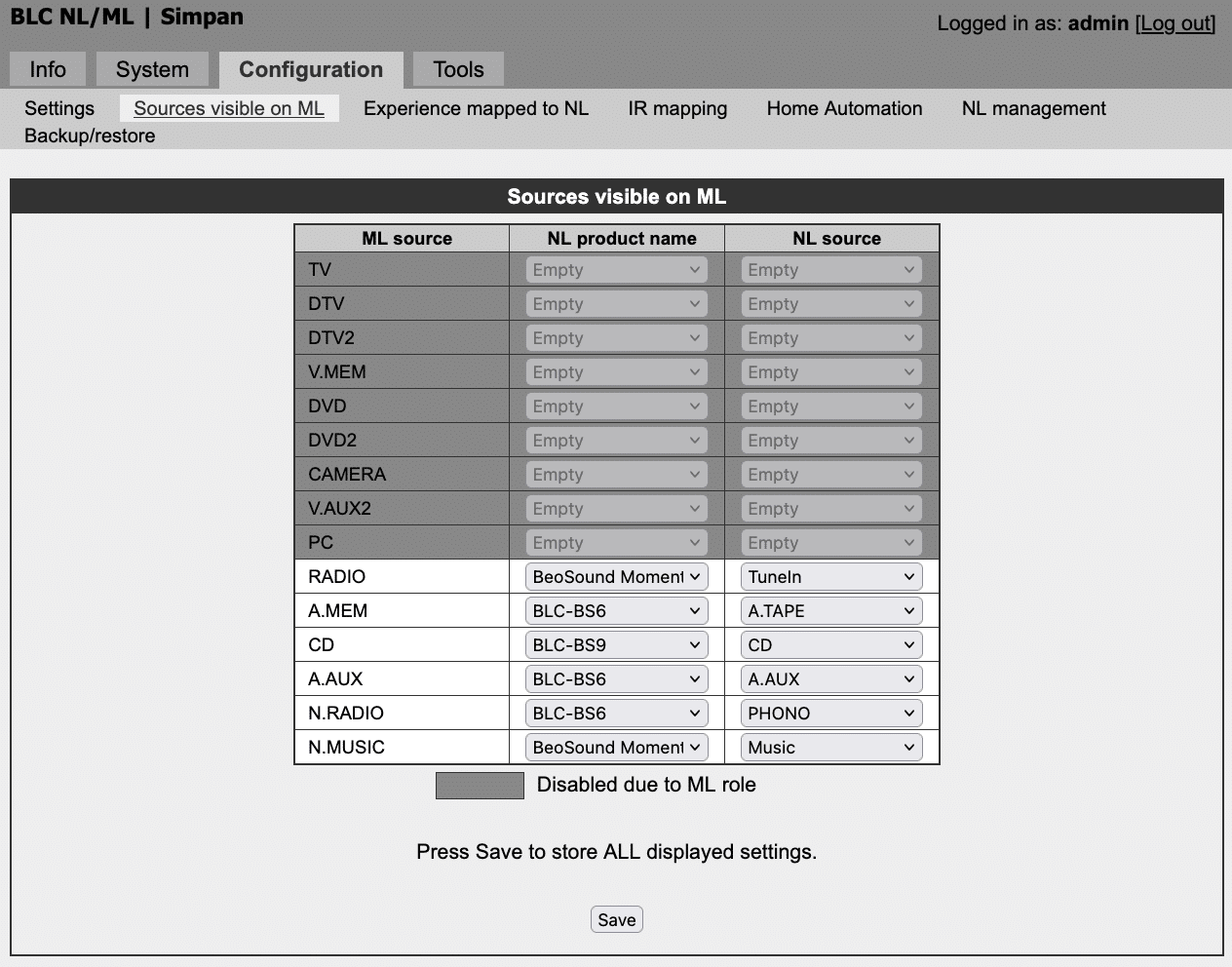

Right, so since the BLC is it’s own little ML it needs to have any of the A.master, V.Master or AV.master set and once I’ve done and tweaked the “Source visible to ML”; I could now play CD’s from BS9000 and play cassette from BS6500. But, when trying to play TuneIn (Radio) or Music (N.MUSIC) from the Moment then the BL3500 quickly indicate source and then powers off (including that it also powered off the BS6500 stereo) all other units in the ML-network. To be mentioned is that the Beolink 1611 has fw 1.3 and whether that is an issue or not… So, half there 😀
