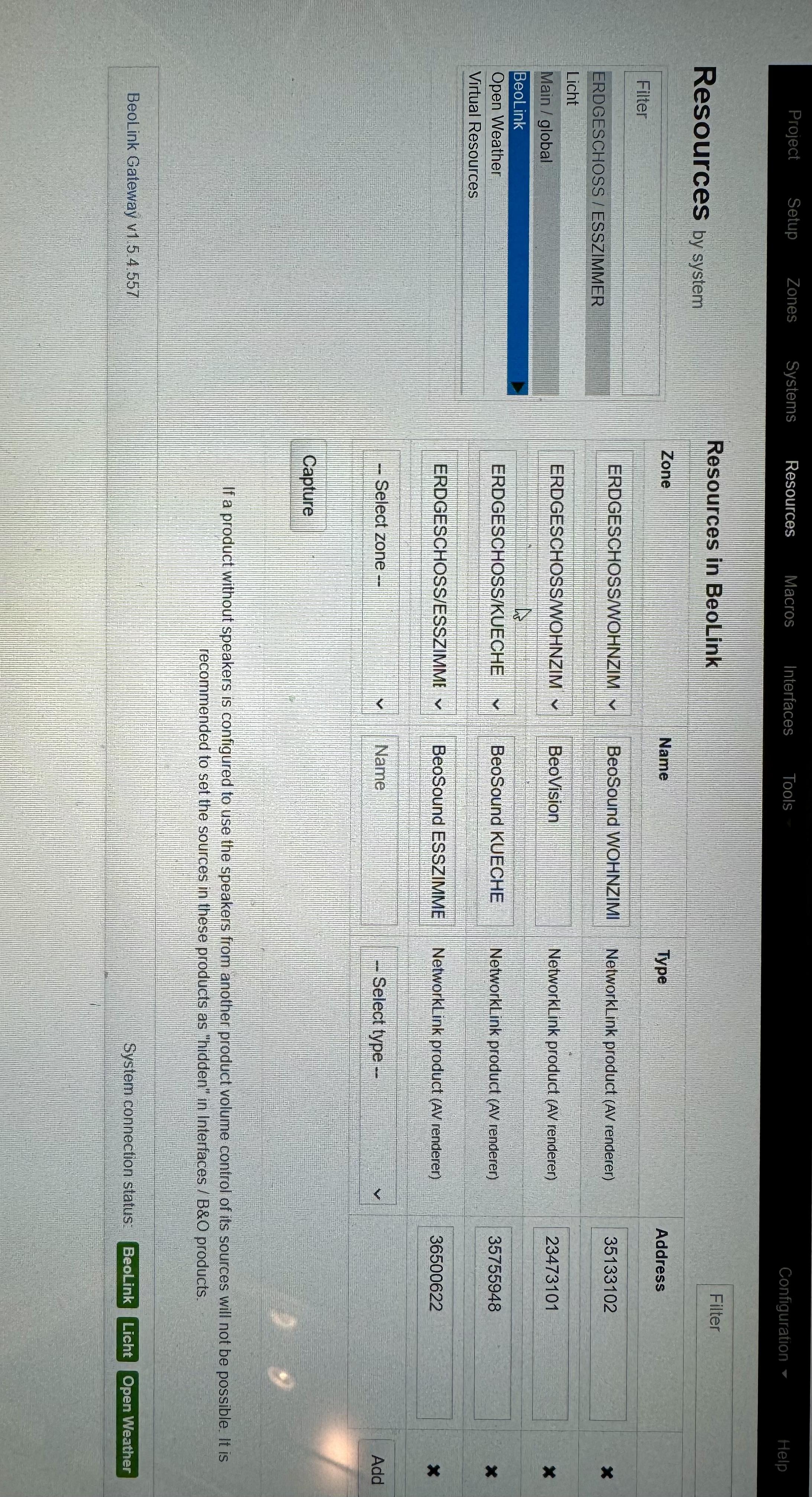

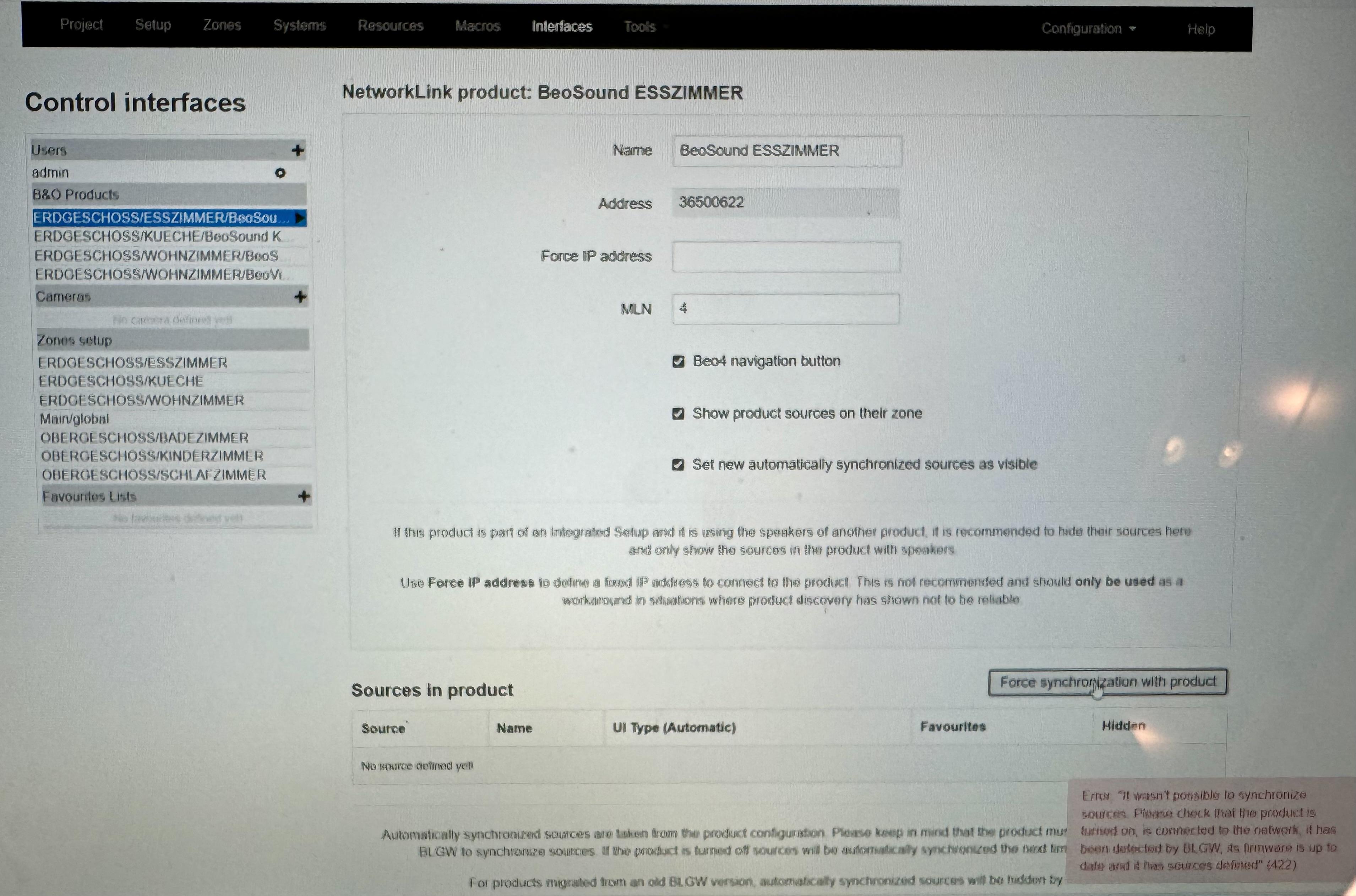

    They are seen by the BLGW but it looks like they won’t synchronise. They are on the same network and the Beolink NL/ML is also seeing the sources. So it has to do with the BLGW. Is there something I missed?
    I assigned them via Ressources to the Rooms but then can’t see the individual resources in Interfaces.IMG_5911IMG_5908

    So I managed to get the BeoSound Stage, BeoSound Core and BeoVision 7 to work.
    i am now trying the light switches but I think I understood the logic.
    The thing that won‘t work is the BeoSound Level and Emerge. Is the Motart Plattform not working with BeoLink? I can‘t see any source in the BeoLink Gateway from those devices and they don‘t show up in the BeoLiving App.
