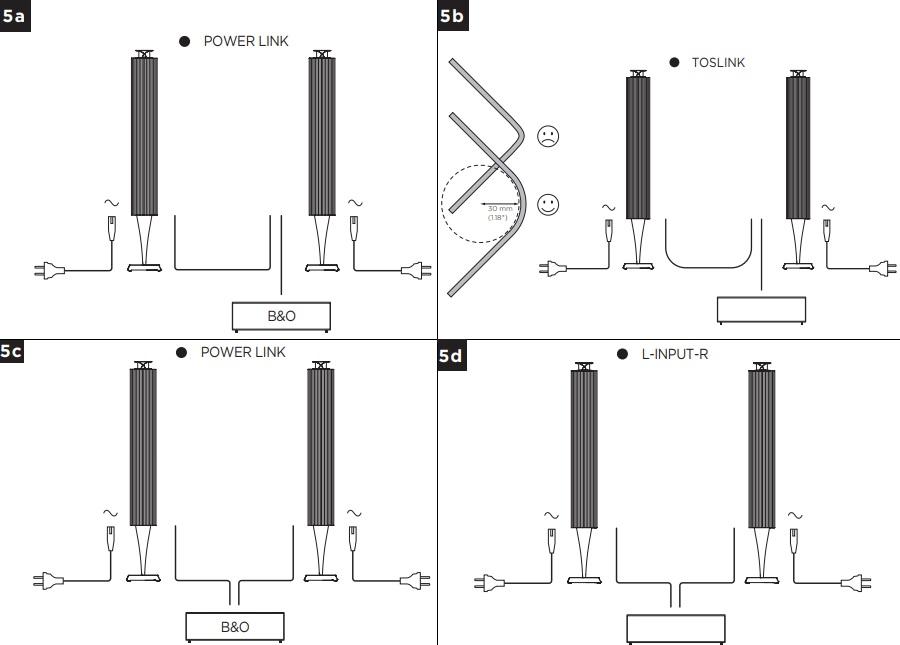

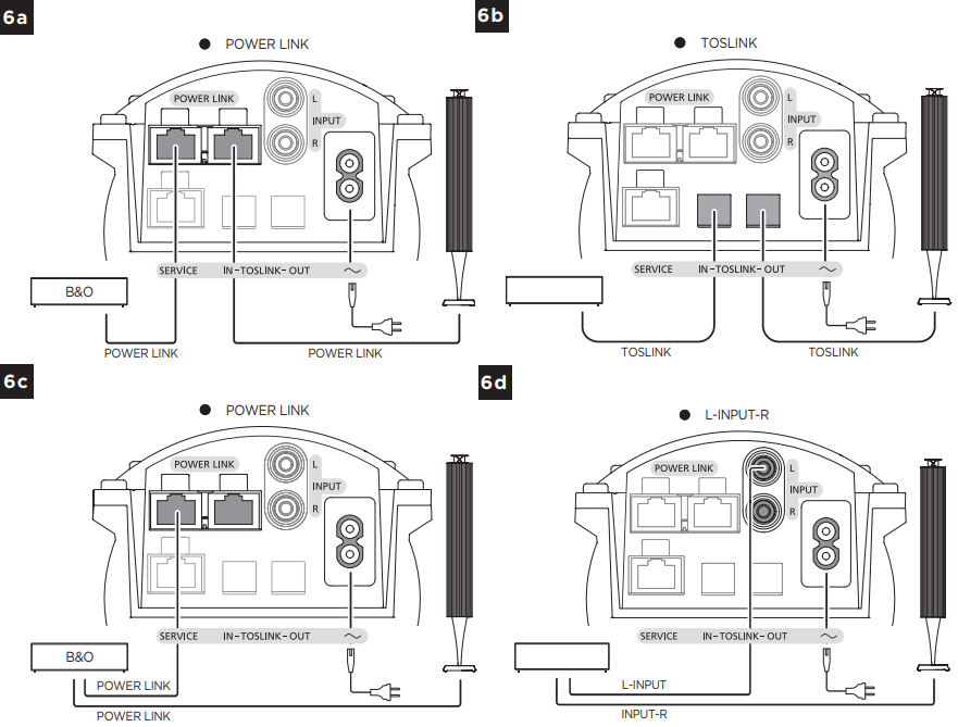

    in reply to: About Beolab 50 #46256
    NQVHNWI
    Hi Yann,
    If I perceive your setup correctly, assume the BL50 is the same config process as the BL90s then this is what I would try do do:-
    1. Config the hardware as the photo below
    2. Connect Legacy B&O to the BC2
    3. Connect the BC2 to BL50 via Coax. Dont use the Core. I think it may confuse things for me.
    4. Set the BL50 as per the photo below.
    5. Buy or use a Beo4 to control the BC2 and Legacy B&O
    Reasons to use a Beo4. The BR1 is ideal for BT enabled products but its quite a thumb work out to get it into IR/Beosound mode ans back out to use the Theatre. When Using the Beo4, I am not 100% whether the Coax will carry volume information. Rather than have yet another remote (the Halo is excellent for this, the Essence a bit laggy), an Beolink Eye into the BL50 may volume control for the Legacy B&O?
    I think this solution possibly gets rid of the Core as I can only see it as a very expensive BT receiver for volume control via the BR1. However, the problem of controlling legacy B&O will remain.
    On the BL50 setup, go into the configurator (or the BL90/50 app) and change the input priority. For my Auralics, I use XLR but I configure it subordinate to Powerlink and automatic selection. The XLR triggers on a voltage input, Coax and SP/dif trigger on digital signal. You need to put a kill-time (I think 60 seconds is minimum, otherwise, the BL50s may switch off and back on again with every track change or skip?)
    This is what I would try. It may not work, it may not work to your priorities….
    Edit: Just looking at the BL50 white paper, the BL50s have only one PL socket…which will be reserved for the Theatre PL in, (then DPL out to the Slave BL50).
    It may not work or sound good but I wonder if you can use a B&O RJ45 splitter box (in reverse) i.e. connect the Theatre PL Fronts and the BC2 Powerlink output into the 2 RJ45 output sockets, and feed the RJ45 Input socket of the box into the BL50 PL input.
    The Theatre still sends sound and volume control, the BC2 send on volume control (sound via the Coax/SPDif). This possible solution only gets rid of the Beolink Eye but it may cause unwanted problems in terms of volume control with the Theatre??
