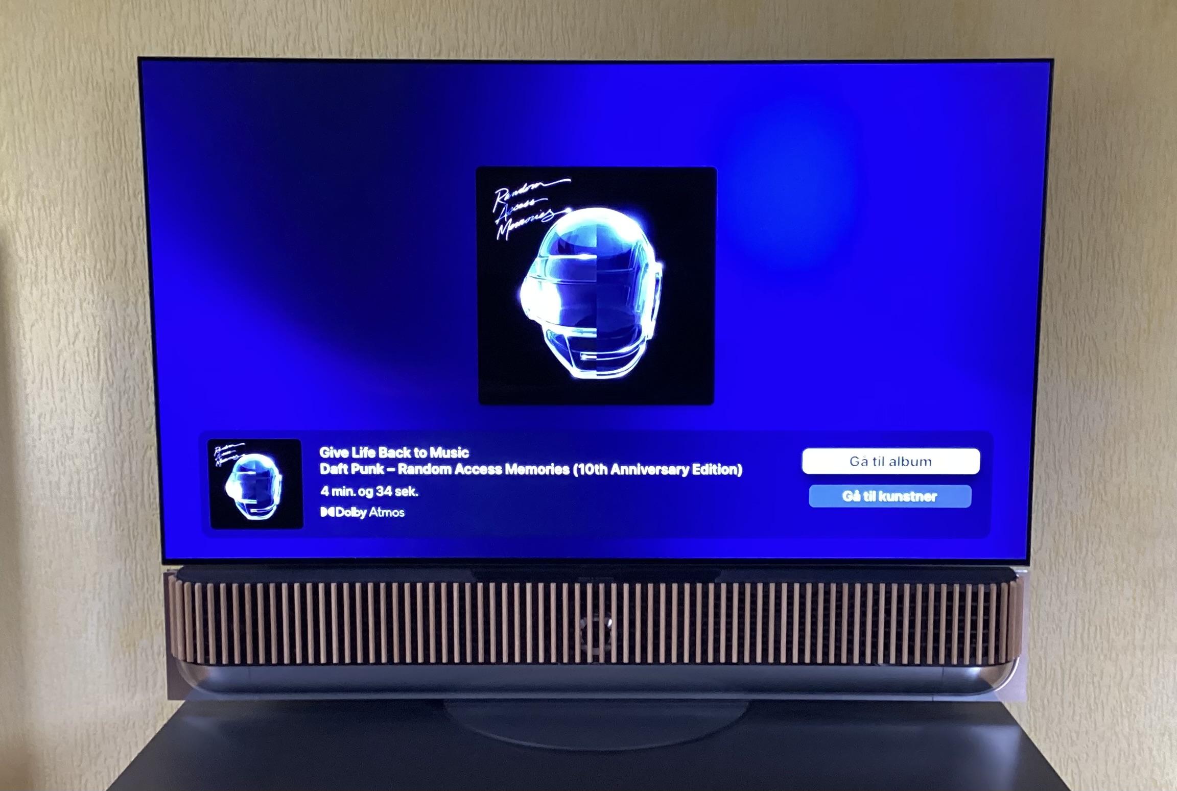

    in reply to: beovision Harmony 97 #46749
    Millemis
    Big!!!
    IMG_2448
