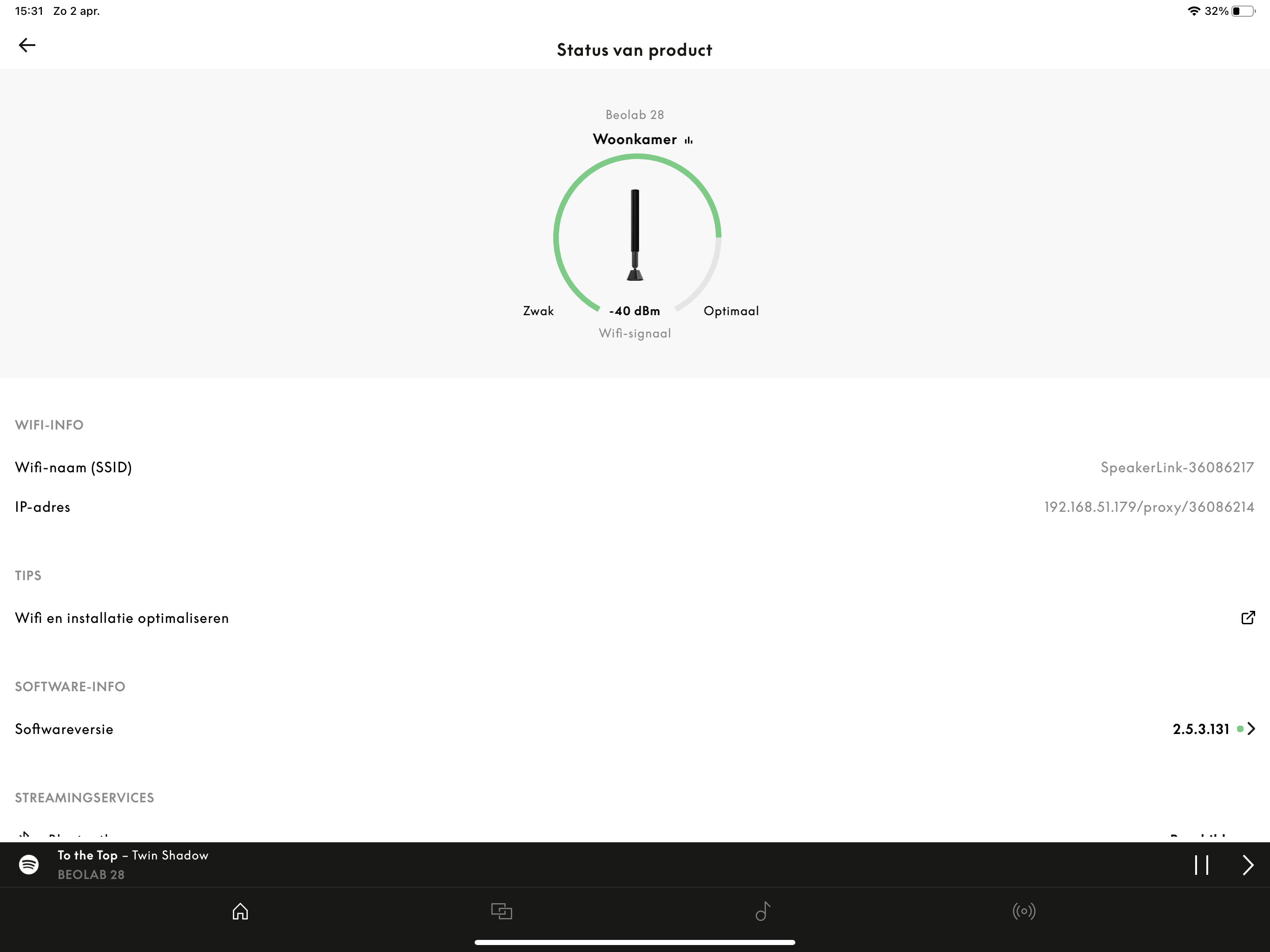

    I’ve updated my setup with two Beolab 28’s and set them up as fronts.
    Sound is amazing what a upgrade from the beolabs 9.
    I do however run in a problem. Whenever i just stream music too them they work fine (coupled with WiSa)
    But when i use the theatre coupled through WiSA with the beolabs 28. The signal sometimes just drop, you can hear it clearly it does pick it up again in a second though. However the connection is completely stable according to the configuration view.
    Any ideas why this would happen? Theatre is connected through Wifi as the Beolabs 28 are. Only other device between the 2 beolabs are the Apple TV (Wifi aswell)
    I have a Mesh setup which is super stable so i can’t imagine any problems with that. Seems something from the Theatre itself. I can connect the Theatre with a network cable if needed. But who know might be a software bug?
