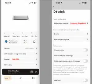

    The speakers sound great right from the start. Are they connected correctly? I used a PowerLink cable; it’s hard to go wrong 😉
    The speakers are visible in the tab:
    Sound -> Connected Speakers -> PowerLink (photo attached)
    Below, there’s also an “Other” option, presumably for connecting speakers from other companies. The BEO 18 speakers are also visible there, marked with a checkbox that can’t be unchecked.
    As I mentioned earlier, the only time the speakers were visible on the “first screen” of the Beo Connect app was when the app had an error and removed one of the connected BEO 18 speakers. Then, on the app screen, I saw:
    1x BEO 18 and 1x Other company speaker.
    Best regards
