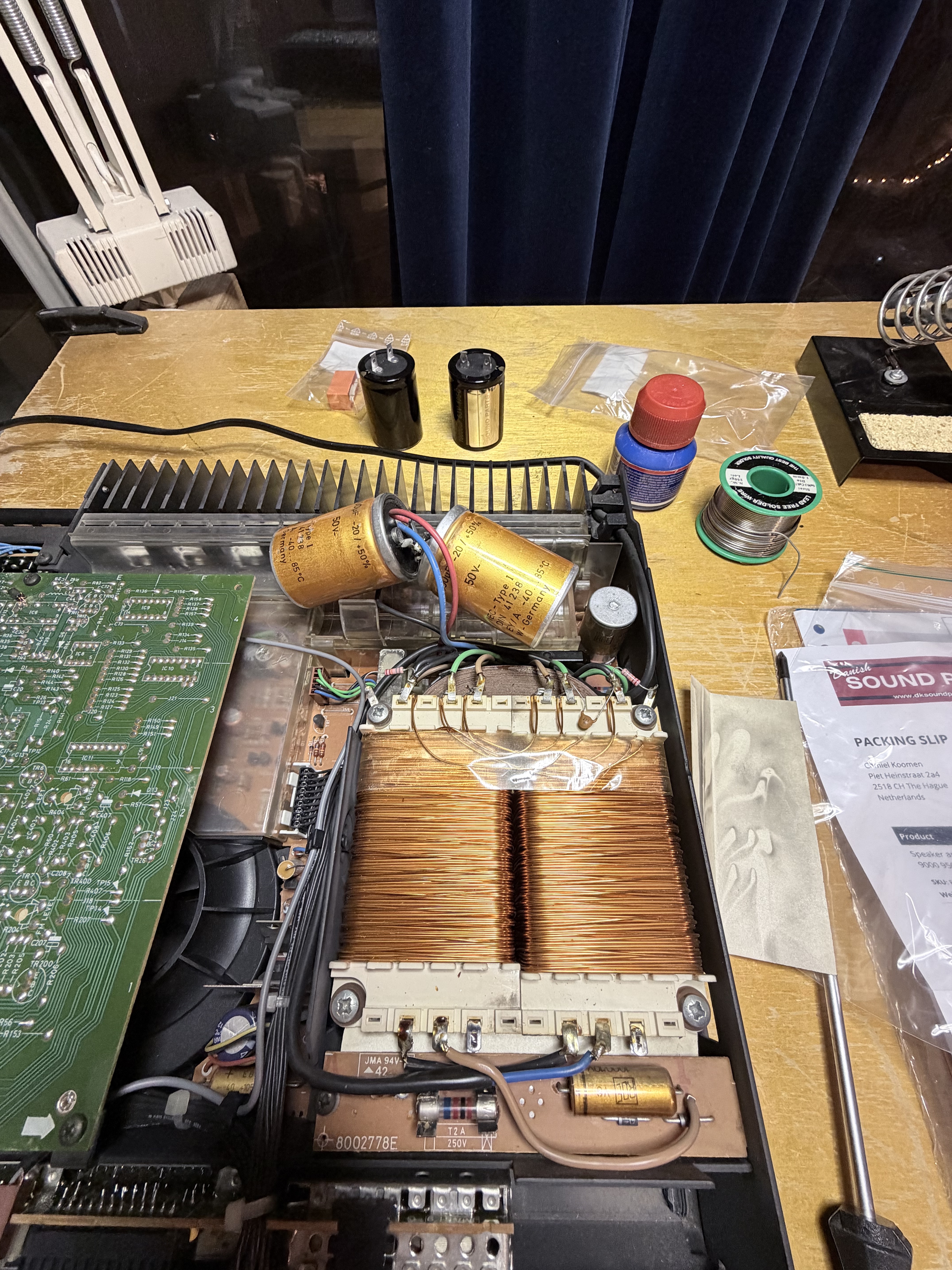

    Camiel Koomen
    Working now on a beomaster 6500. Setting voltage to 240 V, adjusting trimmers, replacing the big power supply caps. Maybe I will replace the relay for power, the one for muting looks good, but the output one is corroded and I see some heat damage on the board in that area as well.
    I might have to do a full recap but I couldn’t find a kit, if someone knows where to get all the caps in one go that would be great.

    Guy
    ^ Great work Camiel, and welcome to Beoworld!  I’ve always admired how much electronics is squeezed into the BM6500 packaging – but that must make it difficult to work on.  One day I hope to get hold of a white one to match my BG6500.
    Danish Sound Parts (one of our sponsors) do sell some spares for the BM6500 but I can’t see a capacitor kit unfortunately.  Good luck with the project!
