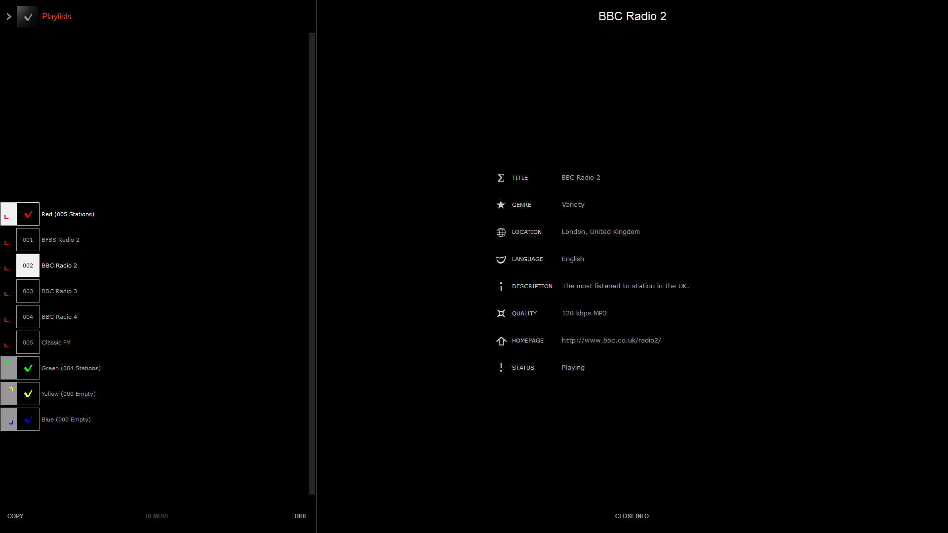

14 July 2023 at 10:10 #47197 GuyModeratorI just checked BeoPort and BBC radio stations are playing on N.RADIO – sort of…
However, they seem to play for a while and then cut out. If you look at the N.RADIO Info page it changes from this (with a status of ‘Playing’):
(as always, click to enlarge photos so that you can see the relevant text)
To this (with a status of ‘Finished’ – not seen that before!):
To re-start the station playing, you have to change to another station and then back.

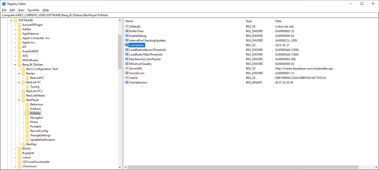

14 July 2023 at 10:40 #47198 GuyModeratorI checked the Registry and the ‘LastUpdate’ field is now showing ‘2023-02-21’. Previously it was showing ‘2021-11-15’.
I am not sure when it updated to my computer. I just ran the Registry updater again and it stayed at 2023-02-21.
Location: Warwickshire, UK

GOLD MemberMy database shows 2021-11-15. I tried running the database updater, it said successful but made no difference. Paul
