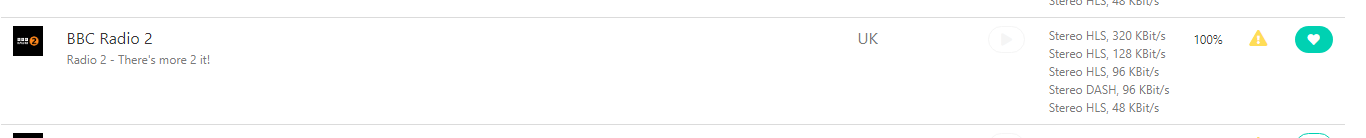

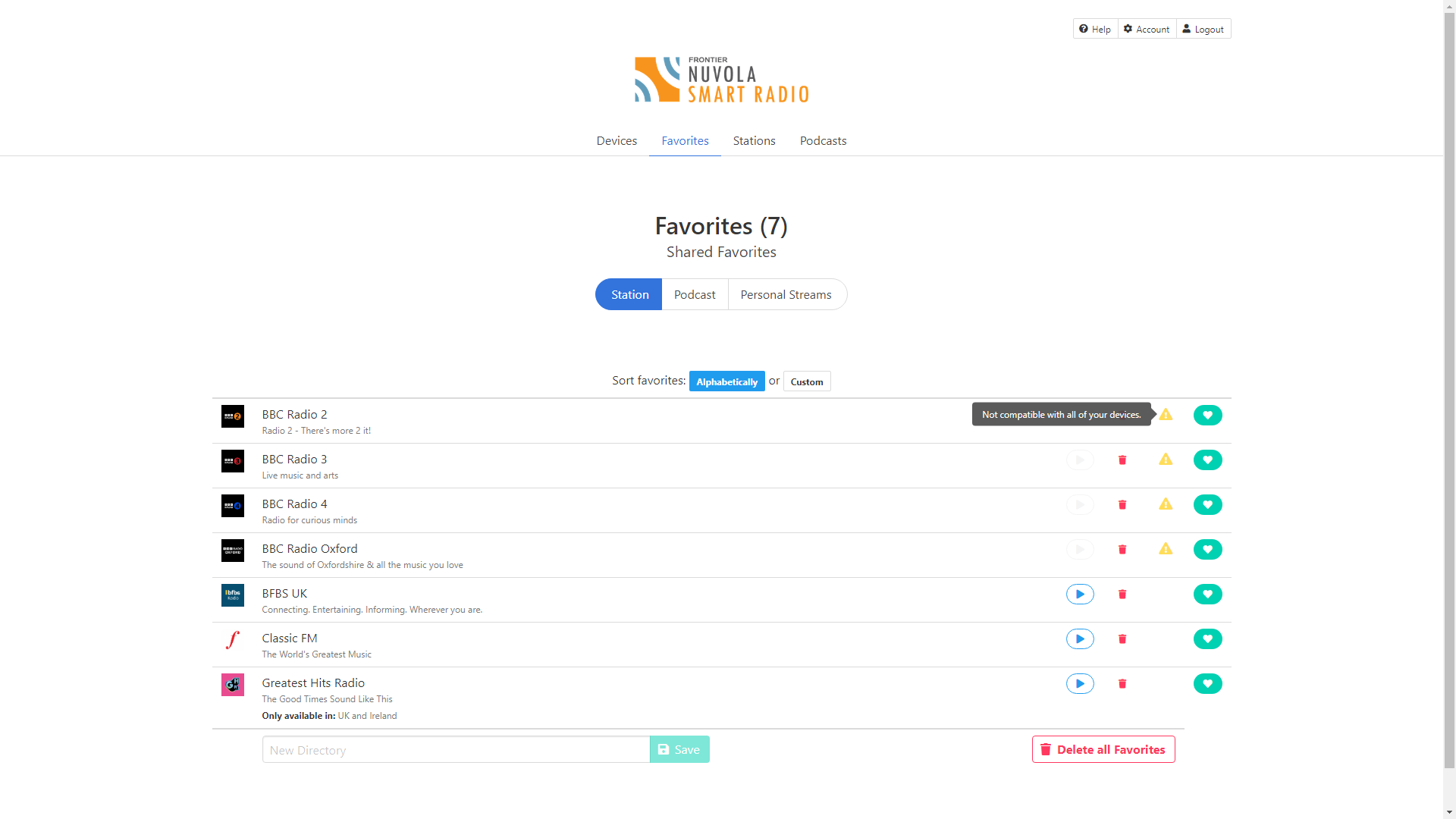

21 June 2023 at 14:11 #47178 Guy
ModeratorNot really related to N.RADIO or Net Radio (as the thread title) I today thought I’d check whether my OneRemote (International Receiver Company) radio can still receive BBC internet radio. I bought this when I lived overseas to access BBC radio, hence haven’t used it recently because here in UK I can listen to BBC on FM.
Anyway, here’s the outcome:
So clearly the answer is ‘no’. I confirmed this by logging into the Frontier Nuvola Smart Radio interface, which controls the stations that I listen to on both this and my kitchen radio (a Hama IR110). As you can see, the interface knows that one of my devices is incompatible with the listed BBC stations, although the Hama kitchen radio still plays them without problem. (click to enlarge)
Luckily (for when UK FM is switched off) my OneRemote radio has the option to play DAB, albeit the quality is lower compared to the previously available BBC internet stream. I just tested and it works well with full (direct or indirect) Beo4 control.
So yes this BBC stream re-shuffle is causing a few headaches (more than just N.RADIO and NetRadio) but nothing insurmountable so far!
Location: Warwickshire, UK

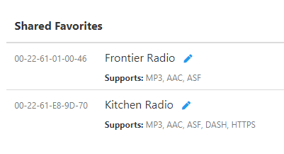

21 June 2023 at 15:45 #47183 Guy
ModeratorFurther stream details from my Frontier Nuvola Smart Radio interface:
This shows what my two devices support – the top one being my OneRemote radio that does not work with BBC. Kitchen Radio is Hama IR110.
And this shows the available streams from the BBC (click to enlarge):
