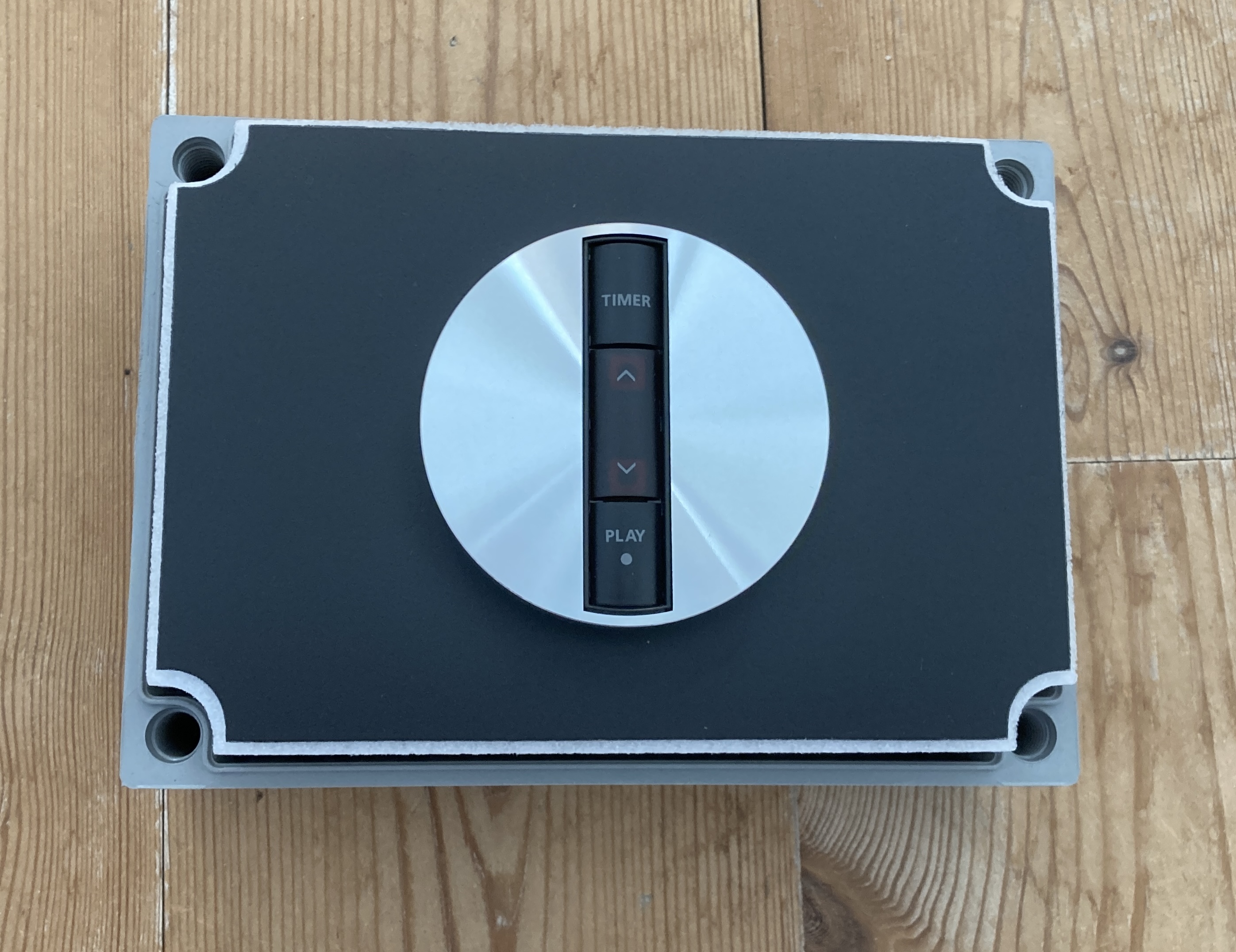

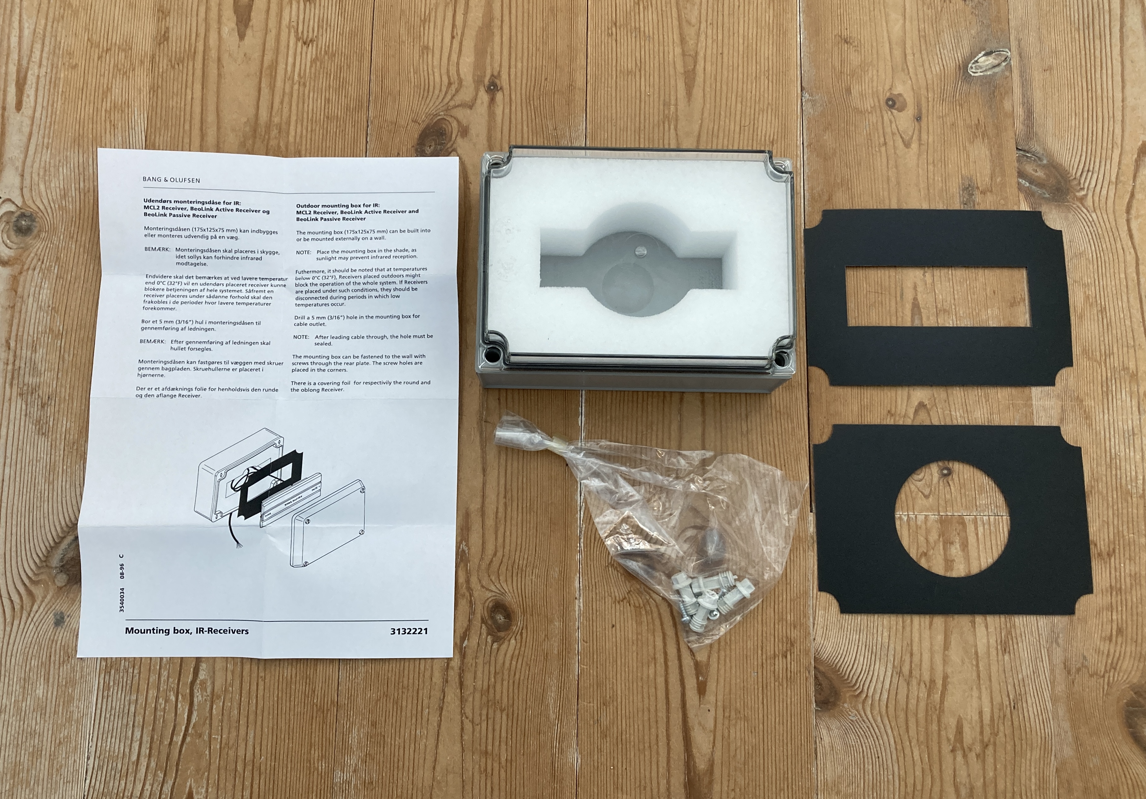

One of the items in the Box was this Mounting box IR Receivers that was intended for outdoor placement of the IR receivers for MCL2 or ML link based products with an external IR eye. I have only seen it in B&O spare part catalogs before, so thought I would share how the product looks with others.

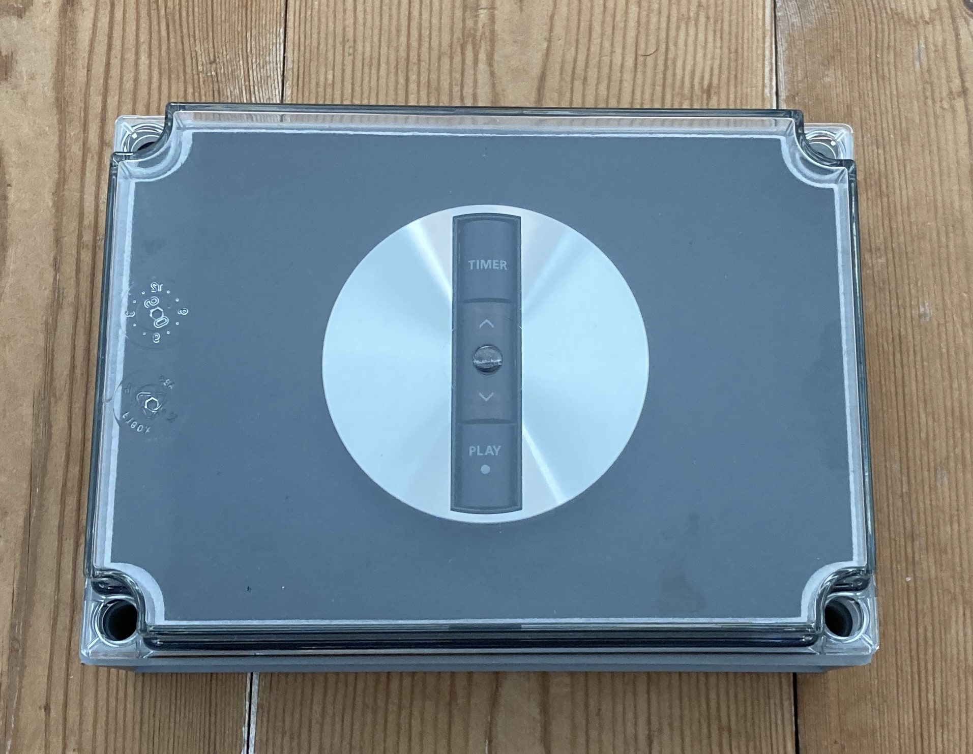

The foam insert in the box is made so it can house either the rectangular MCL2 IR receiver or the round ML IR receiver. to cover the foams is to pieces of black foil with a rectangular and a round hole respectivly.I my opinion this product is not very B&O like and seems to be more function over form. For example the clear plastic front has casting residue just in the middle of the IR eye. And also the production date is cast into the front of the clear plastic in the left side of the box. Not a very attractive look in my opinion. Also when the screws are mounted there is no way to use the buttons on the IR receiver, so you will need to use a remote that is not weather protected if you forget it outside.One last complaint about the design is that the foil parts are not large enough to cover the white foam. It might be clearer to see in this picture without the clear plastic front.The mounting instructions says it should be mouted in shade to improve IR reception. It does not say anything about rain or IP classification for that matter, so not sure how water proof it is. There are no sealing between the box and the clear plastic front.So all in all not a B&O product that I am very impressed about, and also do not have much need for so I might just sell it on.Location: Denmark

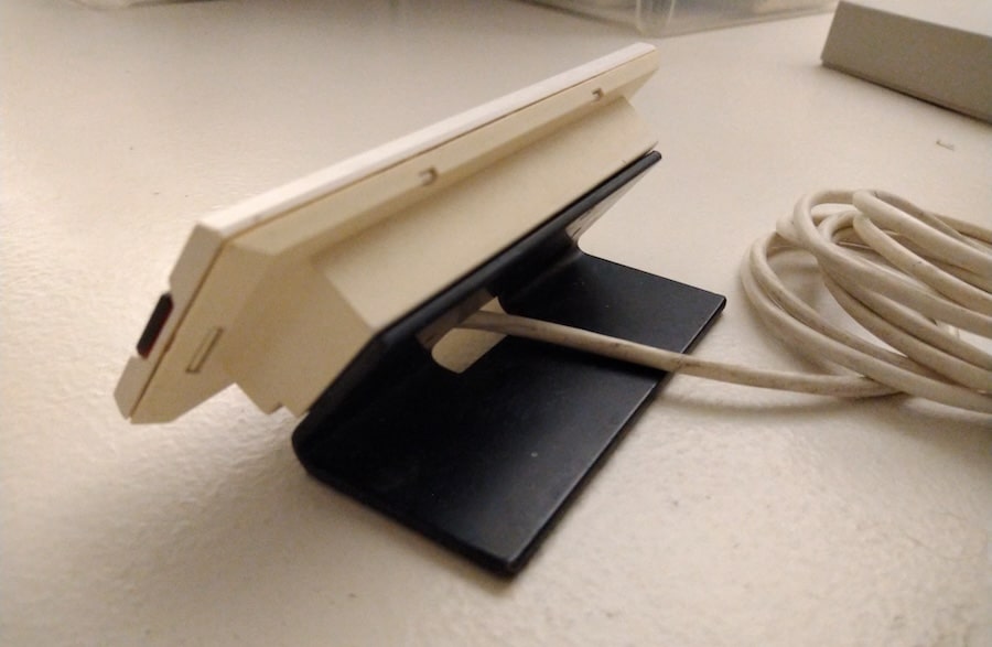

22 September 2025 at 18:16 #69851 lausviSILVER MemberI believe I’ve seen somewhere a description of adding a switch to one of the MCL lines to disconnect a unit cleanly.Related to the accessorie, I was happy to find this desktop mount for the ‘oblong’ transceiver (in this case a white one) some years ago. I think it looks quite nice sitting on an angle.Location: Helsinki - Finland
22 September 2025 at 18:52 #69852Madskp
GOLD MemberRelated to the accessorie, I was happy to find this desktop mount for the ‘oblong’ transceiver (in this case a white one) some years ago. I think it looks quite nice sitting on an angle.
Yes thats a nice assecory. I also have one of these in my collection
