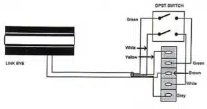

No, but I think there is a circuit description of how to make a switch for that in some of the MCL documentation, so B&O did something to make this solution plausible.
Here it is – basically isolates the power and data connections:
Picture extracted from here (half way down page):  https://beoworld.org/wiring-diagrams/
