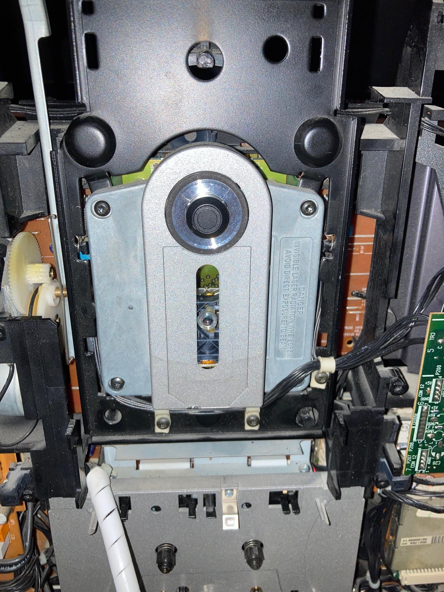

    I tried the test mode and one thing I noticed is when I try to move the laser arm to its extreme outside position i will end in the position shown on the below photo.
    IMG_9306
    When I open the mechanism up I can move the laser arm way further down, by rotating the motor manually. So I guess something is hindering the movement.
    Anyone has a hint to what that could be? nothing mechanically as far as I can find. The gears rotate freely all the way

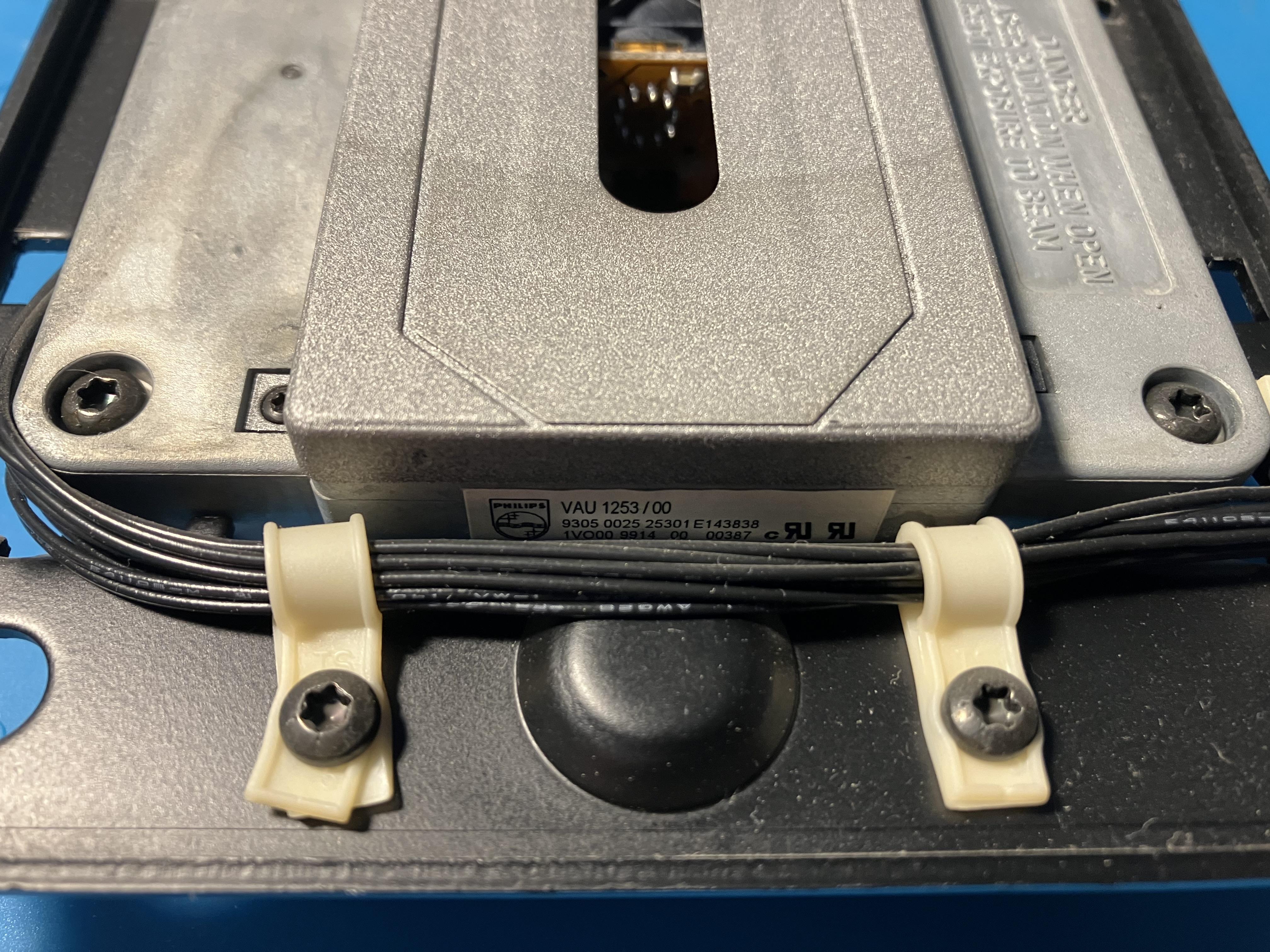

    So I took the BC2300 apart today, mainly to check the CD version and the SMD capacitor values.  I may do a fuller write up at a later stage, but here’s a few photos of what I have to play with:
    CD mechanism label shows Philips VAU 1253/00:

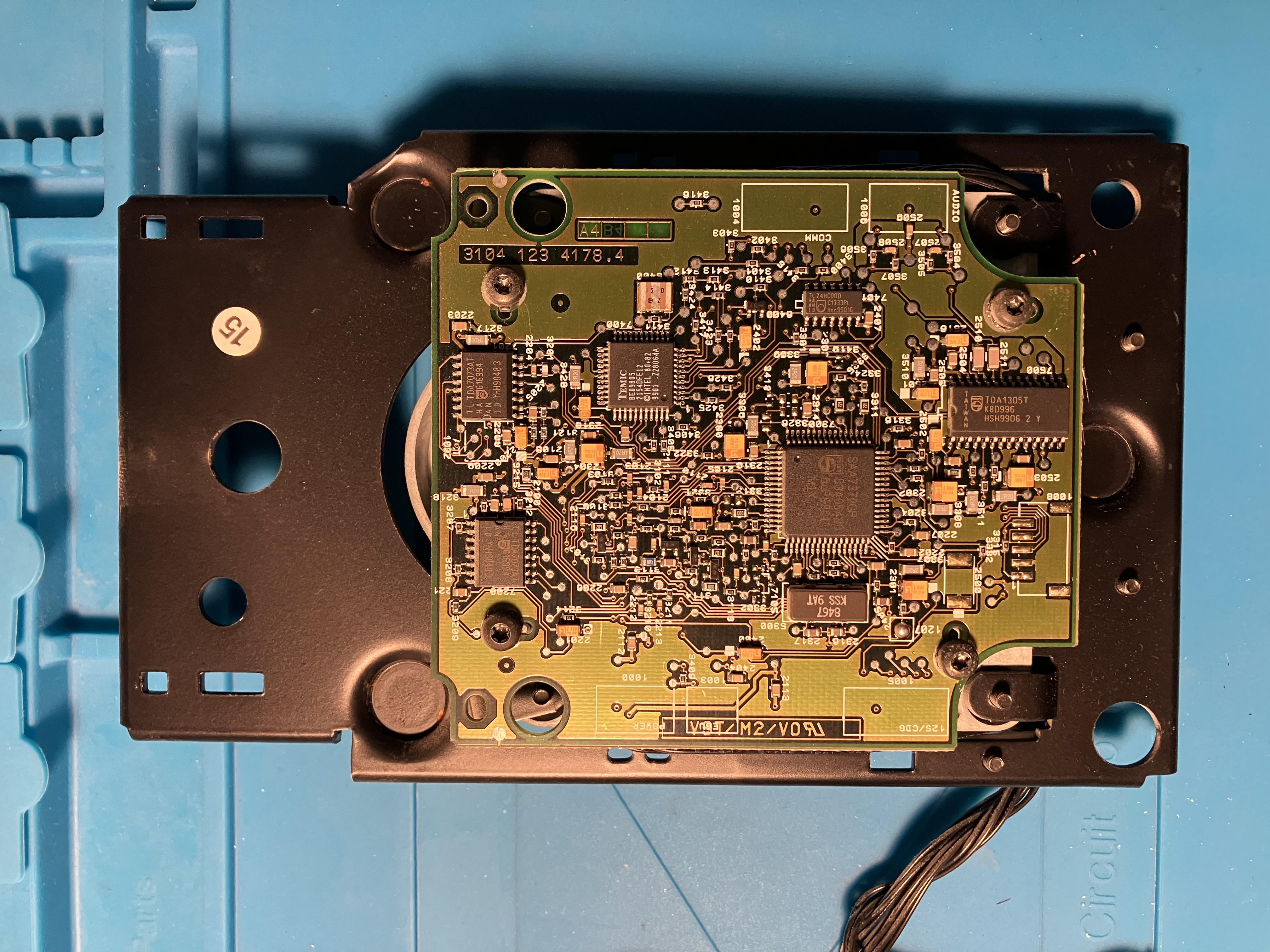

    Servo board ‘chip side’ – search identifies as CD Pro (also called CD Pro 1, apparently this was fitted with the SAA7372 chip to perform both decoding and servo):
    IMG_7941
    And Servo Board SMD capacitor side – no doming of SMDs or leakage visible.  Label states CDM12 IND, where I understand that ‘IND’ signifies ‘industrial’ supplied by Philips to other OEM manufacturers, such as B&O.
    IMG_7946
    And finally reverse of CD mech with servo board removed:
    IMG_7945
    I have partially re-assembled the BC2300 now to check that I didn’t break anything else, and the CD still fails as before.
    I had a look through a few Beoworld service manuals and can’t find a CD Pro PCB diagram that exactly matches mine (in terms of chip layout), but I will go ahead and order replacements for the SMD caps based upon observed values, which is probably the safest option anyway!
    If SMD replacement doesn’t fix the fault I will probably try a replacement laser from Beoparts, as I think theirs will be compatible.
    Comments/suggestions welcome!

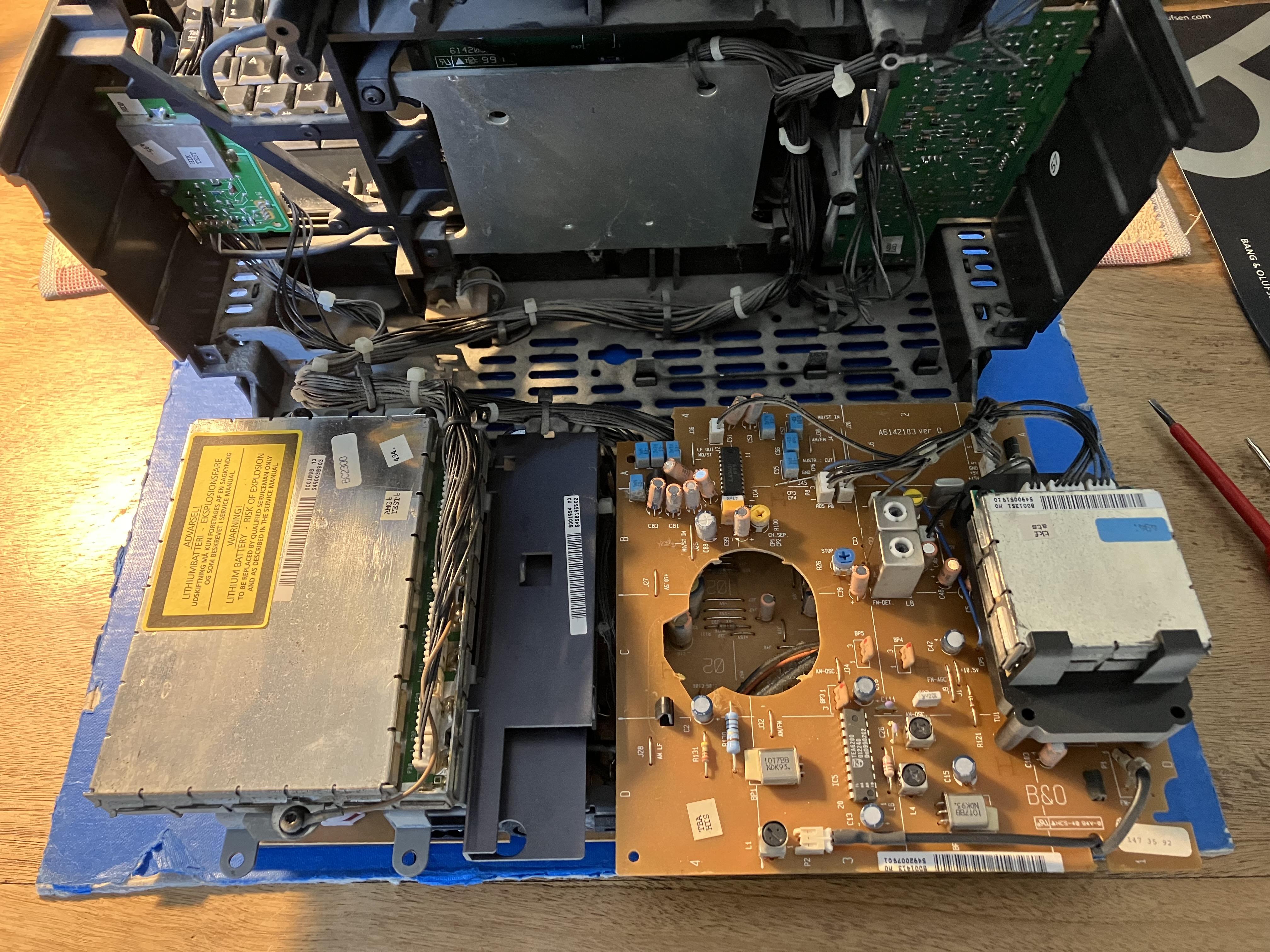

    #50381
    Guy
    Thanks both!
    My other BC2300 (older two-way, curved laser model) arrived in the middle of a Bavarian winter and I think had been dropped in transit.  Inside was a mess and I spent a great deal of time rebuilding the plastics inside.  I posted about it here:  https://archivedforum2.beoworld.org/forums/p/189/148906.aspx#148906
    This newer BC2300 plastic seems less brittle; I put PCB1/2 in the service position earlier today to give it a good clean inside, but when re-assembling those self-tapping screws that go into the plastic frame are always a worry!
    I have included a couple of fresh belts in my Beoparts order, and a new CR2450 battery will arrive with the capacitors!
