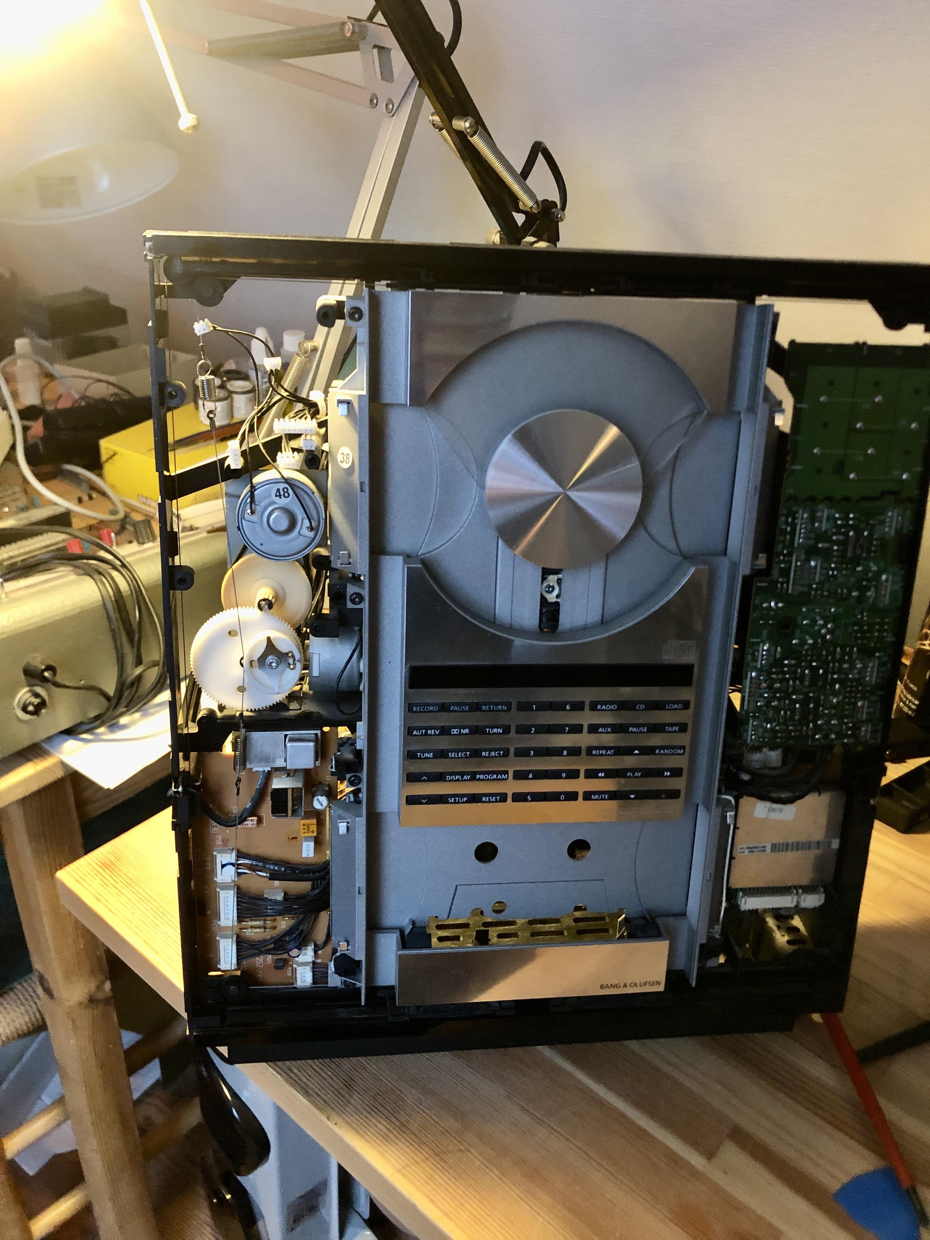

27 October 2023 at 18:32 #47769Madskp
GOLD MemberI have no started the adventure of fixing this system, and I must say that the BC9300 I recently did a repair on was far more accesible. But of course the design of the ouverture is way more compact.
I started with the belt for the doors and even though I tried to avoid it I ended up having to rewire the strings for the doors. Not entirely sure I got it right as I didnt take before pictured.

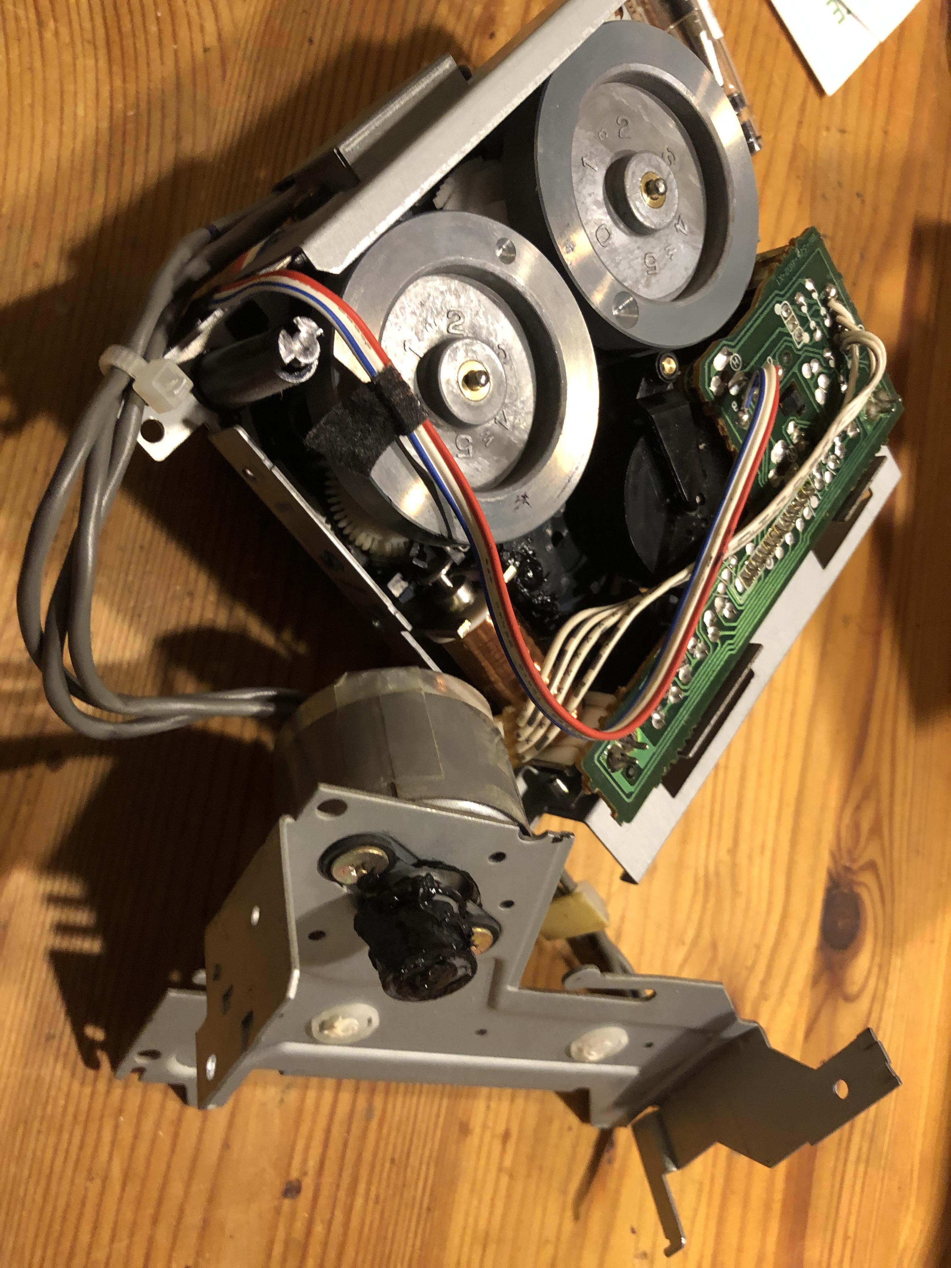

Next I got to the casette deck belt. The old one was one chunk of goo, but I think I have it all removed now
Regarding the clamper I will also replace the belt, but I noticed that the arm was not connected to the whell anymore, so one extra detail
Location: Denmark
28 October 2023 at 15:23 #47770Madskp
GOLD MemberWorked some more on it today and got the string for the dooors correct now. It had slipped of one of the wheels in the lower left corner as might be seen in this picture althogh a little dark in that corner.
I have now tried to open and close the doors 10 times without issue and seems to be running as smooth as I remember it did last time I saw one of these in operation.
Also got the casette mechanism back in and it seems to be working mechanically. I have yet to connect a speaker to confirm fully working casette function.
Location: Denmark
