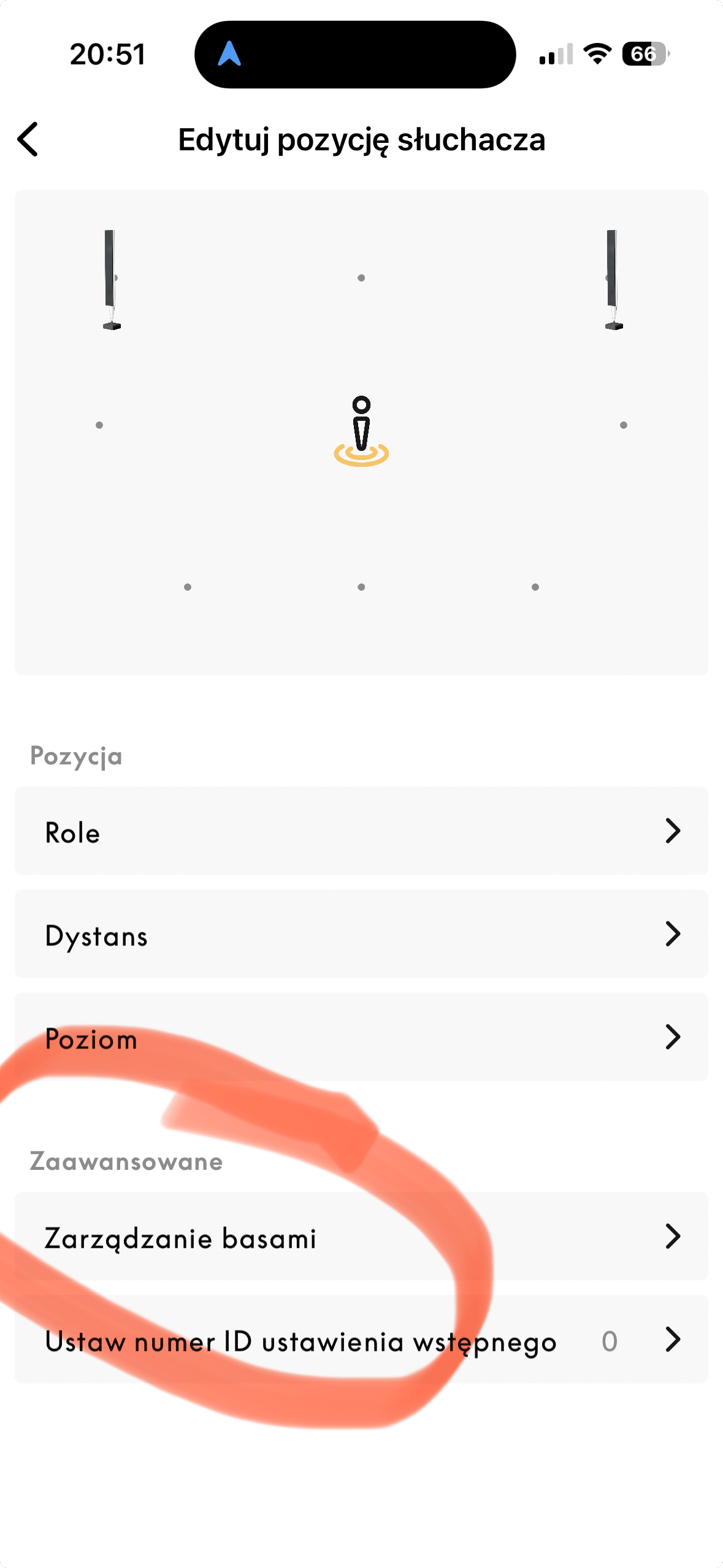

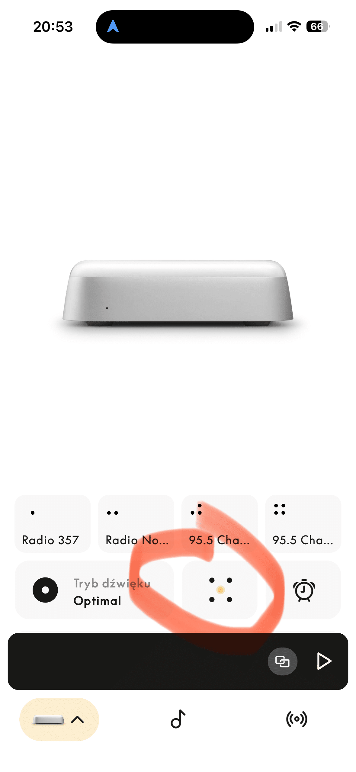

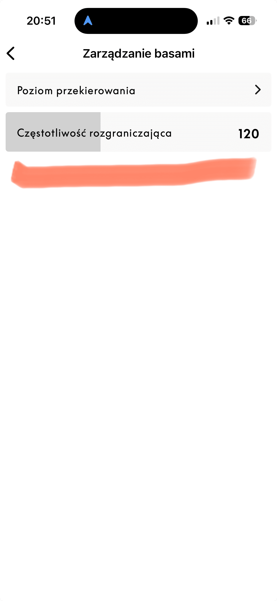

14 October 2025 at 20:09 #70467Bart99
BRONZE MemberHello, I’m no expert, but after entering the settings in Photo 1, proceed to Photo 2. The role of the connected speakers, e.g., Front Left Right, Distance from the listener, and then the level of the connected speakers. Below, there are two more options: Bass Management, and, as I understand it, there’s the cutoff setting in Photo 3.
PS. I don’t know how to switch to English to show you the English version.
