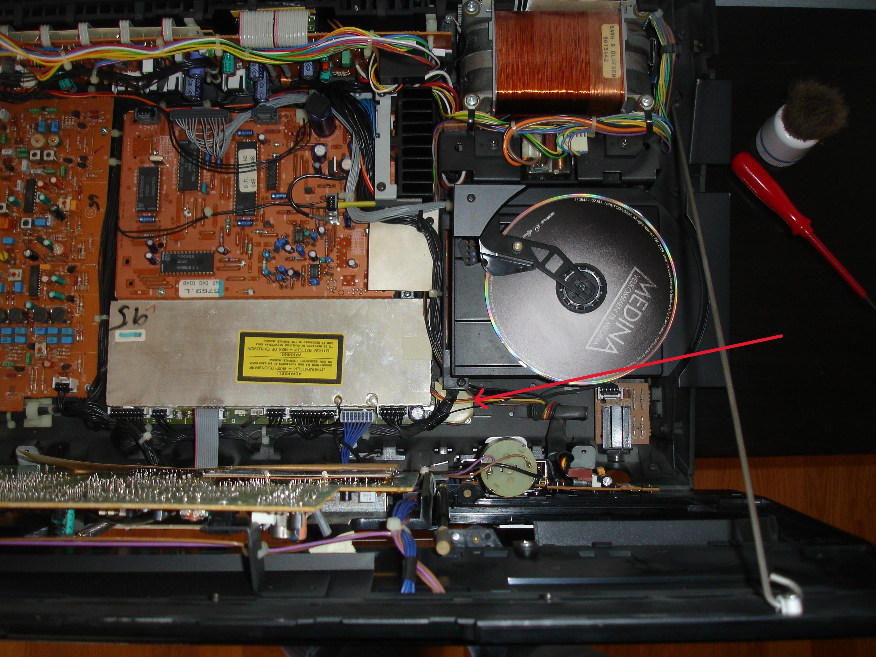

    If you wish to replace the battery, here’s a picture of the location (red arrow).  You need to be careful desoldering/resoldering lithium batteries – not too much heat and wear eye protection just  in case.
