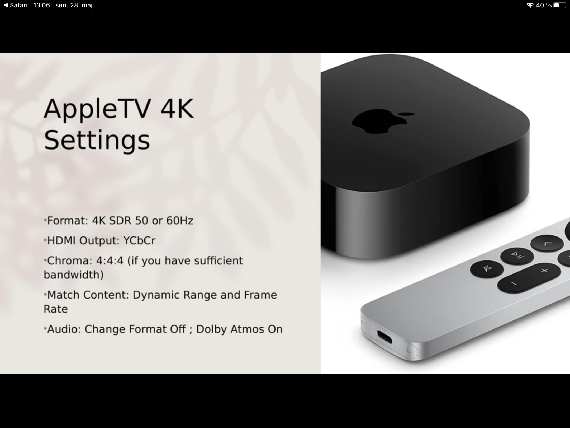

28 May 2023 at 12:30 #46815 MillemisBRONZE MemberThere are lots of videos out there how to set your ATV4K in order to get the best video quality.
This is an example of how these look:As I – now – understand it, your ATV is located in a distant room.
(This has nothing to do with the matrix, you also have)
Therefore you use the extender kit (Balun…).
It might be that this does not support the required bandwith for these settings.Best thing to do would be to relocate the ATV – if you possibly can – and plug it directly into the LG or the BST (with PUC) using a proper HDMI cable with at least 18 Gigabits per second speed.
