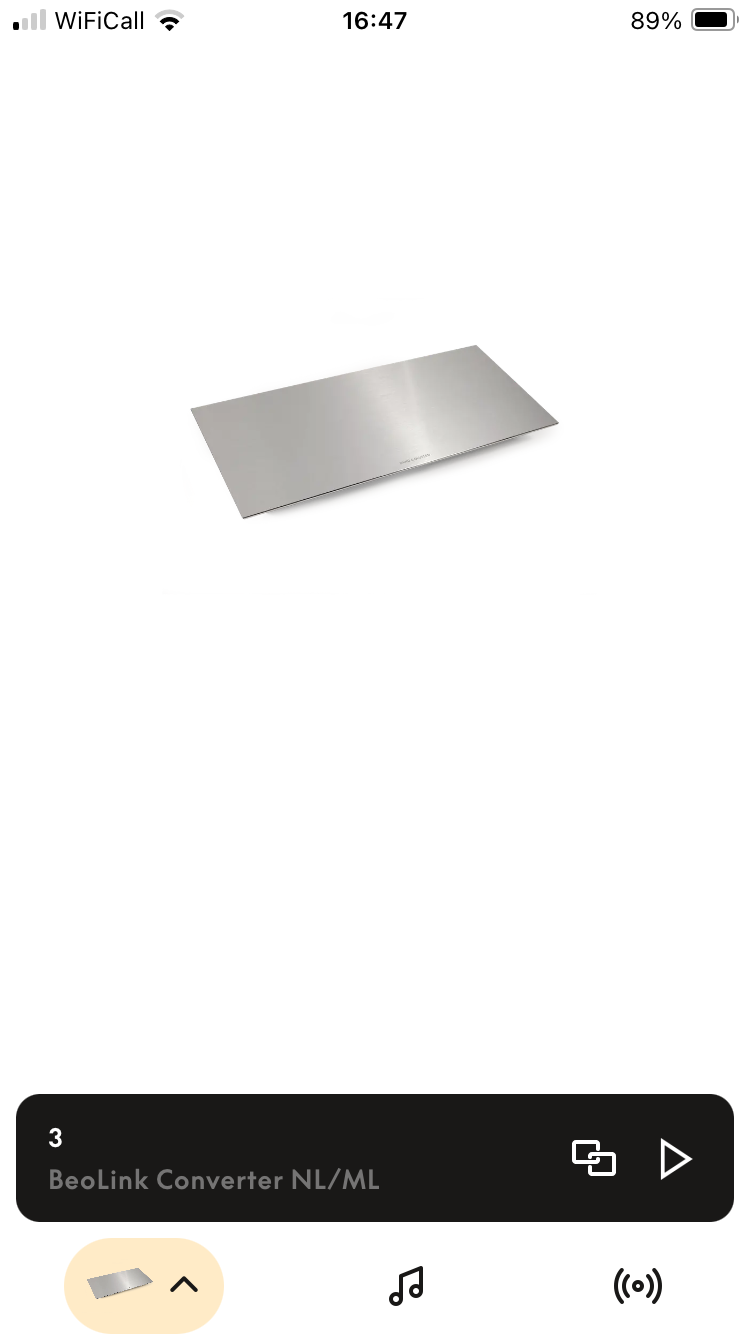

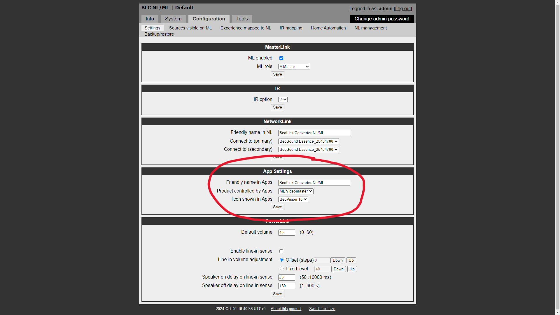

    I recently got hold of a NL/ML Converter and have been having a play.
    Currently it’s connected as an Audiomaster between my BV10-32 and Essence Mk2 (There are no other ML or NL devices attached, and no speakers or IR sensors connected to Essence).  It seems to work well and I have Beo4 control of the Essence (through the TV) and limited B&O app control of the TV – quite impressed that I can also control the TV volume using my phone.
    I have one question that isn’t covered in the NL/ML Installation Guide (version 1.4).  Half way down the settings page there are ‘App Settings’.  I have set the ‘Icon Shown in Apps’ to Beovision 10 as you can see below: (the other icon options are Beovisions 9, 8, 7 and 3)
    Screenshot (298)
    But I am unclear as to where to expect to see that BeoVision 10 icon.  All I get when using the B&O app to control the TV (via Beolink Converter) is a picture of the Beolink Converter, as you can see below:
    IMG_8847
    Am I doing something wrong, or is this a bug in the B&O app?
    Location: Warwickshire, UK
    #59660
    Madskp
    GOLD Member
    I have one question that isn’t covered in the NL/ML Installation Guide (version 1.4).  Half way down the settings page there are ‘App Settings’.  I have set the ‘Icon Shown in Apps’ to Beovision 10 as you can see below: (the other icon options are Beovisions 9, 8, 7 and 3) But I am unclear as to where to expect to see that BeoVision 10 icon.  All I get when using the B&O app to control the TV (via Beolink Converter) is a picture of the Beolink Converter, as you can see below:
    I have noticed this setting, but did not pay much attention to it for my test use of the converter. I think mine is set to Beovision 10, and in the App only the BLC NL/ML is shown as you have also noticed.
    Maybe more extensive users of the BLC NL/ML have more knowledge about this functionality.
    Location: Denmark
    #59672
    Guy
    I have noticed this setting, but did not pay much attention to it for my test use of the converter. I think mine is set to Beovision 10, and in the App only the BLC NL/ML is shown as you have also noticed. Maybe more extensive users of the BLC NL/ML have more knowledge about this functionality.
    Thanks for that confirmation.  I had a look through the Beolink Handbook v1.9 and ‘icons’ are mentioned with regard to the NL/ML converter (at the top of page 42).  I think the setting refers to the simple icons (rather than photos) that were displayed within the old (?) BeoMusic App when using Beolink Multiroom.  Perhaps the same icons are in the Beolink Gateway’s Beolink 2 app that was mentioned by Gregg above.
    Anyway it’s not important.  Overall I am very impressed with the NL/ML Converter so far and look forward to experimenting further with some of my older equipment!

    Rolf2
    GOLD Member
    In the old BeoMusic App the BV 10 is displayed as an icon. In the new app this functionality seems to be no longer active, as I, as well, get only the BLC on display.
    I have not set up my BLGW properly for all my rooms, yet. However, for those I did, I get e. g. the BS 9000 icon in the respective room, either in the BeoLink 2 or in the BeoLiving app. So I guess, it is likely to get the BV 10 icon as well in both of them.

    Guy
    In the old BeoMusic App the BV 10 is displayed as an icon. In the new app this functionality seems to be no longer active, as I, as well, get only the BLC on display. I have not set up my BLGW properly for all my rooms, yet. However, for those I did, I get e. g. the BS 9000 icon in the respective room, either in the BeoLink 2 or in the BeoLiving app. So I guess, it is likely to get the BV 10 icon as well in both of them. Kind regards, Rolf
    Thanks Rolf – that’s useful to know and as I suspected.

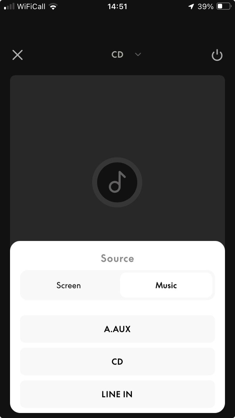

    Guy
    So today I am trying the NL/ML converter connected just to my BC2300 via a BL1611.  I have removed my Essence Mk2 from the setup (and B&O app) to avoid conflicts.
    The converter is set as a V Master and I have ‘experience mapped to NL’ the three BC2300 sources RADIO, CD and A.AUX.
    I can use the B&O App to select the BC2300’s CD (which starts playing) and can also select A.AUX which switches the BC2300 to AUX.  I can also power-down the BC2300 using the app.
    What I can’t do is select RADIO (the BC2300’s FM radio) using the App – as you can see below it doesn’t even show up as a Music source.
    Screenshot 2024-10-03 at 14.51.25
    I assume there is some sort of conflict between ML RADIO (which I want to be the BC2300 FM radio) and the B&O RADIO (effectively internet radio) that is part of the app.  Anyone know if I can change settings to access the BC2300’s FM RADIO via the B&O app?

    #59745
    Madskp
    GOLD Member
    I assume there is some sort of conflict between ML RADIO (which I want to be the BC2300 FM radio) and the B&O RADIO (effectively internet radio) that is part of the app.  Anyone know if I can change settings to access the BC2300’s FM RADIO via the B&O app? EDIT:  I have tried putting the BC2300 in A.OPT 0, and then adding an IR sensor to the NL/ML Converter – I have IR mapped the ML sources.  I can select all mapped BC2300 sources (including RADIO) using the Beo4, but the RADIO source still does not appear in the app.
    Not really sure, but what if you map Radio to another source in the NL/ML converter?

    #59786
    Guy
    I have tried that – or at least I think I set up up to try that!  I think the problem is that under ‘App Settings’ I have to set ‘Product Controlled by Apps’ to ‘BeolinkConverter NL/ML with speakers’, otherwise I am unable to control anything on the BC2300 with the app, even CD and A.AUX.  I think this is the problem/conflict because the NL/ML Converter expects RADIO to be ‘B&O radio’, but still looks for (and selects) CD or AUX on the ML network.  With the IR sensor attached to the Converter, if I open the B&O app on my phone, and then use the Beo4 to select RADIO (or an alternative mapped command), then the BC2300 does switch to FM RADIO, but the app on my phone changes source to ‘B&O Radio’.  The other thing I an unable to do is control the BC2300 volume using the app, whereas I could do this when the Converter was attached to my BV10-32.
    If I change the ‘Product Controlled by Apps’ to the logical option of  ‘ML Audiomaster’ I have no control whatsoever over the BC2300.  This could well be a limitation* of using a BL1611, which is effectively being the ML Audiomaster for the BC2300.   I still don’t have a true ML Audiomaster (with FM RADIO such as Ouverture) with which to experiment.
    Anyway, it’s not a big deal but it was fun experimenting with the control possibilities across several decades of B&O equipment! 😀

    carolpa
    You can integrate the BC2300-T1611-BLC and Essence mkII without any conficts.
    Somewhere down the line, they skipped the Radio sources from ML.
    Presumably to have the BLC setup in line with the Beoconnect Encore settings. The BeoSystem 9000c is using the B&o Radio source of the BL28’s and not the original BS9000 Radio source.
    Note: in the Beoliving app the original Radio sources are still available.
    workaround: if you add the Essence mkII to the setup, you could add the ML sources of the BC2300 as Essence mkII sources (In the Essence configuration: Link to other products; Connect to primary Beolink product; check the boxes for the available sources in Content-Sources-Local)
    Then it is possible to start the BC2300 Radio on the Essence mkII
