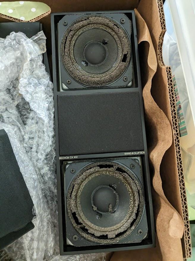

    in reply to: Beocenter 9000 + Beovox CX100 #48343
    paul_f
    Here are the speakersPXL_20230820_100456657
