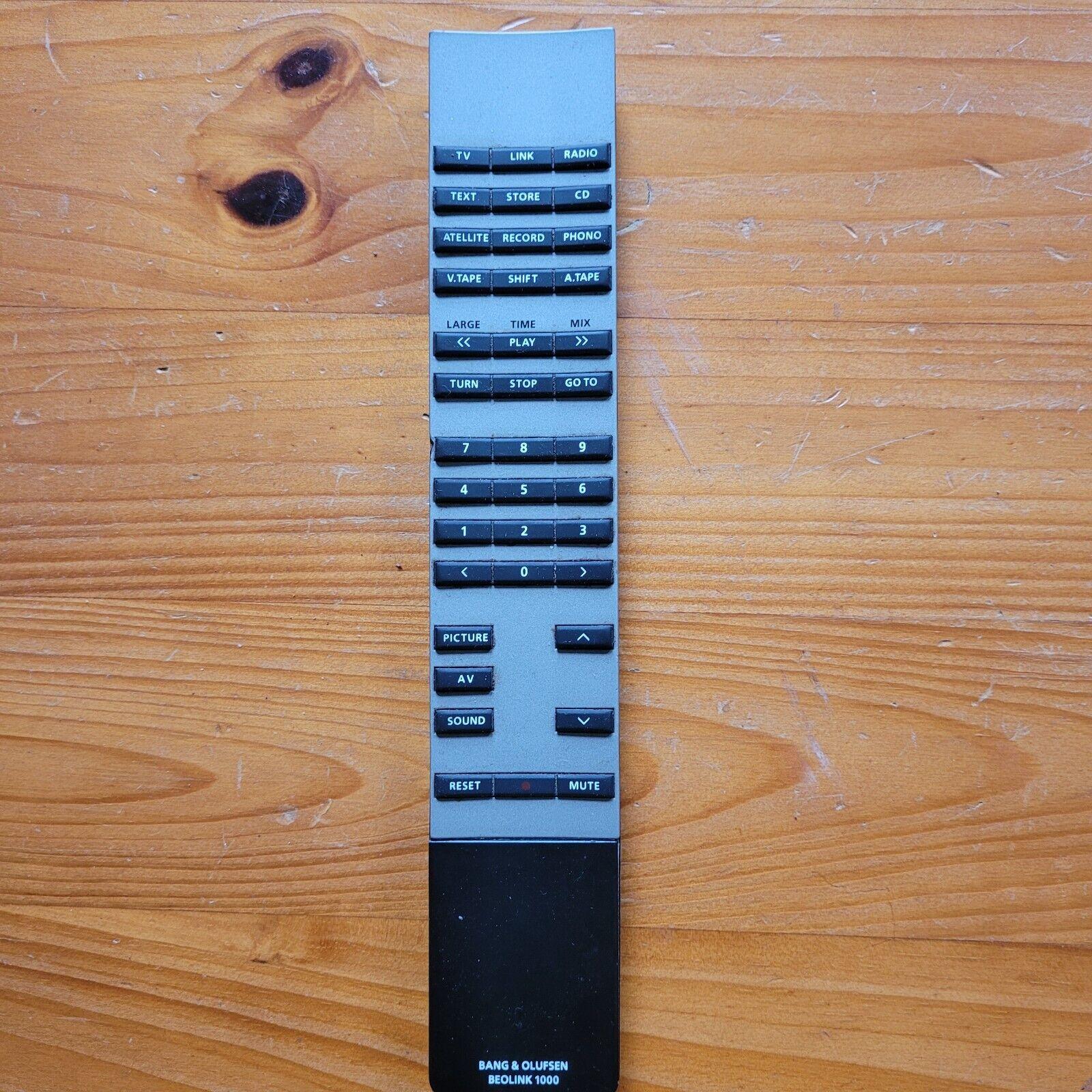

    I recently got a Beocenter 9000, Beovox CX100 and Beolink 1000.
    Beolink seems to work fine, just needs a clean
