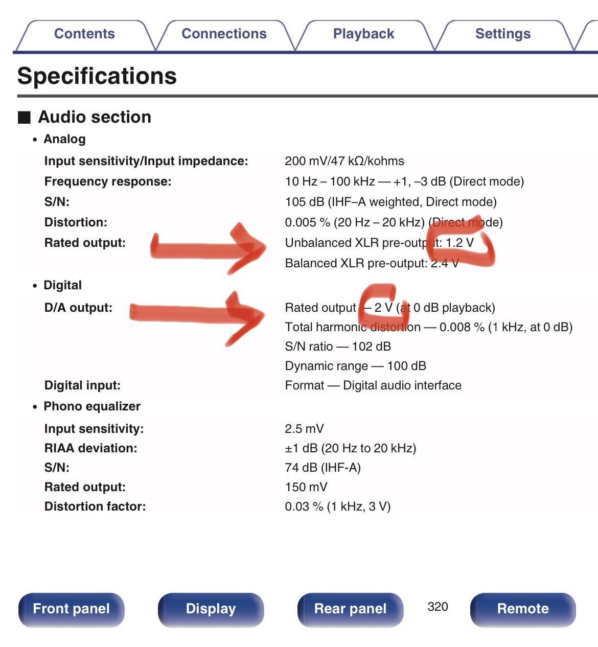

BRONZE MemberOk, I’m sorry to bore you up with these questions, at this point I’m mostly driven by the curiosity. Obviously I’m not knowledgeable in this field and thus here asking a “crucial” some clarification. Looking at the specs of my Marantz preamp that I attached with this post … at which output voltage should I look to? Is it 1.2V (unbalanced xlr) or is it 2V (D/A output)?
I would have thought that the latter is basically the same as the former until I saw different specs. I apologize for the confusion…

BRONZE MemberLook up the specs of your Marantz RCA output. As indicated above, hopefully the specs say something helpful / similar like for my Linn i.e its RCA is max 2V at 80 (linn) volume. If it doesn’t indicate the volume, and just says rated at 2V, then you may need to play around with a Marantz volume and find a max Marantz volume than makes sense. And yes, I think with the Marantz RCA rated at 2V, then you should set the BL50s input voltage (for RCA) at 2V too. Also check the Marantz RCA impedance, and make sure it fits with the right BL50s RCA impedance setting. Again, worth having a quick scan of the BL50s TSG – a quick Ctrl F for “impedance” and / or “voltage” will get you to the right section quickly.
indeed the Marantz does show 2V at 0 volume. Numerically the volume goes from -80 to +18 (max) l. But I did limit it to 0 to prevent accidents.
But I don’t know what TSG scan is, however the app shows, input impedance is 50 ohms. Is that what you meant?Thank you again for your kind help. I very much appreciated it.

BRONZE Member… thank you for your replies. The speakers are connected to a Marantz preamplifier with an output at 2V. So, does that mean that the input of the speakers should ideally set also to 2V and volume set to 90?
