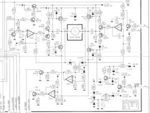

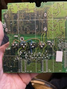

Finally, PCB18 was not findable, I decided to check every connection on the power part of the sledge.
I found several broken links (this is a 4 layers PCB) and put an external link on each (See photos).
After, TM71 ==>OK, TM73 ==>OK, TM27 ==> no error !!!
