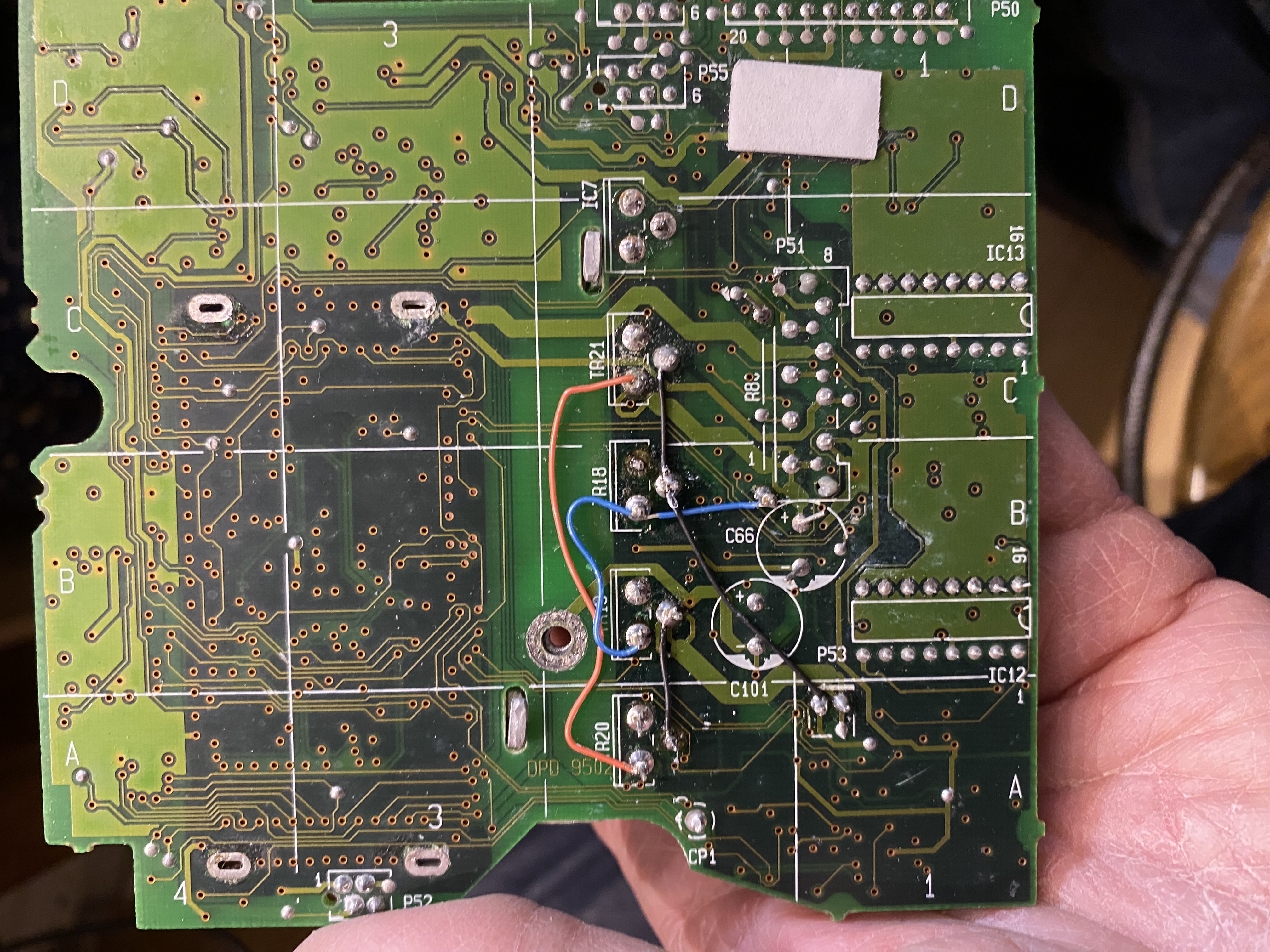

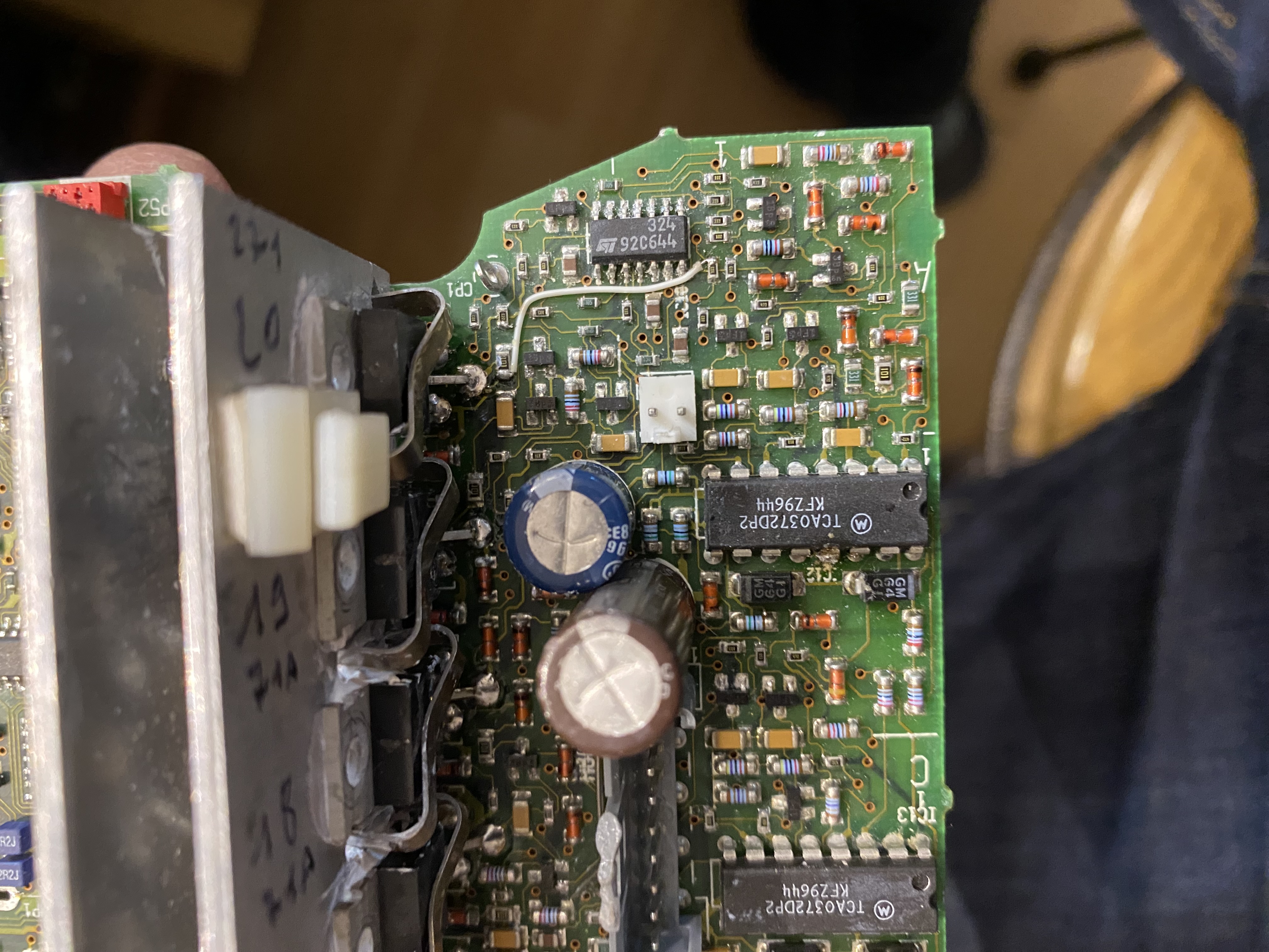

    Finally, PCB18 was not findable, I decided to check every connection on the power part of the sledge.
    I found several broken links (this is a 4 layers PCB) and put an external link on each (See photos).
    After, TM71 ==>OK, TM73 ==>OK, TM27 ==> no error !!!
    That’s it 😉
