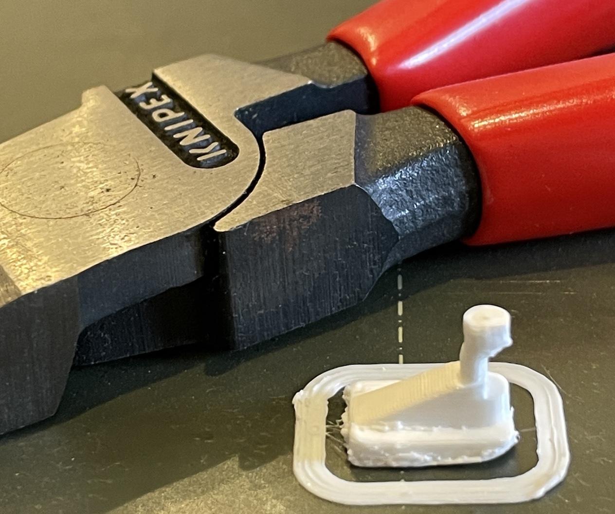

    The small vertical white plastic “pin” has broken on my Beogram 5500 too; I designed and 3D printed something that _should_ work OK, but I have yet to install it. More robust than the original, and weighs virtually nothing.
    Will let you know if it works!
