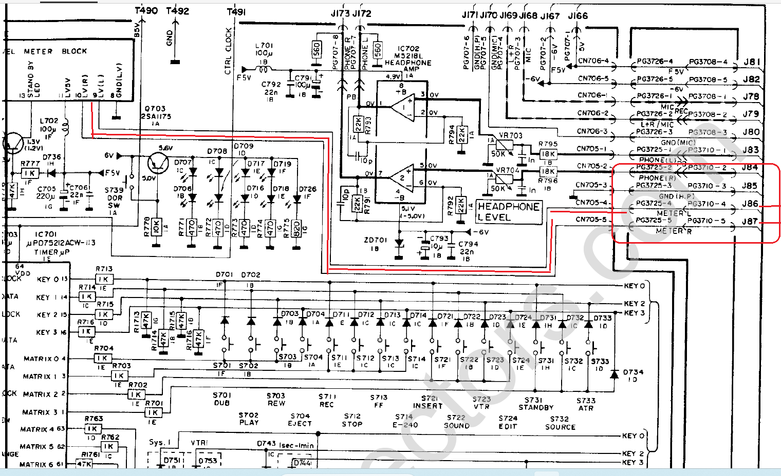

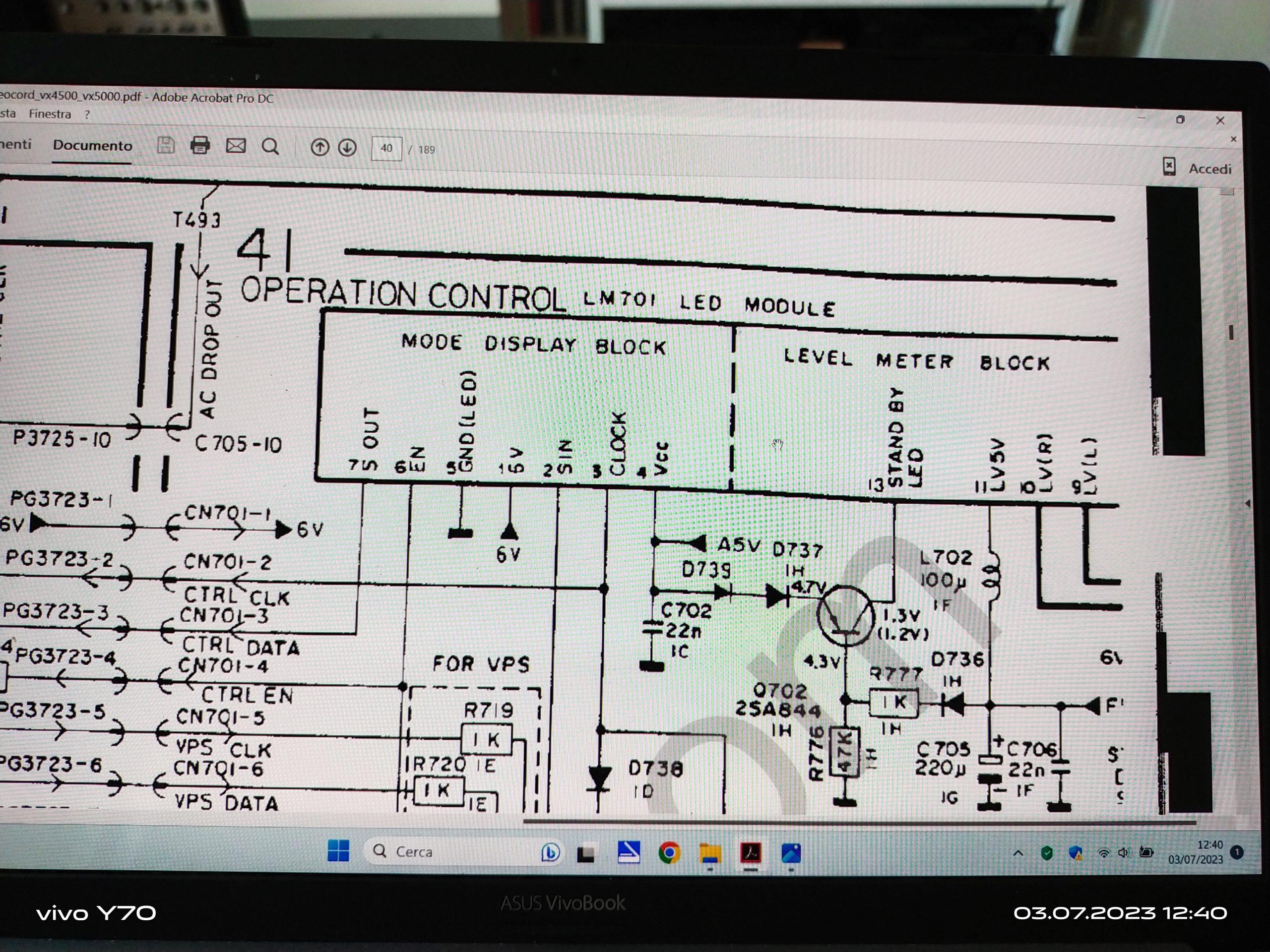

    in reply to: Beocord vx5000 #46468
    gpv
    I can’t figure out where lm 701 Led Module is written on the diagram to locate the interruption of the Vu Meter. can anyone help me figure out where it is?
    Thank you.

    in reply to: Beocord vx5000 #46463
    gpv
    I fixed it, it was a broken trail on the top board isolating a capacitor.
    Last problem are the vu meters only one works, I can’t figure out where they are connected on the schematic.

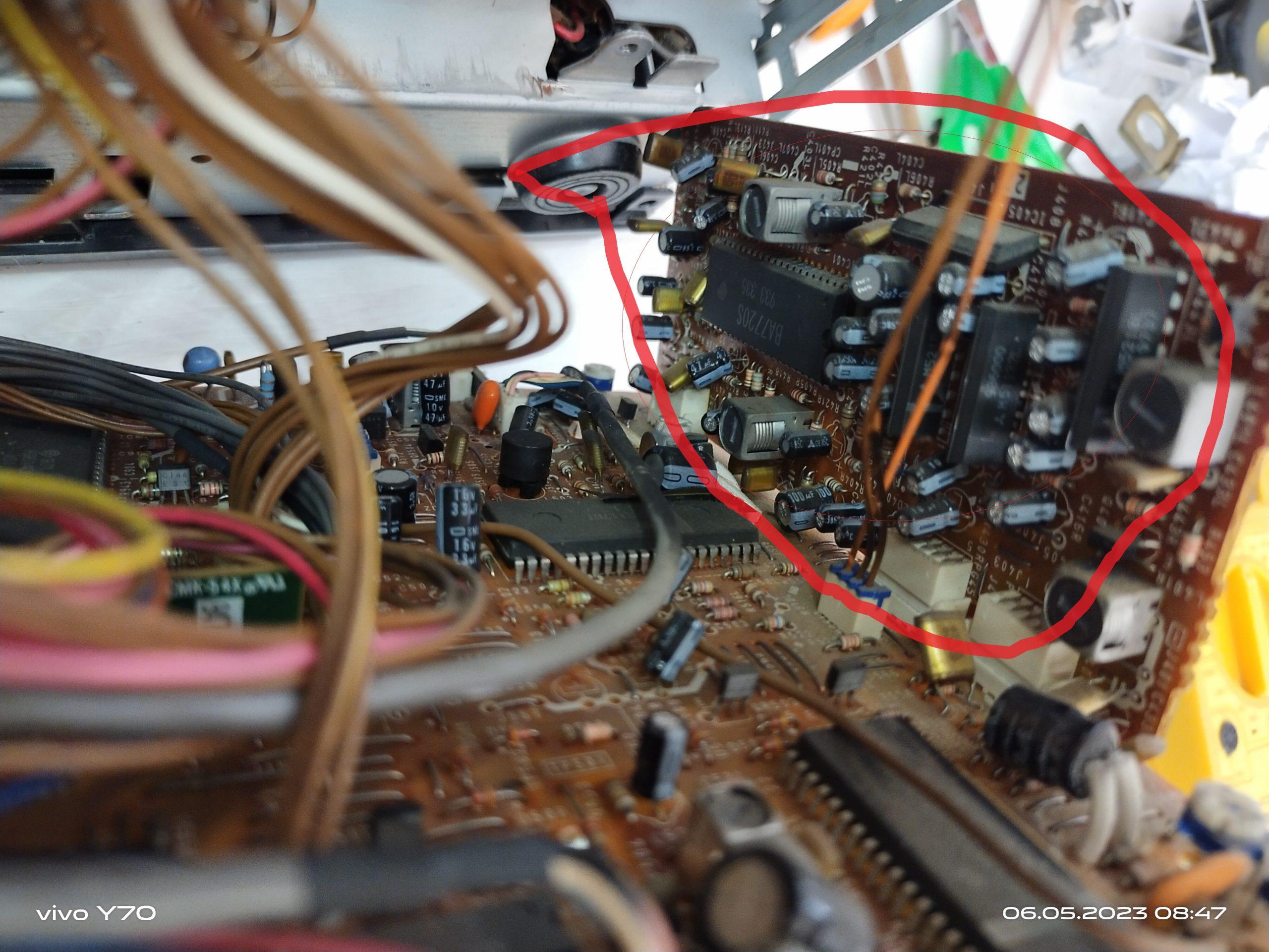

    in reply to: Beocord vx5000 #46460
    gpv
    While playing any cassette, I also tried with a new one. Set to linear Left channel is heard with less bass… . I replaced the capacitors. Would the card you say be the one highlighted in the photo? Do I have to replace the capacitors there too?

    in reply to: Beocord vx5000 #46454
    gpv
    Thank you. The photo is taken before the replacement of the capacitors, now they are all new and 105°.
    While the sound card you mention I haven’t replaced anything yet, now I’ll do it right away

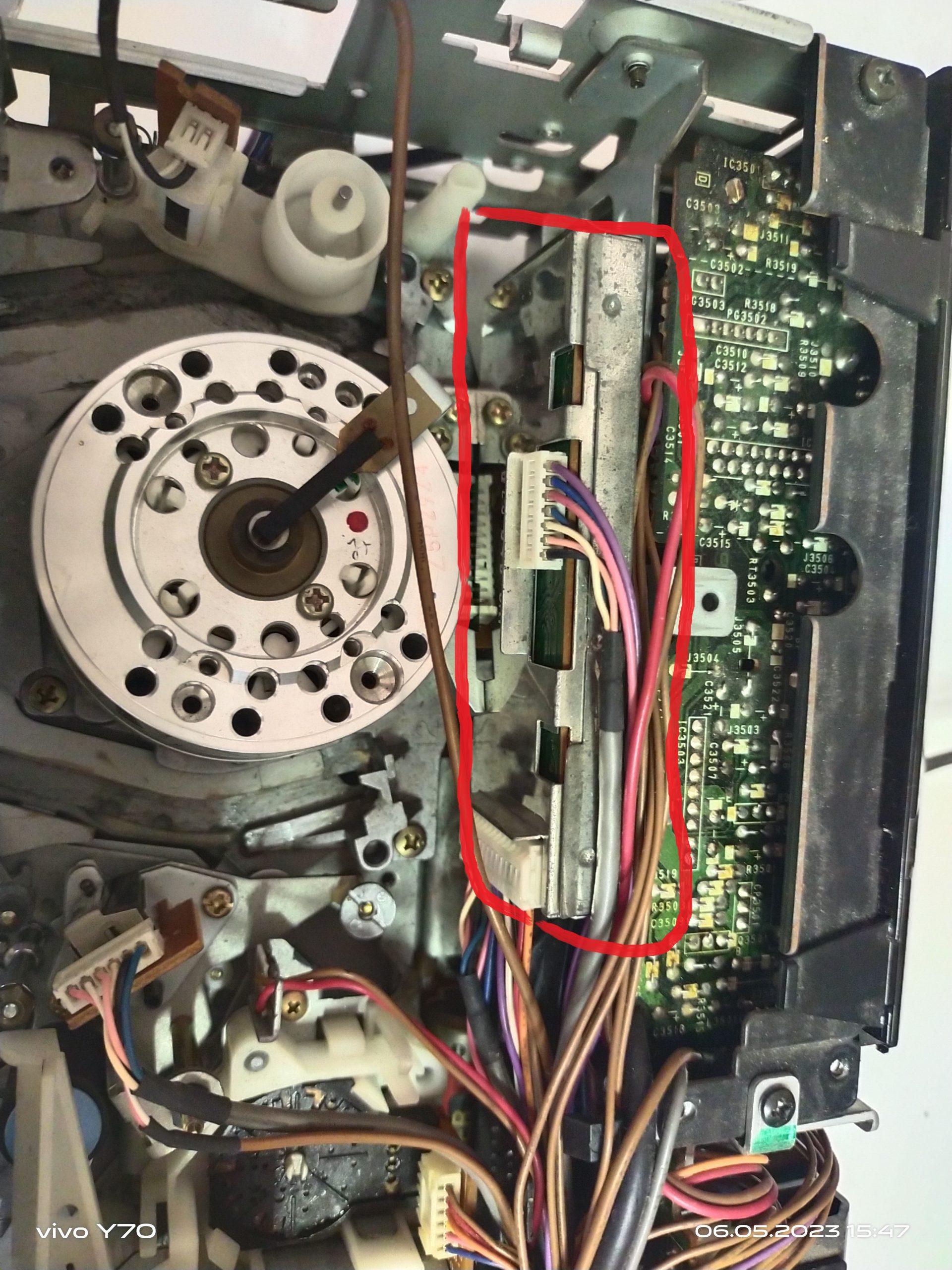

    in reply to: Beocord vx5000 #46452
    gpv
    Thanks for the answer but I changed all the capacitors, maybe the old owner has calibrated it or a capacitor I changed is faulty but which one ……?
    Would this be highlighted in the photo?
