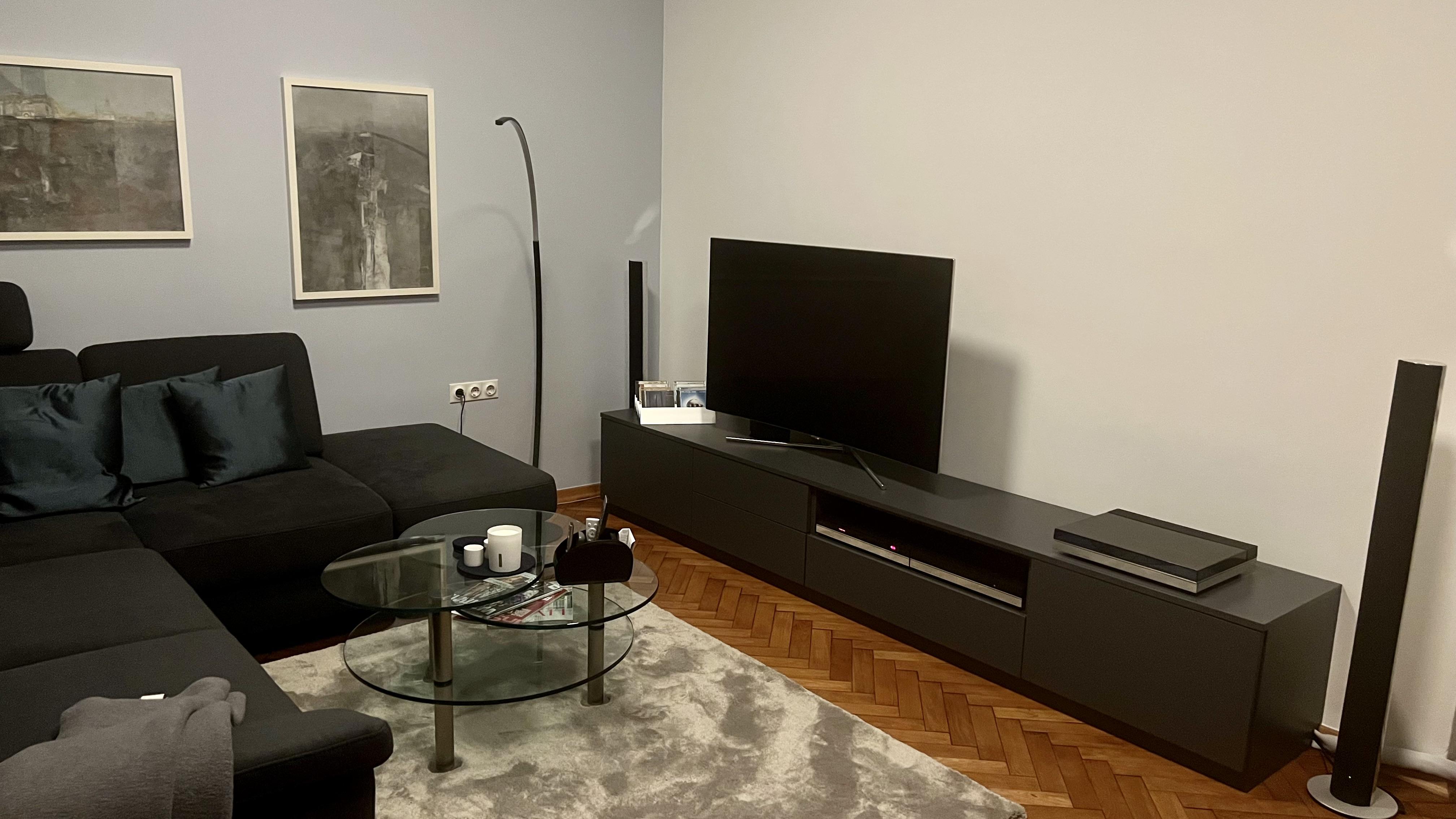

to be honest I’m a bit reluctant to apply changes to the low board, since I’ve just paid ~5.000 EUR for it last week 😉
Also here is a real picture (the others were renderings from the planning stage)
As you can see, the TV actually is placed much more to the right, so the inbuilt center speaker would be way out of center. The Beochord and Beogram CD are at service at my local B&O dealer for the moment to have them perfect for the next 40 years 😉
Thank you for your kind comment on my 7000 system – yes, I guess due to the AV it’s quite unique here in Europe, and my B&O dealer told me he never ever heared from an AV 7000 before. I’m indeed very happy to own such a great piece of craftsmanship, that still fully works.

here’s the situation in our new living room (our daughter moved to another town two years ago so we decided to convert her room to a living room):
Any center speaker below the TV would need to be placed on the bars of the stand – not really a pleasing appearance. I cannot adjust the height of the TV. Placing two speakers on the sides would be pointless, since they would be too close to the side speakers.
Best greetings
